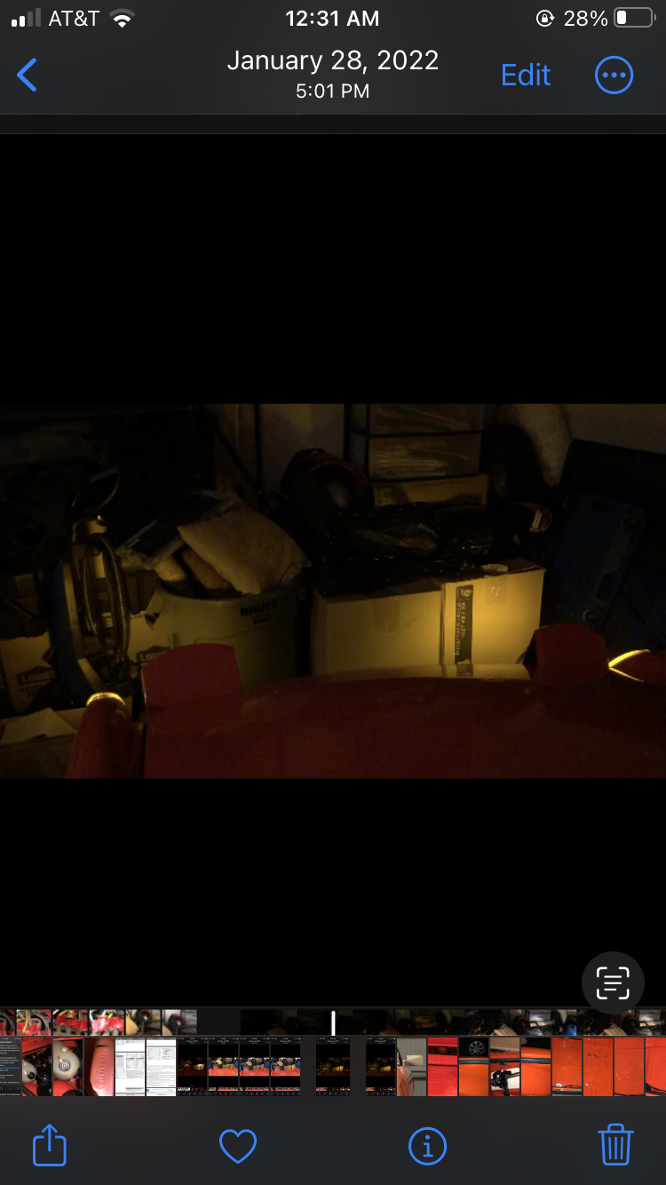

Since taking delivery, I’ve driven the car 376 miles. It’s worth noting the PO had the car worked on by at least 2 shops specializing in Porsches and a restoration shop in the Seattle area.
Here’s a list of things I have fixed (or are still on my “to do” list) on the car since receiving it. I’ll add to it in the next day or so. I will also post photo or video documentation. These are ALL in “as received” condition. I recognize some of this, like the broken gas tank screen, tank debris / sediment and carb inlet screen are not reasonable to expect to be found in a PPI or servicing. But the car would not pass a basic safety inspection as received.
Headlights & high beams malfunctioning; metallic chunk of debris (solder?) lodged in column switch.
RF turn signal inoperative; bucket connector receptacle damaged / broken.
License plate lite inoperative; wiring connected wrong causing short.
Parking brake adjustment improper.
LR brake venting clearance off.
Shifting; worn rear firewall bushing.
Fuel vapors entering cabin & noticeable to both of wife’s 2 adult daughters in walking through the garage; rubber of SS braid hose quickly found to be leaking near shifter (from use of gas with ethanol?) w/$135 Rigid combustible gas “sniffer”.
Carbs: sediment / debris in floats, inlet filter torn causing unacceptable drivability.
Throttle linkage set to achieve WOT; but set incorrectly for idle to be on carb stops, or to avoid excessive side loading of throttle shafts at WOT.
Gas tank: sediment (paint flakes?) & rust inside, outlet sock filter broken. SS braid hose with 2 worm drive hose clamps on tank inlet pipe.
There have been other “disappointments” along the way, but since I don’t have documentation, shall be excluded from this thread.
This’s my most recent discovery earlier today:Attached Image

Headlight /high beam malfunction. Left headlight dim vs right. Switching to high beams and left almost goes out while right got bright:
https://photos.app.goo.gl/4CieKfXcsMFZzxzPA
Photos showing RF turn signal continuously on flash mode, and of back side of broken RF turn signal connector showing missing tab for connection of 3rd wire:

That would make me check grounds first...
Look at bulbs too!
I've had broken filaments that crossed internally drive me bat shit crazy one time.
Might try discoing one side then the other to isolate.
I don't know enough about head light power supply on these yet...
Someone else, please chime in!

Thanks Technicalninja, but this was solved 1-2 yrs ago by removing the metallic chunk.
My purpose in this thread is to share facts from my experience dealing with people in buying this car. Except for the floorpan rust, I’m not seeking advice on these issues. After my floor pan rust discovery earlier today, I can’t hold my tongue any longer. I’m leaving it to everyone to draw their own conclusions
