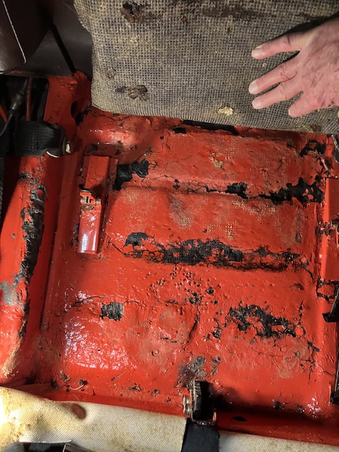

This’s my most recent discovery earlier today:Click to view attachmentClick to view attachmentClick to view attachment
930cabman
All sounds and looks great, until the last photo.
Looks like possible heavy rusting in the floor.

If only the floor pan has rust and the rest is solid and the powertrain is strong, I'd say you still got a good deal considering its a real six. People are asking $80k plus them now.
If the floor pan rust is severe, the PPI surely should have caught that.
If the car makes you sick, sell it. If not just go make it right. After loosing tons of money in my 401k with swings in the market, having to spend a or loose a little on a car seems insignificant to me anymore.

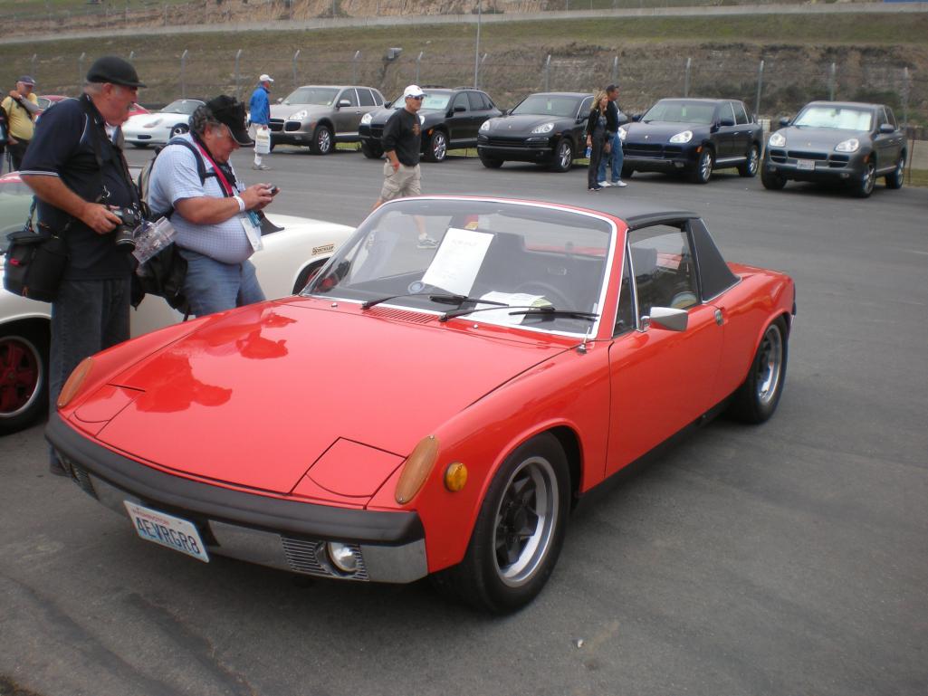

I saw this car at Rennsport IV in 2011. Have a couple photos to post.
lalee914
It was for sale at that time.
lalee914
This photo is from July 2013. Don't know where it was taken.

Sidebar: That looks like @rick918-S 6 in the background, before it became up close and personal with the power pole…

I see that you paid a significant sum for a PPI. The work that was required to repair the car was much more extensive than the PPI would would suggest.

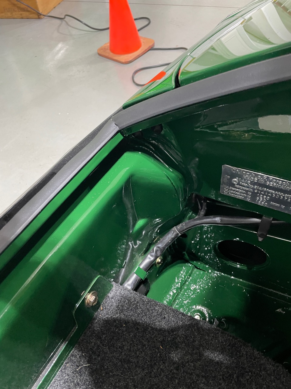

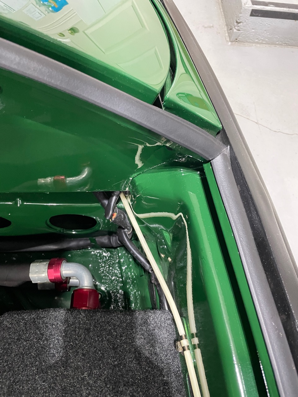

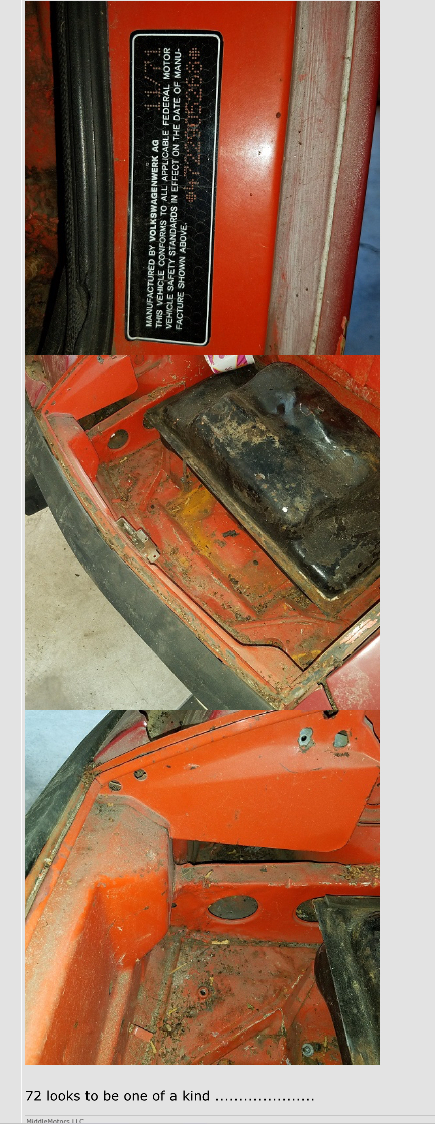

For comparison to PPI and seller’s 914world advertisement description & photos. (Maybe not that unusual or awful for a 50yo 914, but unknown to me before making purchase decision & negotiating a deal. A similar photo was provided by PO, between finalizing the purchase and taking delivery.) Again, please draw your own conclusions.

Are you headed toward VIN swap or is this clipped? I’m not an expert on Model year vs VIN range, could this be a 72’ 914/6 chassis?

I am thinking something similar wouldn’t that be a 75/76 front panel?
Cairo94507
It is very common for these 50+ year old 914's to have had mishaps along the way necessitating panel replacements. Nose and rear panels were pretty common. I have attached 2 photos showing my '71 914-6 nose panel corners for reference for your consideration.
I know my car had a later factory nose replacement panel installed when I bought it. The give away was the round holes in the nose panel were not opened up. I sourced an NOS early panel (mid-year) and we modified that to perfectly match the original '71 (early) panel. I guess what I am saying is not to get to wound up about differences; they can all be addressed to perfectly match what came stock in a '70, or whatever year 914 you have, from the factory. So long as the panel is correctly installed- like factory, I see no harm.
The only issue I would have is if someone tried to pass a car off as having never had work, when it has. That is why I documented the entire process of my build for all to see. beerchug.gif

I think 72’ and 75’ were similar but 75’ would have holes for the energy absorbing struts though I suppose creative metalwork could fill the holes.
