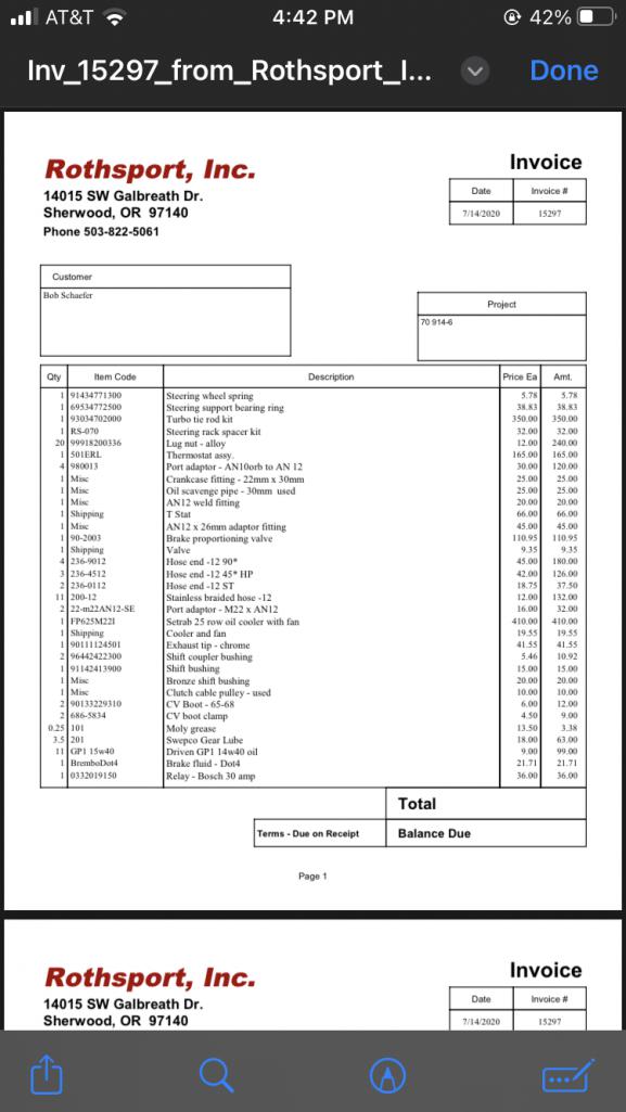

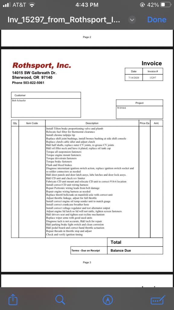

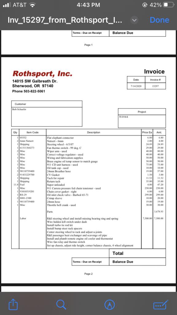

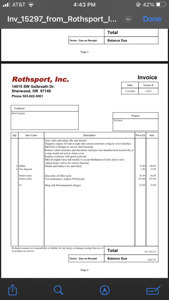

Here’s the resulting invoice I paid for Jeff’s work on the car between 7/1/20 and 10/19/20:
Front yard mechanic

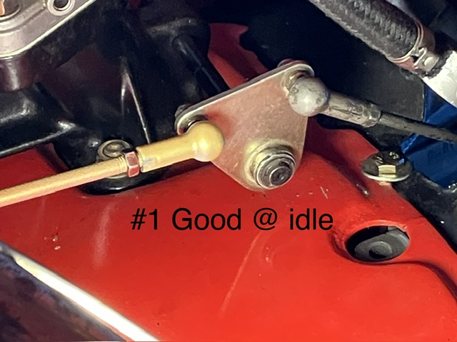

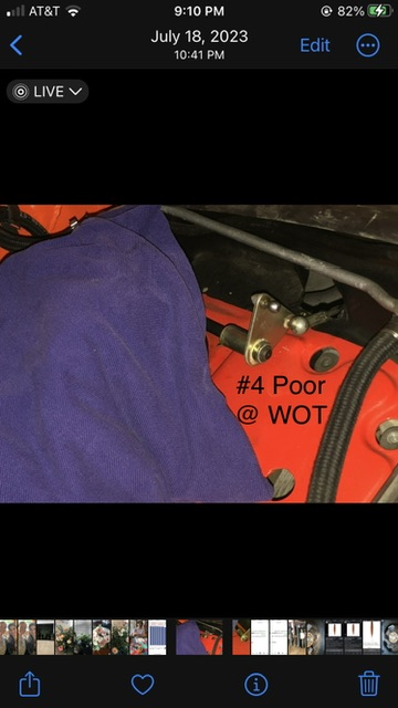

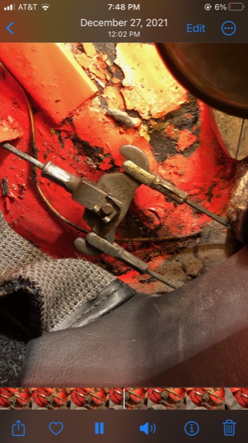

Since taking delivery, I’ve driven the car 376 miles. It’s worth noting the PO had the car worked on by at least 2 shops specializing in Porsches and a restoration shop in the Seattle area.
Here’s a list of things I have fixed (or are still on my “to do” list) on the car since receiving it. I’ll add to it in the next day or so. I will also post photo or video documentation. These are ALL in “as received” condition. I recognize some of this, like the broken gas tank screen, tank debris / sediment and carb inlet screen are not reasonable to expect to be found in a PPI or servicing. But the car would not pass a basic safety inspection as received.

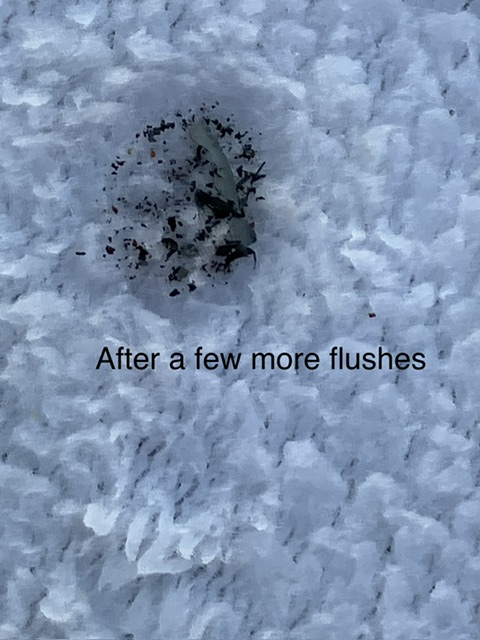

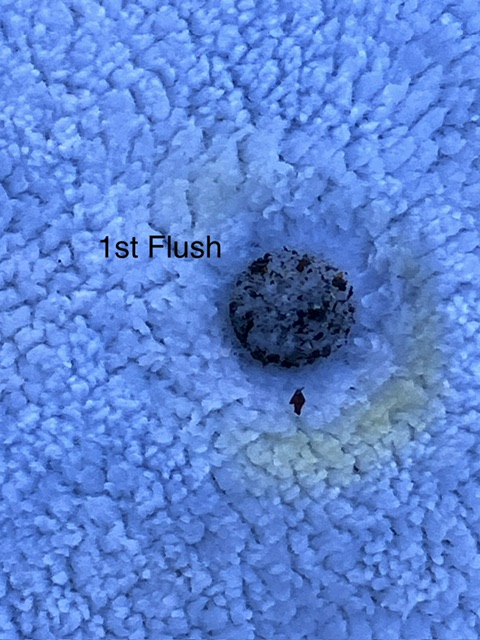

Headlights & high beams malfunctioning; metallic chunk of debris (solder?) lodged in column switch.

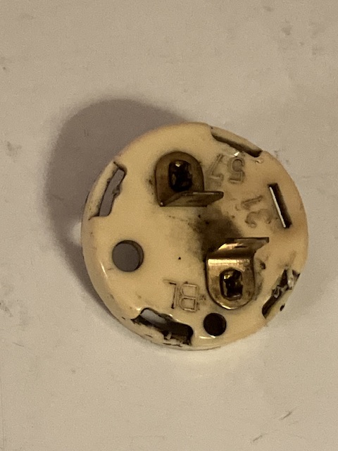

RF turn signal inoperative; bucket connector receptacle damaged / broken.
License plate lite inoperative; wiring connected wrong causing short.

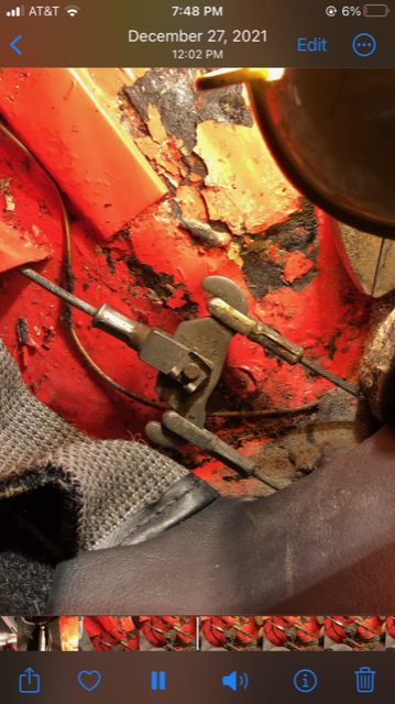

Parking brake adjustment improper.
LR brake venting clearance off.
Shifting; worn rear firewall bushing.

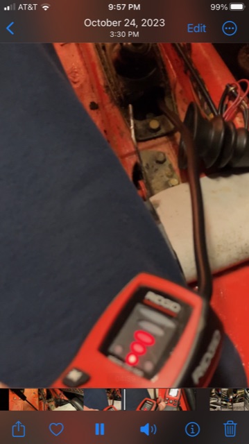

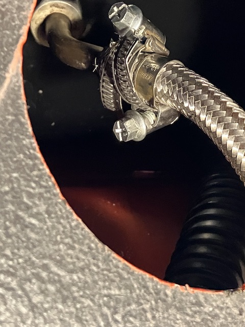

Fuel vapors entering cabin & noticeable to both of wife’s 2 adult daughters in walking through the garage; rubber of SS braid hose quickly found to be leaking near shifter (from use of gas with ethanol?) w/$135 Rigid combustible gas “sniffer”.
Carbs: sediment / debris in floats, inlet filter torn causing unacceptable drivability.

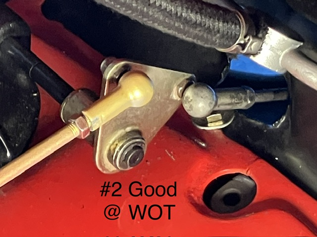

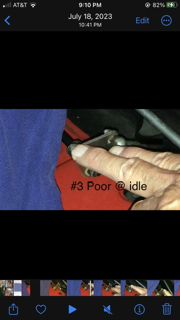

Throttle linkage set to achieve WOT; but set incorrectly for idle to be on carb stops, or to avoid excessive side loading of throttle shafts at WOT.

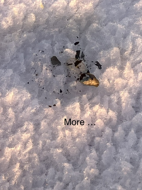

Gas tank: sediment (paint flakes?) & rust inside, outlet sock filter broken. SS braid hose with 2 worm drive hose clamps on tank inlet pipe.
There have been other “disappointments” along the way, but since I don’t have documentation, shall be excluded from this thread.

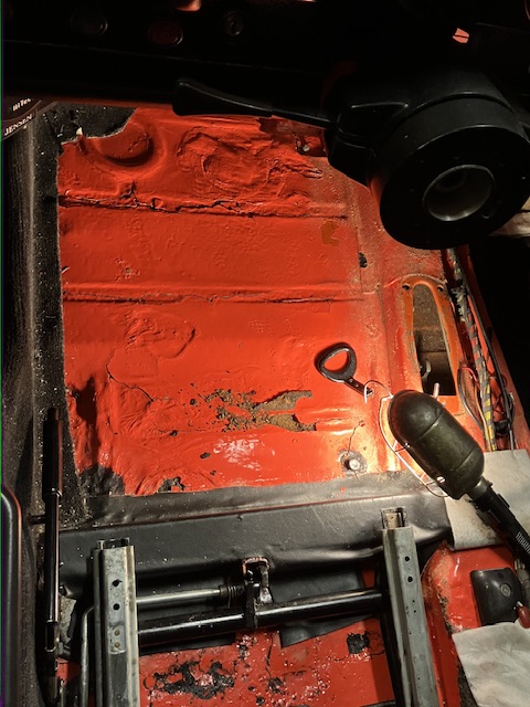

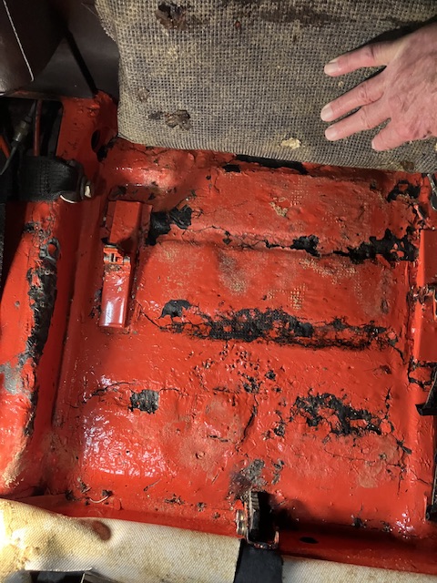

This’s my most recent discovery earlier today:Attached Image
930cabman
post Jan 19 2024, 04:42 PM
Posts: 4,868
Joined: 12-November 20
From: Buffalo
Member No.: 24,877
All sounds and looks great, until the last photo.
Looks like possible heavy rusting in the floor.

Photos showing RF turn signal continuously on flash mode, and of back side of broken RF turn signal connector showing missing tab for connection of 3rd wire:

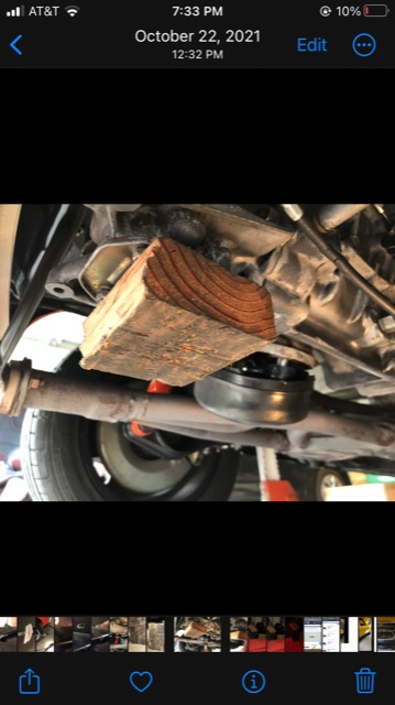

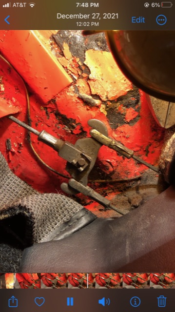

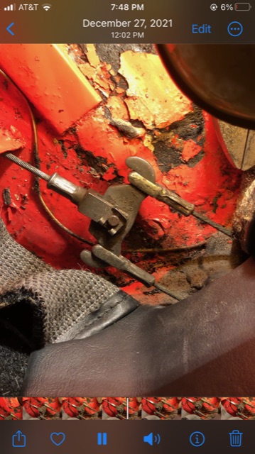

Probably should have posted this first: As received shift cover hanging loose & 2x4 block stuck to 901 transmission:

Worn firewall shift bushing:
https://photos.app.goo.gl/jwwjCStqgKKq9Jqt6

Haven’t figured out how to post videos. So here’s a series of stills taken one click of the parking brake lever at a time as rec’d. Left side moves 3 clicks before right side moves:

SS braid hose attachment to gas tank inlet pipe, sediment flushed from gas tank:

Ridgid combustible gas “sniffer” detecting fuel leak near shifter, and poor throttle geometry creating excessive throttle shaft side loading at WOT:
Rufus
post Jan 19 2024, 08:13 PM
Posts: 314
Joined: 8-April 06
Member No.: 5,840
