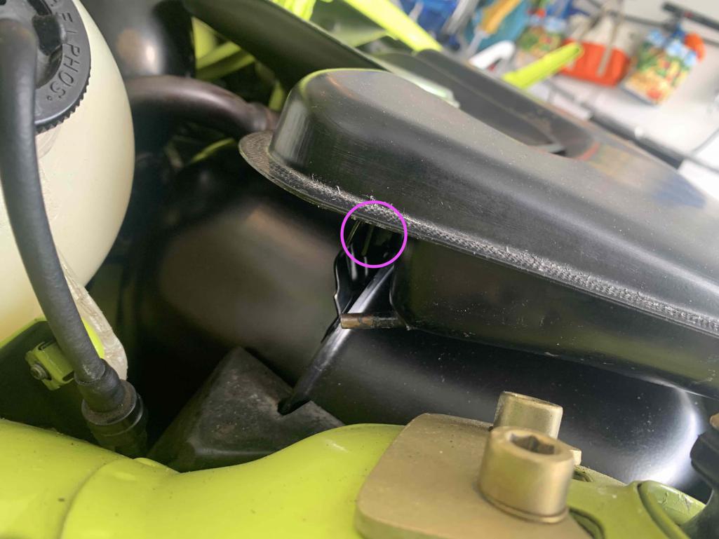

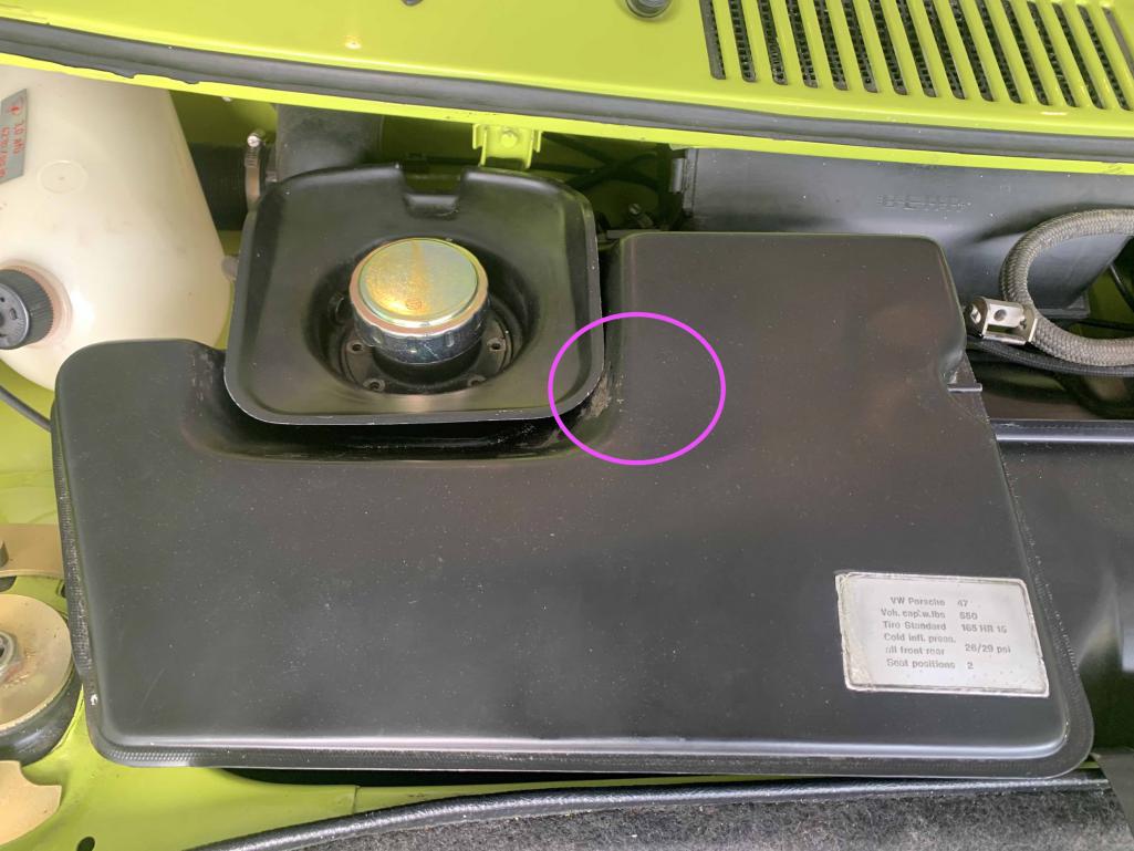

Here's a pic of the fuel filler installed, but the expansion tank just resting unable to get into position to the mount on each side. The circled area is where the contact/interference is occurring.

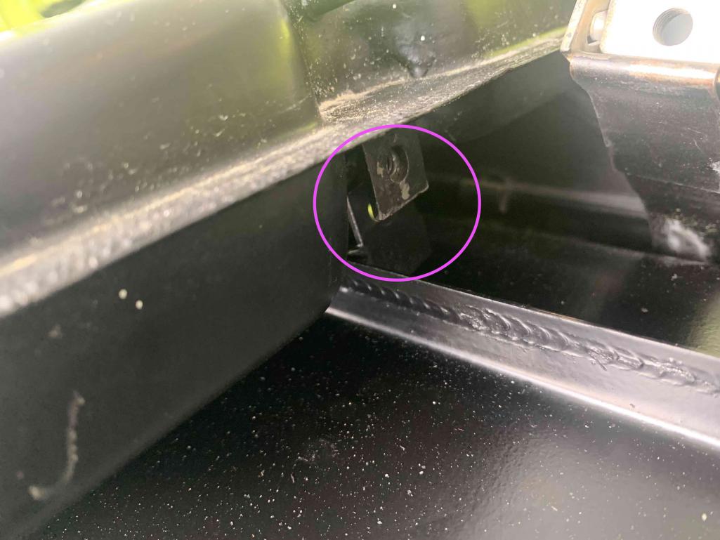

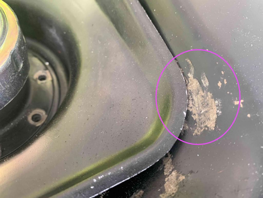

Here's a pic to show the mount not matching up one the PS.
Here's a pic to show the mount not matching up one the DS.

Edited- thought I had found a thread with info other than the one you posted to, but it was for a different issue.
Any chance that your tank is for the later plastic expansion tanks?

Maybe bend the inside bracket out to pull away from the overflow?

QUOTE(BillJ @ May 28 2024, 12:00 PM) *
That may work, but I'm doubtful based on how far they would need to move. I'd guess it's around an inch or so. And I'm not sure the sender top and plug would still line up with the indentation in the bottom of the expansion tank.
And if this is the wrong tank and I need to ship it back, I don't want to modify it at all.

The tab difference is orientation if memory serves. It is rotated 90 degrees. So this is the right tank in theory

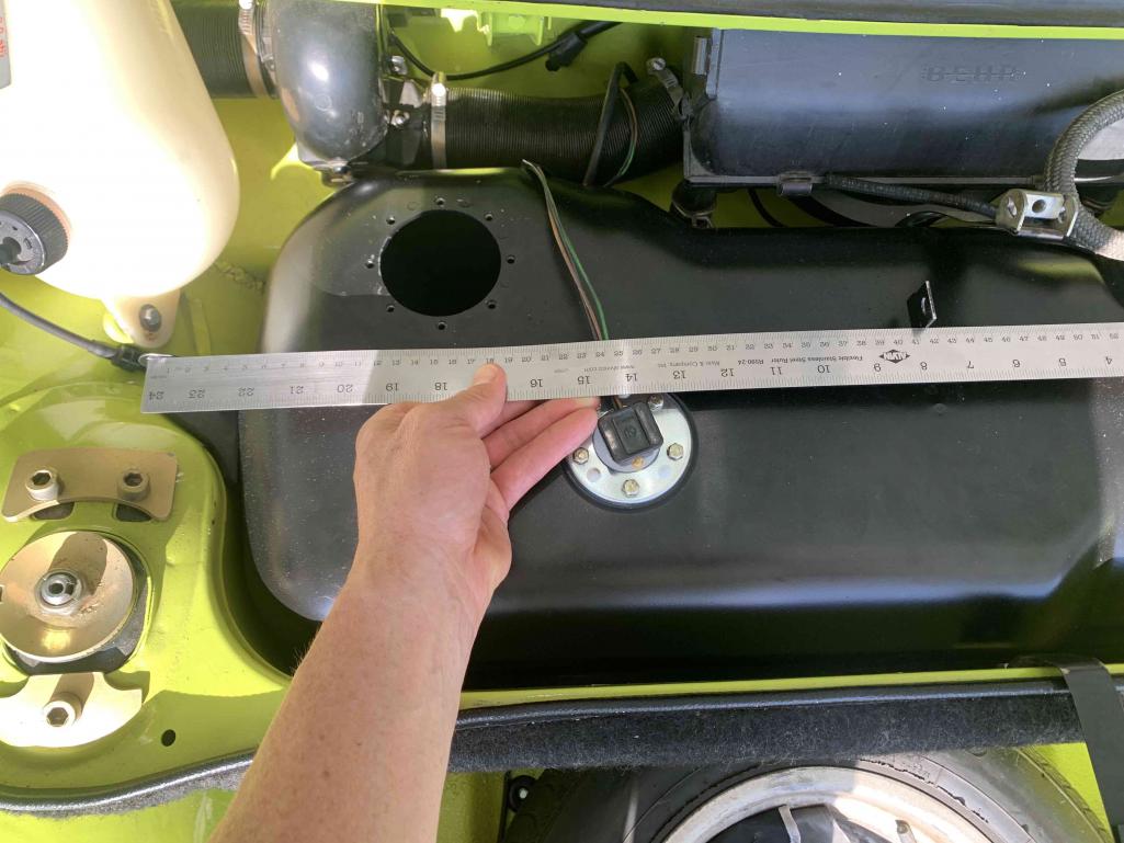

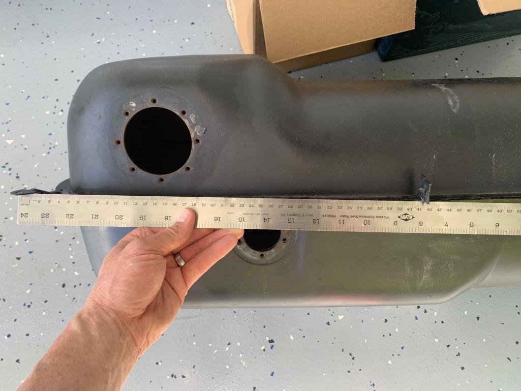

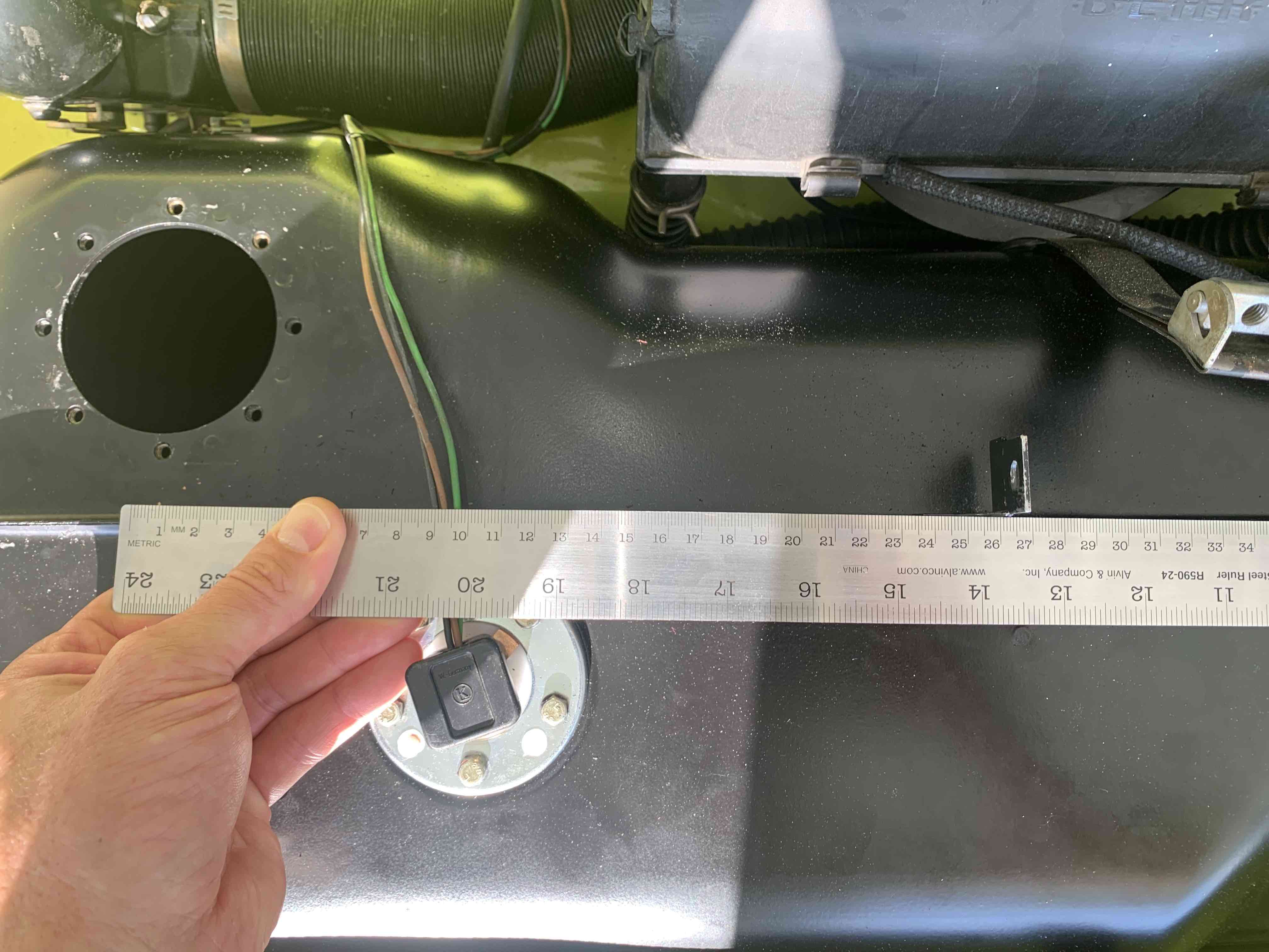

The measurement between the two tabs appears to be the same on the old and new tanks (approx. 41 mm).
OLD TANK:
NEW TANK:
DC_neun_vierzehn
post May 29 2024, 07:54 AM
Posts: 680
Joined: 16-November 20
From: Coastal Delaware
Member No.: 24,893
However, the measurements do not match re distance from the center of the filler hole to the drivers side tab for the expansion tank (which is the reason I cannot get the expansion tank of after bolting down the fuel filler piece). The driver side tab is 10 mm further toward the driver side as you can see in the pics below (old tank is approx. 27.5 mm and the new tank is approx. 26.5 mm).
OLD TANK:
NEW TANK:
BillC
post May 29 2024, 08:11 AM
Posts: 753
Joined: 24-April 15
From: Silver Spring, MD
Member No.: 18,667
I think you found the problem -- the fuel filler hole seems to be in the wrong place.
Sounds like a call to AA is in order.

Bending isn't going to cover 10mm lol!!! Yeah you should call George.
