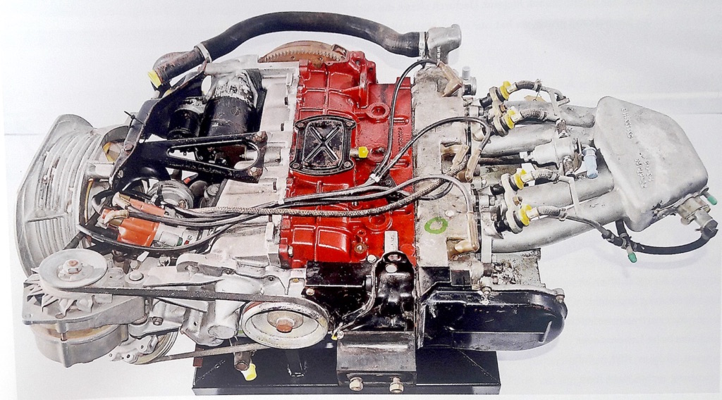

(finally found a decent image of one).
this would have been in the replacement for the 914.
intended for production in 1972/73.
its the engine (or one of the versions) for the aborted VW EA266 -Porsche Project 1966.
came in 3 cylinder and 4 cylinder laid flat version for what would have replaced the beetle. with power range from 50hp up to 110 hp. the 4 cylinder 914 would have got the 110 hp version along with a souped up version of the VW saloon. basically a Golf GTI before the GTI.
not sure what version of fuel injection this would have got. its hard to tell.
but it dates from 1967-1972 development period.
all under engineering direction of f. piech.
the idea was a modular engine family.
f piech was one hell of a evil genius.
but this project blew up in his face big time.
porsche were developing flat V versions of this for their own cars.
a flat 6 derived from the VW flat inline 3. and a flat V8 derived from the inline 4.
but it all got detonated.
so they battled on with the tail end of the aircooled cars while VW under a lot of pressure very quickly developed up the Golf and other water cooleds and cut Porsche adrift, terminating their development contract which had been in place since the end of WW2.
