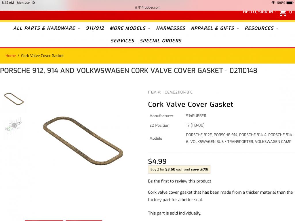

Give these a try, working for me. There a bit thicker. Installed clean, and dry, no sealers.
914Rubber.com
