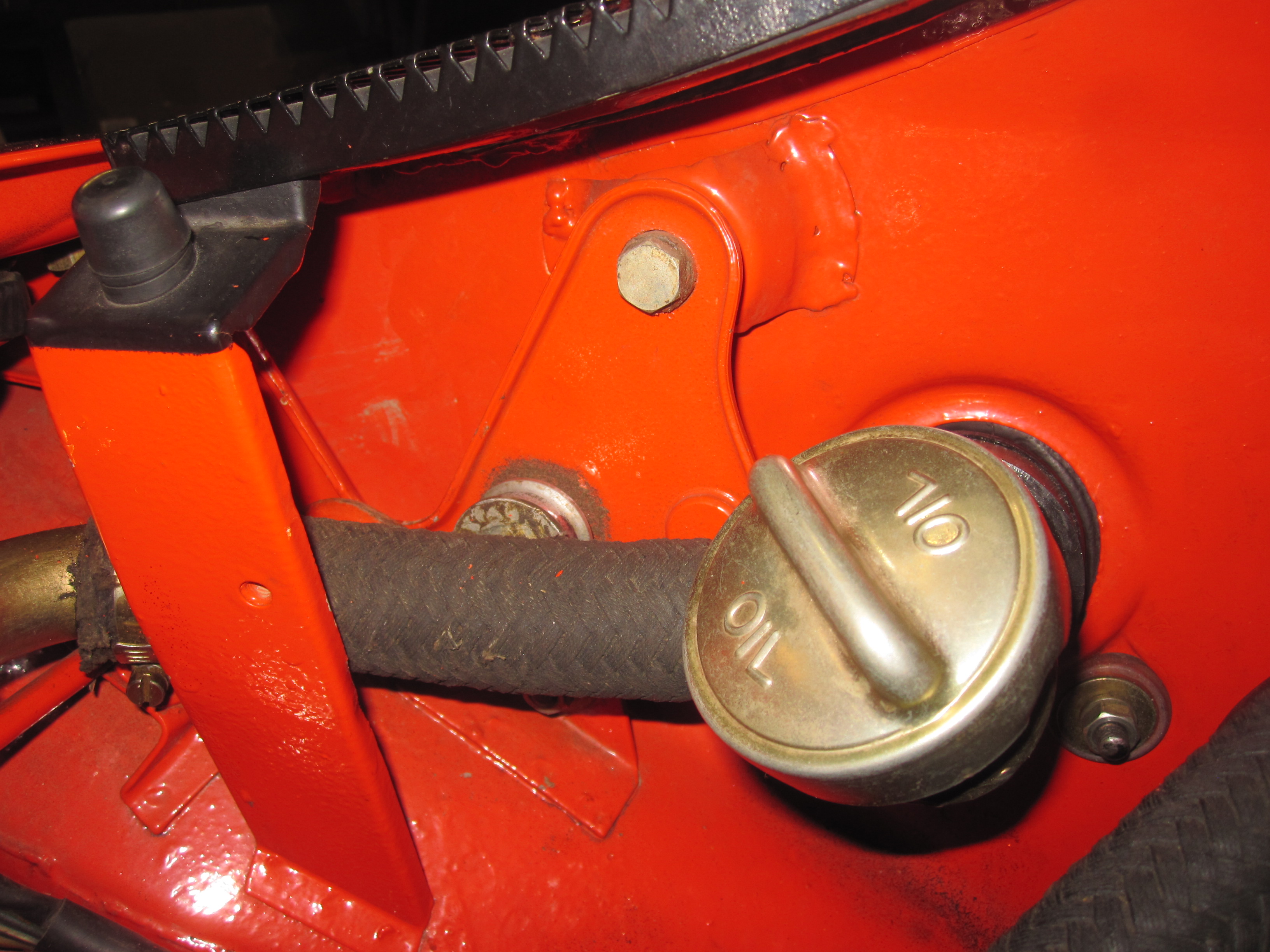

In parts “bin”…….could well be for a six but can’t put my finger on it.
Any ideas?

A fitzer valve? (IMG:style_emoticons/default/biggrin.gif) . Looks like something to do with the crankcase vent

the short length hose attaches to the oil filler neck.
the metal elbow goes around behind the support for the engine lid stops.
a long piece of the same hose extends to the T on the rear of the OE air filter

a long piece of the same hose extends to the oval cover on the center of the engine
near the flywheel.
yep, just checked mine

Those are the correct OE hose clamps too (IMG:style_emoticons/default/smile.gif)

Rory is the man. They are missing on so many 6s, nice to see your car still has this on it.

No worries…..y’all cleared up my question. And funny thing your car is just like my original 6. Bought in 81 but unfortunately sold in 89. That detail photo gave me exactly what I needed……Thanks

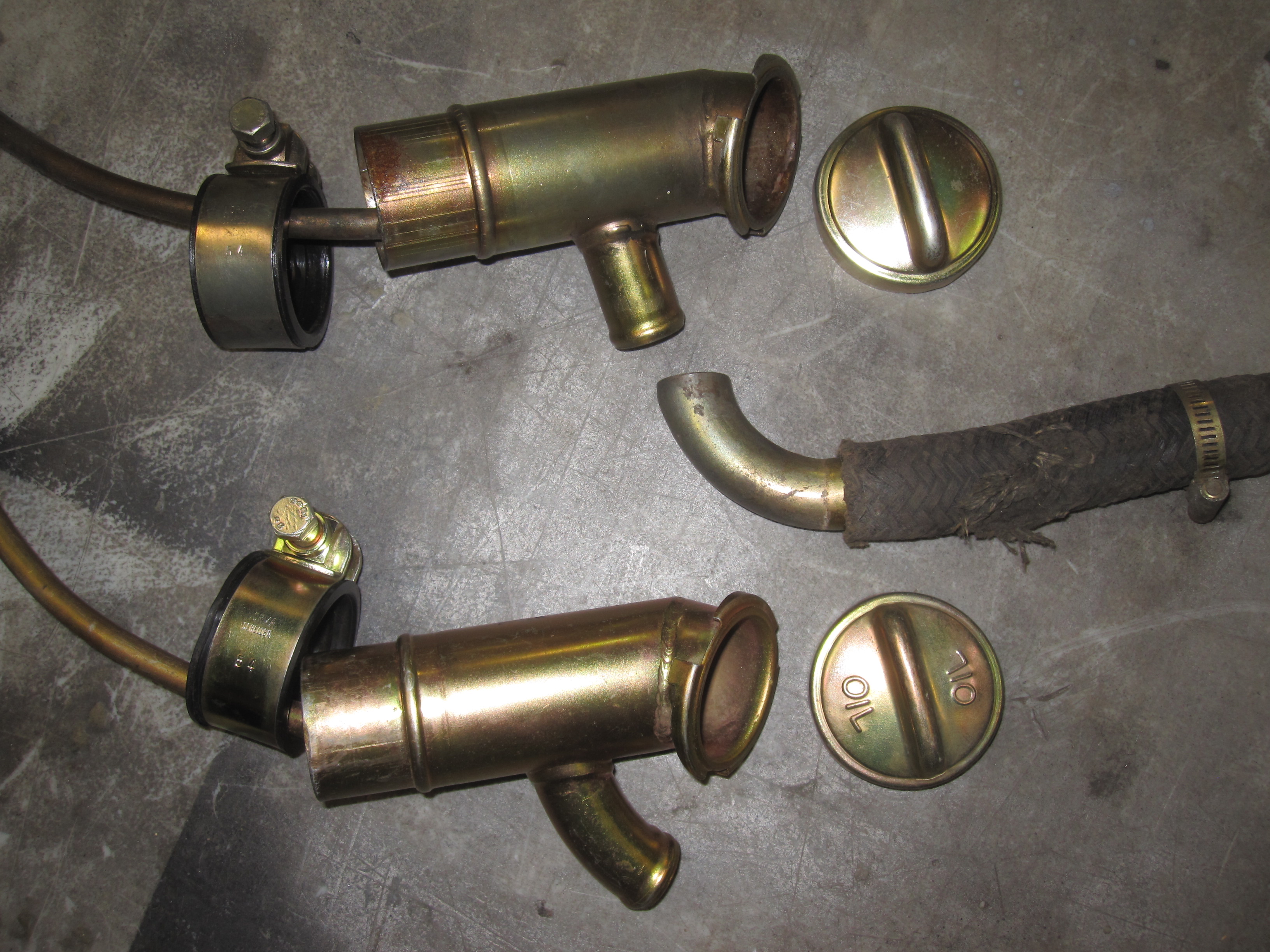

Thread update.
The elbow in question was likely an early 914 6 feature.
I was just going through parts and discovered there were two versions of the oil filler
neck.
This second version eliminates the seperate elbow by aiming its breather nipple
toward its destination. The breather hose is now a single long piece.
The short hose, 90degree tube and two clamps are eliminated.
As a bonus, the hose no longer gets rubbed on by the rear lid torsion bar roller.
