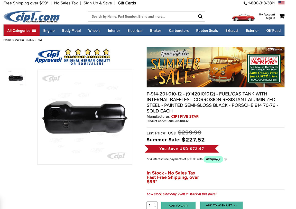

It would seen to me that you can get a new tank for $227. All in no tax no shipping.
The cost of solvent is several $, Not a big deal to install the tank on no fire risk and no solvent to breath. You can sell the old tank for a few $ later
Best Bob B

I bought one from "parts geek" for my 75 BEFORE I even looked at the one I have.
Was about 250 all in...
Stupid cheap IMO.
If you tank is nice inside and just needs a little cleaning, I'd try what I suggested.
