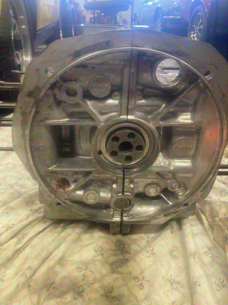

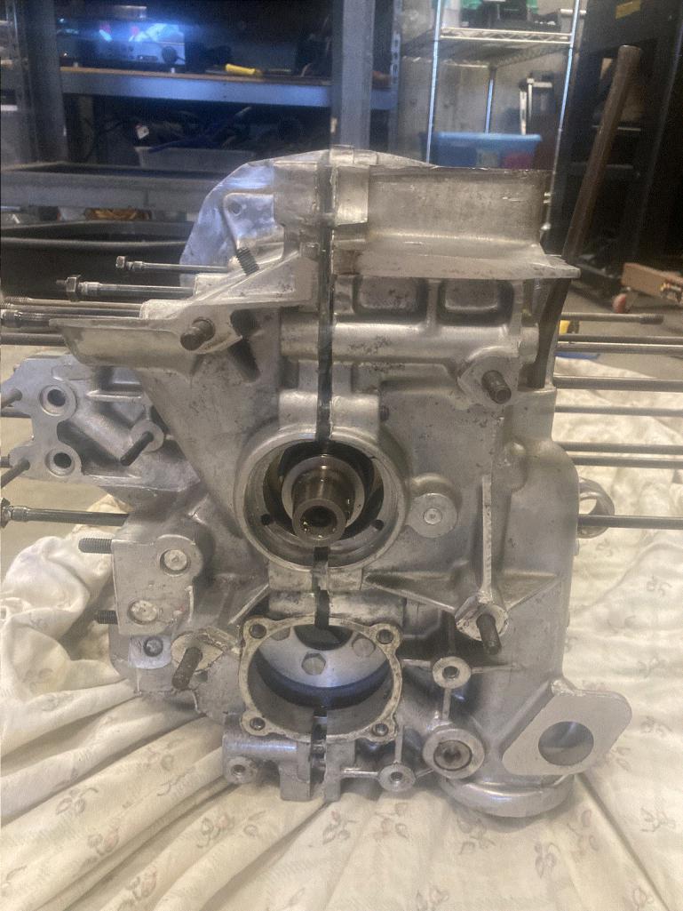

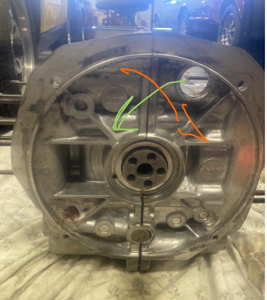

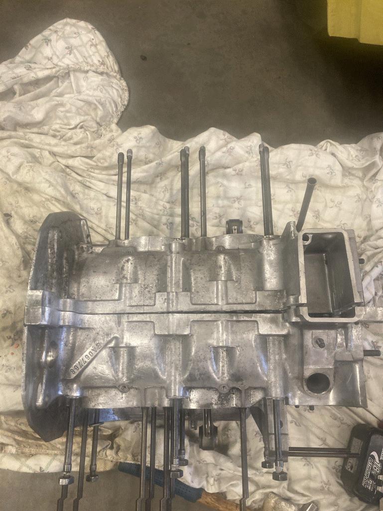

Here are picts of my almost split case. It seems to be hanging up on the top of the flywheel side just on one side. Wonder if a dowel got wedged in there or maybe the plastic reinforcements on the 6 through bolts are somehow hanging it up. Maybe I should push it back together and start again to see it will come apart when pulled straight off instead of wiggling it back and forth?
Attached Image Attached ImageAttached ImageAttached Image Attached Image

You guys are amazing and I'm very thankful that you are willing to share your knowledge. It's fun to learn from you!
BTW - There were 3 shims on the crankshaft for end play. Without them, the end play was .060". Also, the felt washer was missing. Hope that comes in the gasket set.

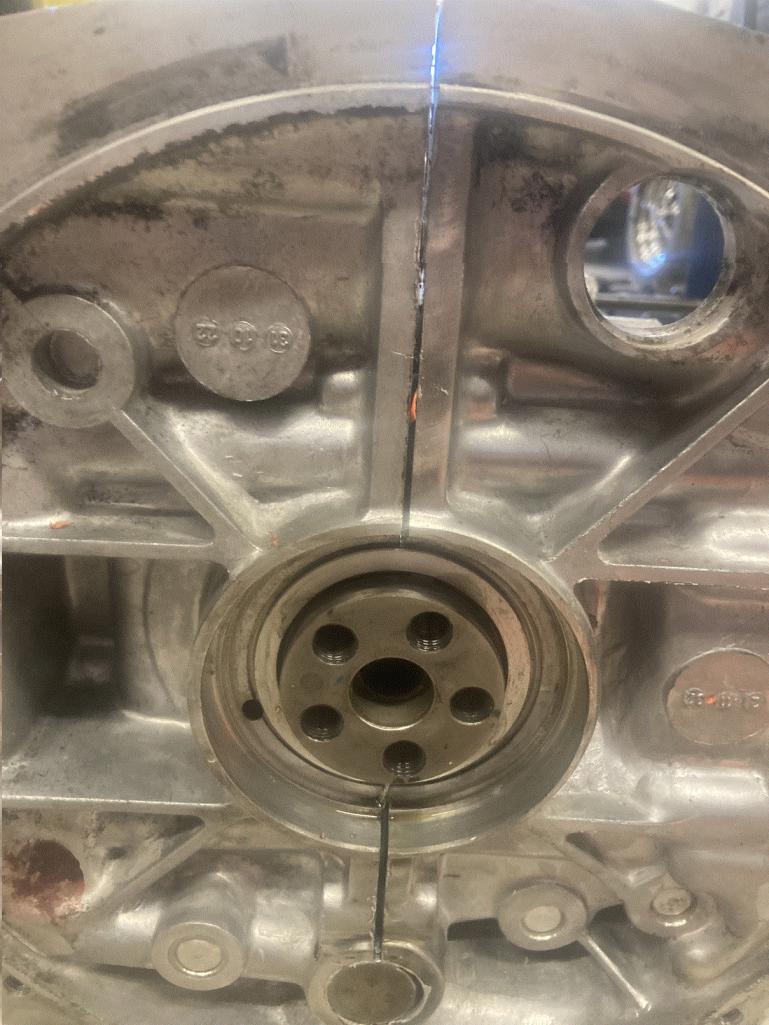

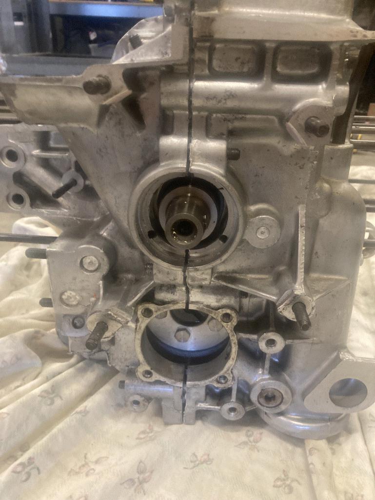

You didn’t show photo of the oil pump pick up tube fastener.
I think you probably got it in order to get it split that far. But double check - count them.
Yes - case can bind and sometimes go have to go back and close it up and then be more careful to split it evenly end to end, just a little at a time.
You can also use a block of wood and a hammer to knock on the flywheel end ribs, back and forth, side to side to help open up the top side, flywheel end but as shown with it that far open at the fan, it’s probably binding.
Nothing brutal, . . . Finesse it more than force it.
