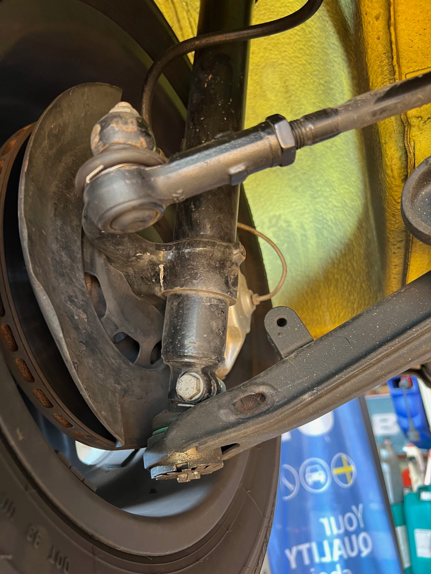

With the 5 lug wheel upgrade, you probably have 911 A-arms which is why you might have the tab and not the actual sway bar. Like others have stated, you might have larger torsion bars and rear springs resulting in the stiffer ride you seek to soften up.
Adding a stock swaybar is going to further stiffen the ride due to the non adjustable drop links, sitting, the stock sway is under a bit of torsion, which will slightly add to the stiffness of your ride.
Be sure to consider all these aspects when formulating a plan of attack, as for wheels and tires, pending pictures of your car, id leave them alone, concentrate on spring rates.

While the car was on the lift last week for something else, I did take a picture of the front suspension setup:

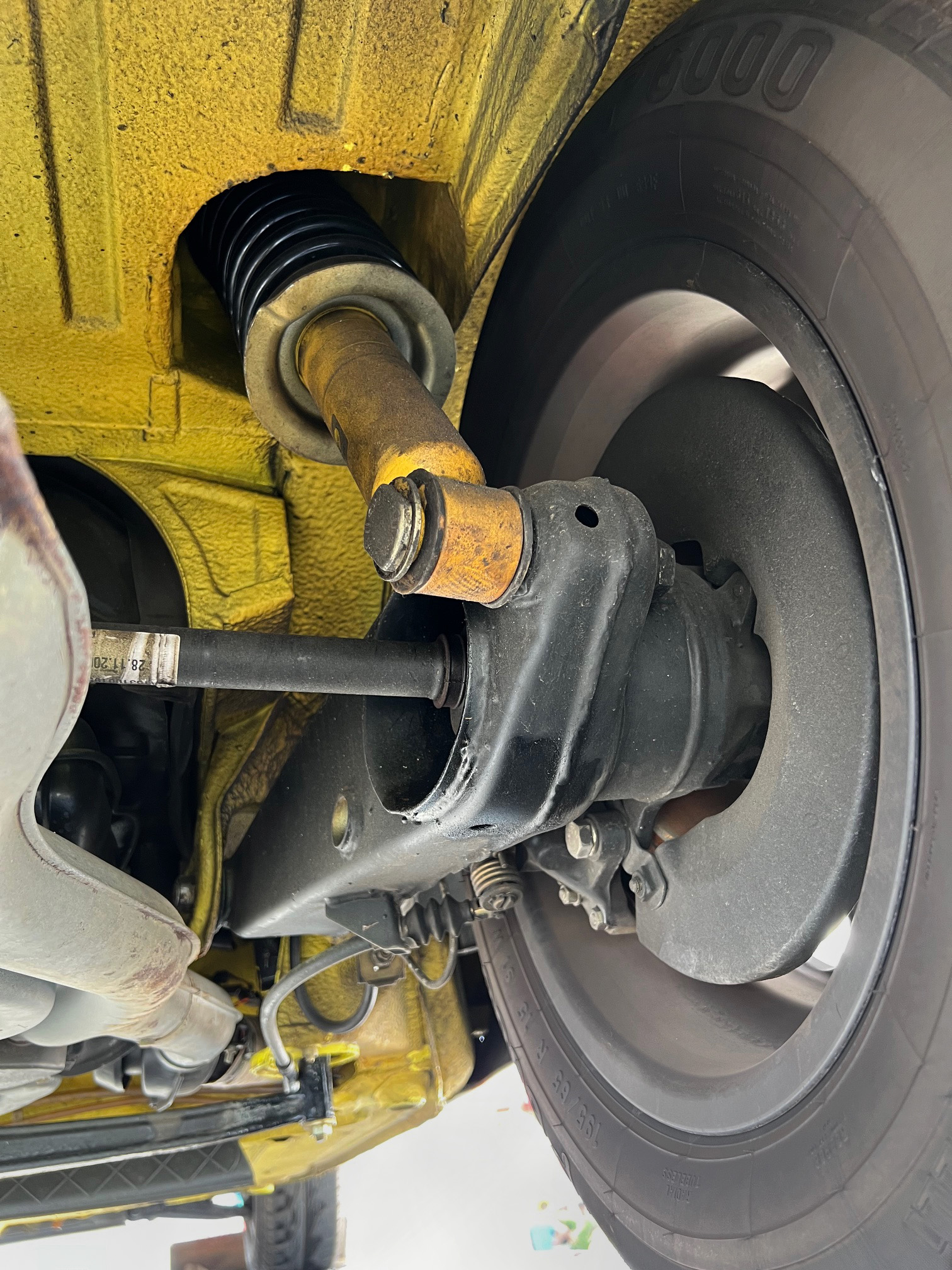

Unfortunately I did not take any pictures of the rear suspension at the time. I will do some more picture documentation soon.

Here is an image of the rear suspension.

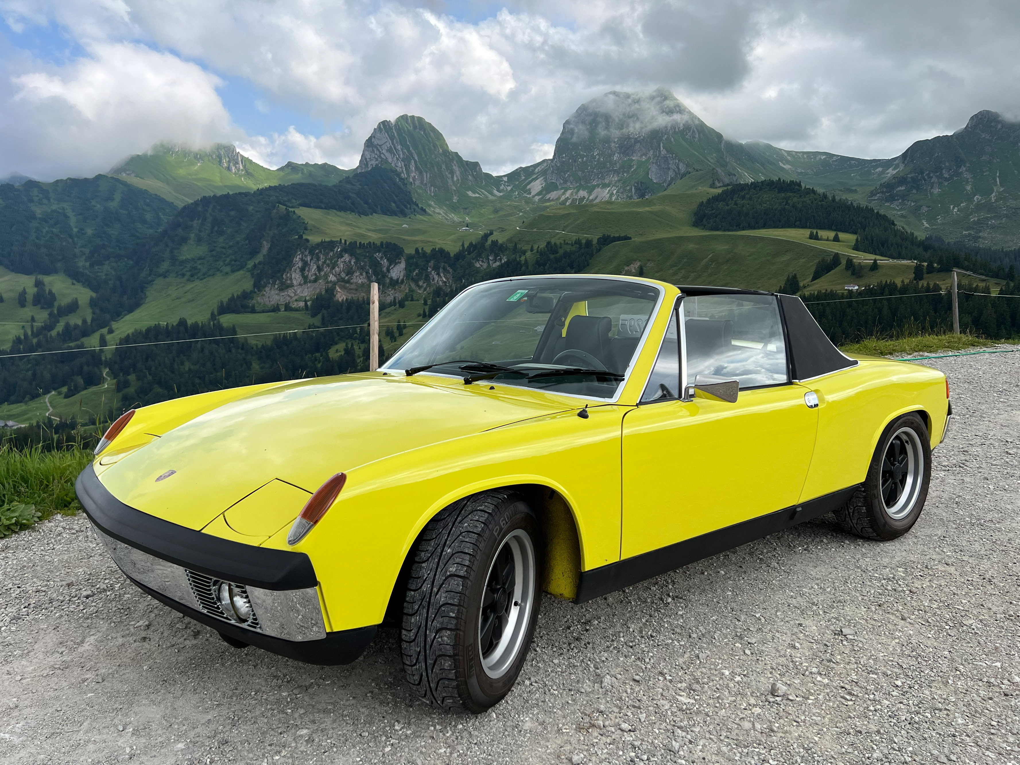

Below is a higher resolution image of the car (same used for the avatar), taken at the top of a small mountain pass on the on the trip back home from the guy I bought it from.
