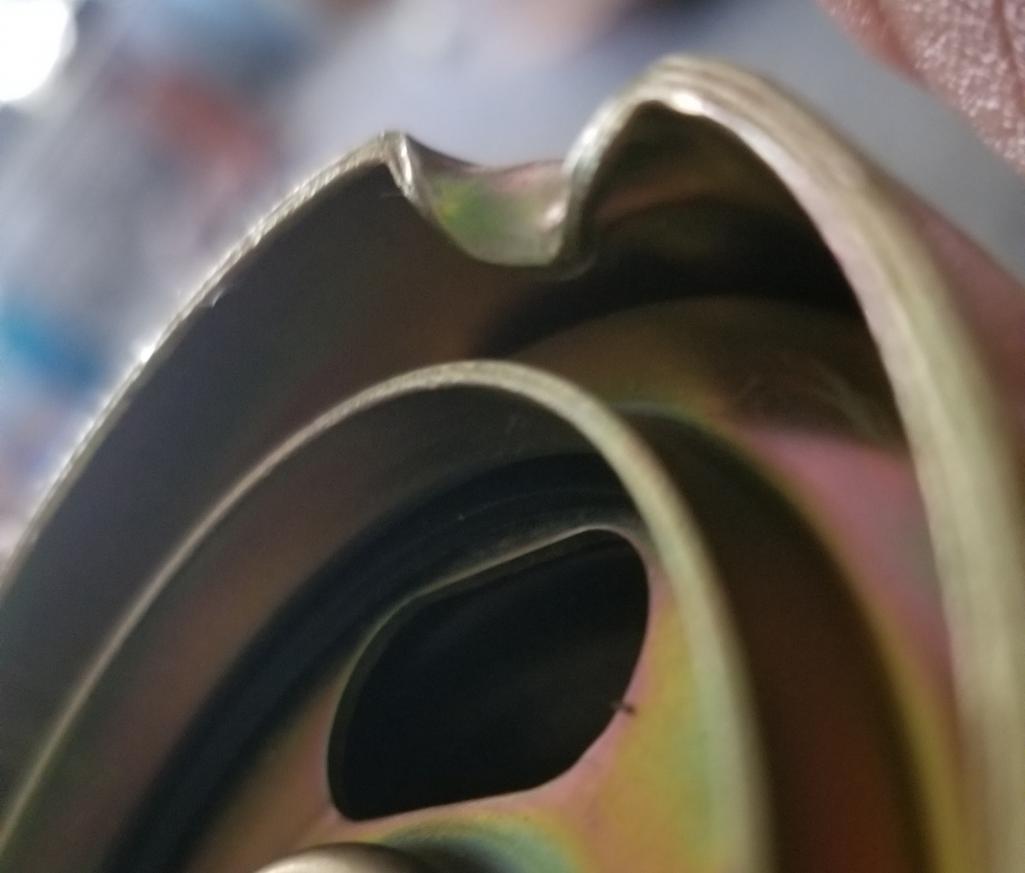

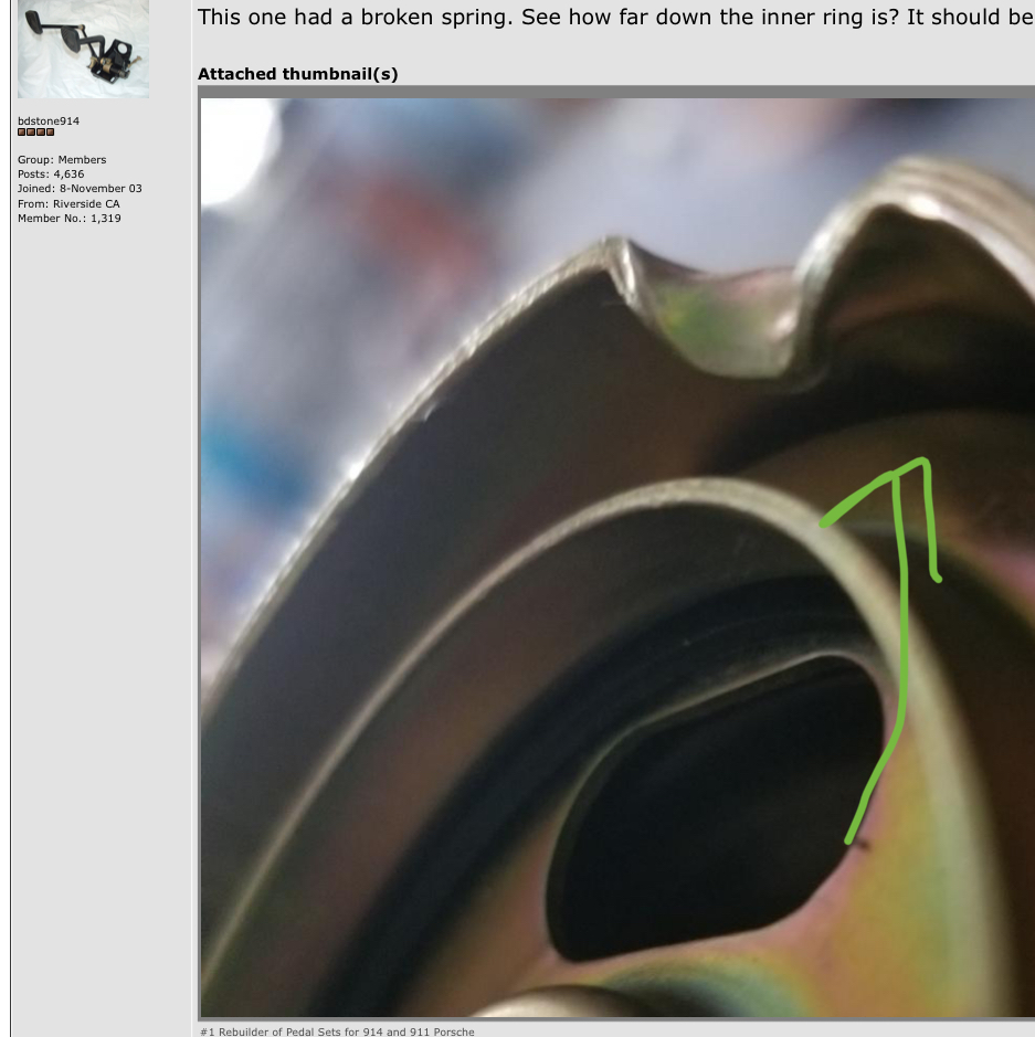

bdstone914
post Aug 5 2024, 05:09 PM
bdstone914
Posts: 5,307
Joined: 8-November 03
From: Riverside CA
Member No.: 1,319
This one had a broken spring. See how far down the inner ring is? It should be all the way up.
Mike1981
post Aug 5 2024, 05:19 PM
Posts: 281
Joined: 21-July 14
From: Phoenix
Member No.: 17,663
QUOTE(bdstone914 @ Aug 5 2024, 07:09 PM) *
oh ok thanks

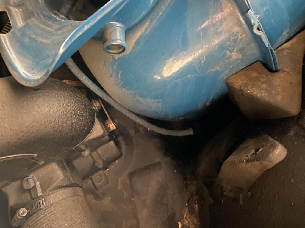

Hello Everyone.
I ordered a new gasket, installed it and it did not solve the gas smell problem.
I then noticed the overflow hose is disconnected. I think the gas is being sloshed upwards and drains through this hose onto the car.
Should this be connected to something?
Also there looks to be a breather and this is not capped off either.
Mike1981
post Sep 1 2024, 11:23 AM
Posts: 281
Joined: 21-July 14
From: Phoenix
Member No.: 17,663
Hello Everyone.
I purchased a new gasket...no improvement.
I did notice this drain hose which is dumping the sloshed fuel onto my car. should this be connected or capped off?

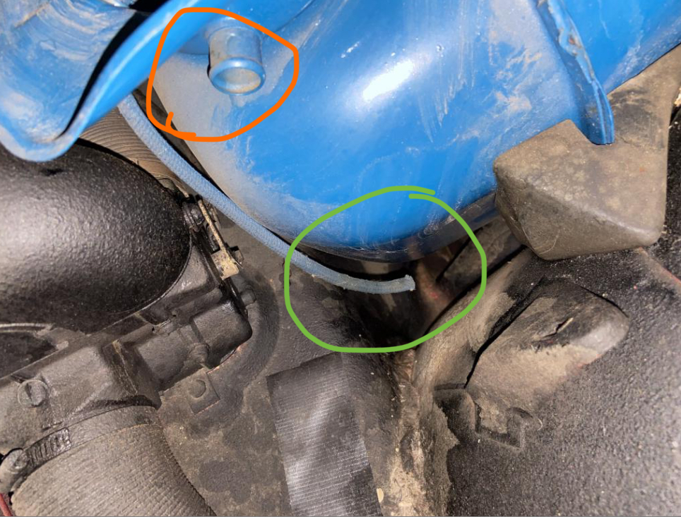

Superhawk996
post Sep 1 2024, 11:24 AM
Posts: 7,845
Joined: 25-August 18
From: Woods of N. Idaho
Member No.: 22,428
First - stop overfilling the tank
Second route hoses properly.
Orange is overflow - route out holes below tank to ground
Green is supposed to go to the vapor expansion tank and then to charcoal canister
Looking at your blue tank I can only assume that you no longer have the expansion tank, charcoal canister, and associated plumbing back to the engine.
Route green line same as orange if need be. You will have vapor / smell until you route to a charcoal canister which gets purged at each drive. Attached Image
Place WTB ad on classified forum - plenty of caps floating around out there.
Mike1981
post Sep 1 2024, 11:29 AM
Posts: 281
Joined: 21-July 14
From: Phoenix
Member No.: 17,663
QUOTE(Superhawk996 @ Sep 1 2024, 01:24 PM) *
Route green line same as orange if need be. You will have vapor / smell until you route to the charcoal canister. Attached Image
Thanks Superhawk for the advice.
Yes charcoal canister is long gone. So Tie both together and route down to hole below tank?
Superhawk996
post Sep 1 2024, 11:43 AM
Posts: 7,845
Member No.: 22,428
I wouldn’t worry about trying to tie together into a common line if that’s what you mean. Just route both under car.
If you park outdoors you’ll be fine.
If you’re parking in a garage you should look into finding the expansion tank and charcoal canister. I had to go this route - like your car, mine came to me “fixed” by DAPO who got rid of the evap system when they installed carbs. (IMG:style_emoticons/default/chair.gif) Full disclosure: I was a DAPO back in the 80s with my first 914 and ditched the evap stuff when I went to carbs . . . And dealt with occasional gas smells.
For what it’s worth, by having tank vented to atmosphere, it’s not great for the environment and over time your most volatile parts of gasoline evaporate off which I’d rather be burning and making power with instead of smelling up the garage.

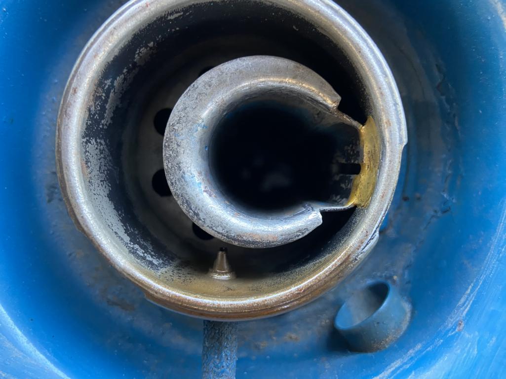

Superhawk996
post Sep 1 2024, 12:20 PM
Posts: 7,845
Member No.: 22,428
QUOTE(Mike1981 @ Sep 1 2024, 01:58 PM) *
Someone did mention this. I could not see a spring in my cap is it under the cork gasket?
Don’t worry about seeing the spring. What important is that the flat area where the gasket sits moves back and forth with spring pressure on it to force the gasket into contact with the filler inlet Attached Image
Mike1981
post Sep 1 2024, 12:27 PM
Posts: 281
Joined: 21-July 14
From: Phoenix
Member No.: 17,663
QUOTE(Superhawk996 @ Sep 1 2024, 02:20 PM) *
Mine is exactly like this one.... broken spring.
Can I buy a spring or would it be better to buy a new cap?
Does anyone have one to sell?
