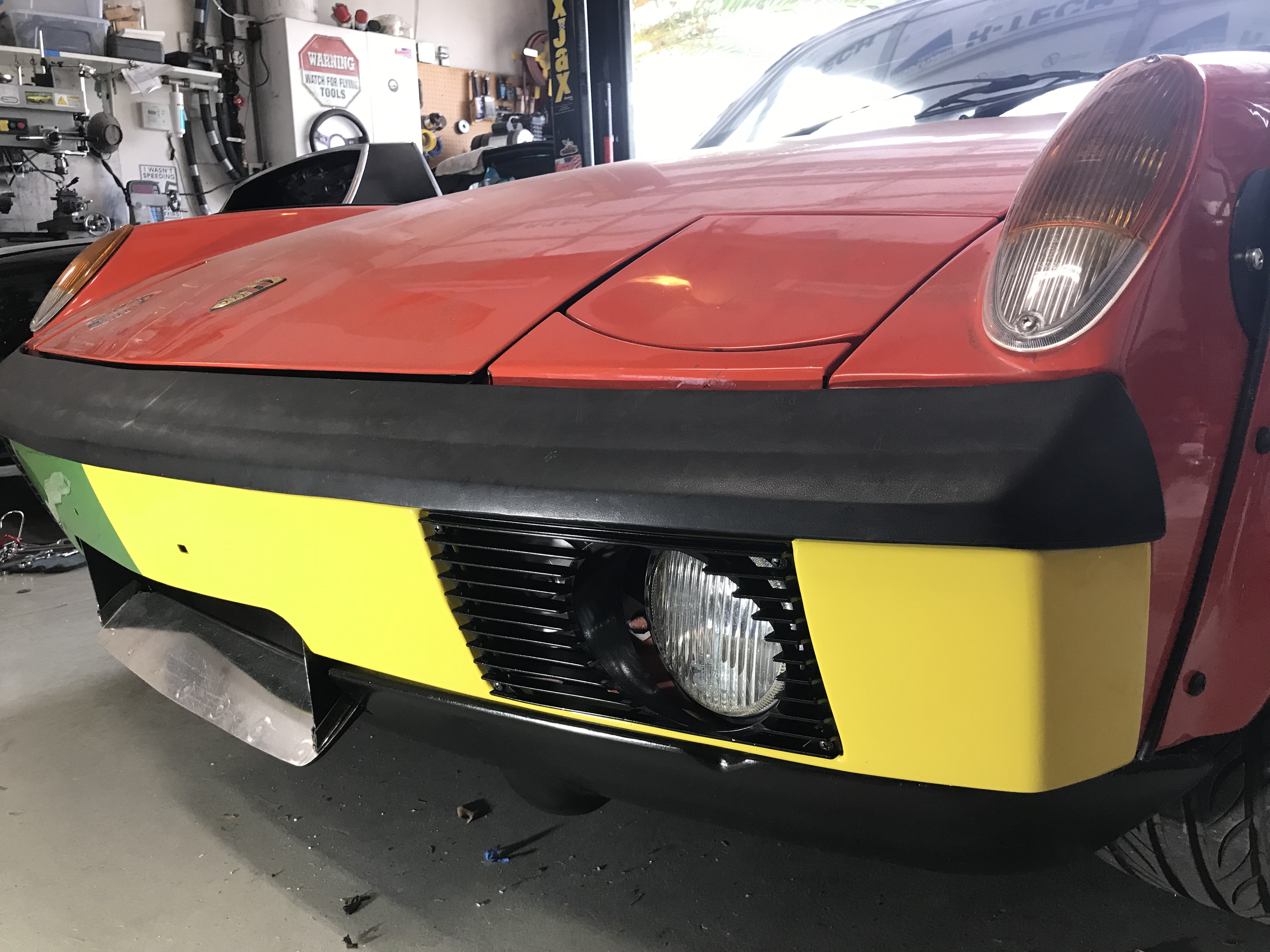

As Brandt said the chrome is plastic too. I'm a firm believer in this stuff......
Thanks for sharing. I’m going to give this a shot on my tired black fog grilles. Do you prime before painting them or just sand first?

QUOTE(DC_neun_vierzehn @ Aug 12 2024, 04:41 AM) *
QUOTE(76-914 @ Aug 11 2024, 10:25 AM) *
Neither. I just cleaned them with some "LA Awesome". I suppose any powerful detergent like Simple Green will work. BTW, I've used this on lots of plastic trim with great results that stand up to the test of time. (IMG:style_emoticons/default/beerchug.gif)
