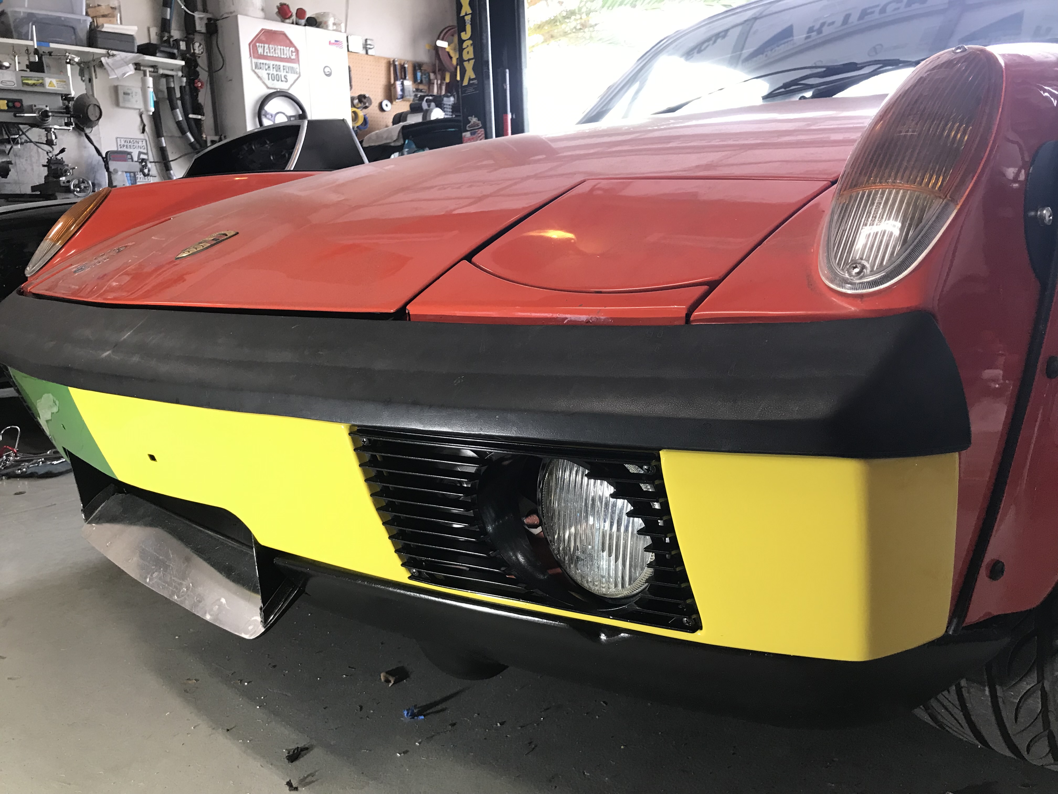

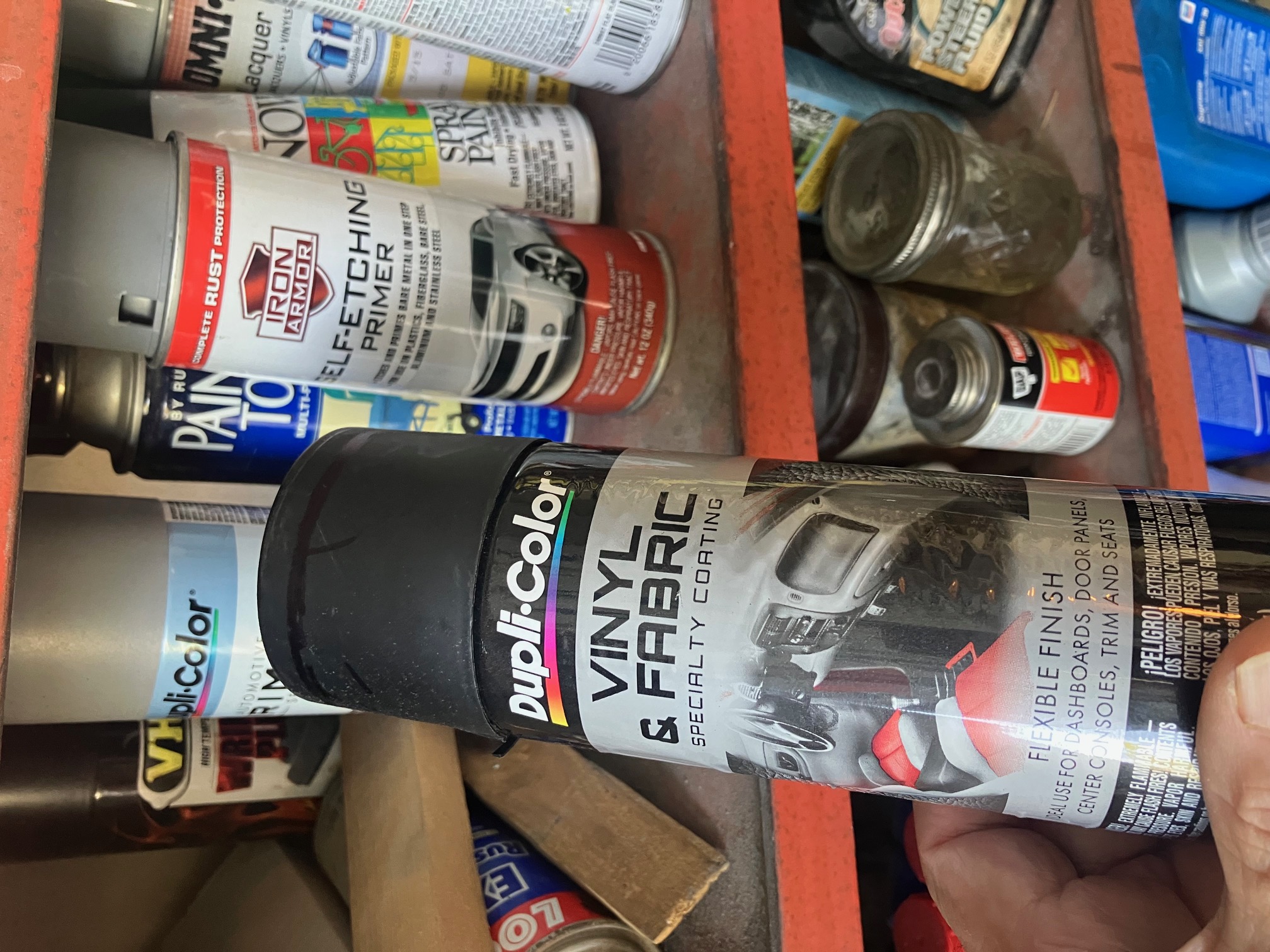

As Brandt said the chrome is plastic too. I'm a firm believer in this stuff......
Click to view attachmentClick to view attachment

Ha!
I saw that "fabric" paint at the local FLAPS and thought "cheapskate way to hide stains on fabric. WHO would ever use that?"
Bout a month later I'm buying a can of black and red...
I color changed a tan Miata windbreak to match a MazdaSpeed red and black interior.
Came out PERFECT!
Looks so "factory" no-one even questions it.
It's lasted 8 years now, still perfect.
I too, am a fan of that paint...
Nice to know it does fine on plastic as well.

QUOTE(76-914 @ Aug 11 2024, 10:25 AM)
Click to view attachmentClick to view attachmentThanks for sharing. I’m going to give this a shot on my tired black fog grilles. Do you prime before painting them or just sand first?

76-914
Aug 13 2024, 05:07 PM
QUOTE(DC_neun_vierzehn @ Aug 12 2024, 04:41 AM)
Neither. I just cleaned them with some "LA Awesome". I suppose any powerful detergent like Simple Green will work. BTW, I've used this on lots of plastic trim with great results that stand up to the test of time.
