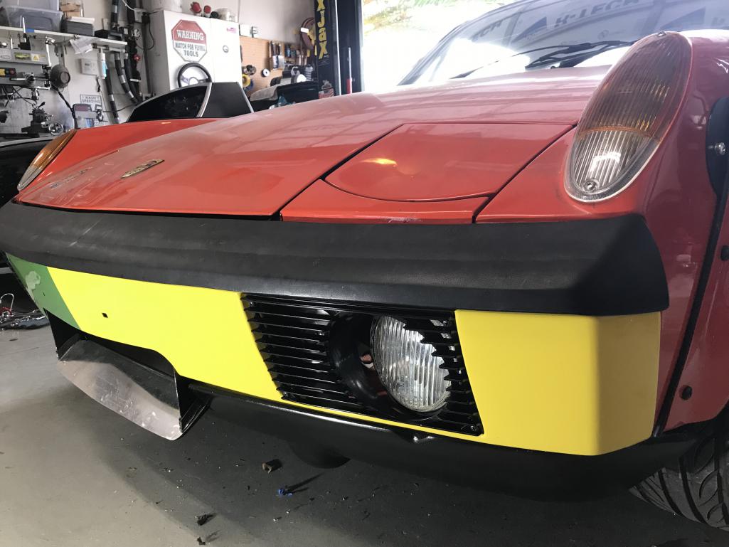

It’s plastic -chrome
I’ve sanded them in all of f the sleeves to and painted then with automotive single stage with good results.
Still periodically chips off on the track and has to be resprayed along with the bumpers. Every other year

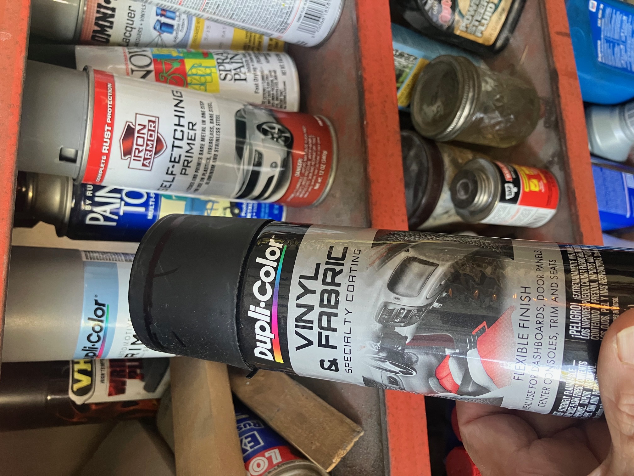

As Brandt said the chrome is plastic too. I'm a firm believer in this stuff......

I saw that "fabric" paint at the local FLAPS and thought "cheapskate way to hide stains on fabric. WHO would ever use that?"
Bout a month later I'm buying a can of black and red...
I color changed a tan Miata windbreak to match a MazdaSpeed red and black interior.
Came out PERFECT!
Looks so "factory" no-one even questions it.
It's lasted 8 years now, still perfect.
I too, am a fan of that paint...
Nice to know it does fine on plastic as well.

I have one original black fog lamp grill. It was never chrome.
Would love to have a mate to it. Have to check which side I have.
It raises a question.
Could an early (70-72) non-appearance, painted bumper car have fog lamps ?
If so... the grills would be body color. Anyone ever see this ?

My original is a 72, non appearance group. I bought two from George in the early 90's ,with the fog light holes. One was a no chrome painted black and the other was chrome painted black. Never found a replacement. I'm thinking about an old model rocket trick, we'd use epoxy and micro bubbles to blend the control fins into the body. It is sand-able and fairly strong.

QUOTE(76-914 @ Aug 11 2024, 10:25 AM) *
Thanks for sharing. I’m going to give this a shot on my tired black fog grilles. Do you prime before painting them or just sand first?

QUOTE(DC_neun_vierzehn @ Aug 12 2024, 04:41 AM) *
Neither. I just cleaned them with some "LA Awesome". I suppose any powerful detergent like Simple Green will work. BTW, I've used this on lots of plastic trim with great results that stand up to the test of time. (IMG:style_emoticons/default/beerchug.gif)
