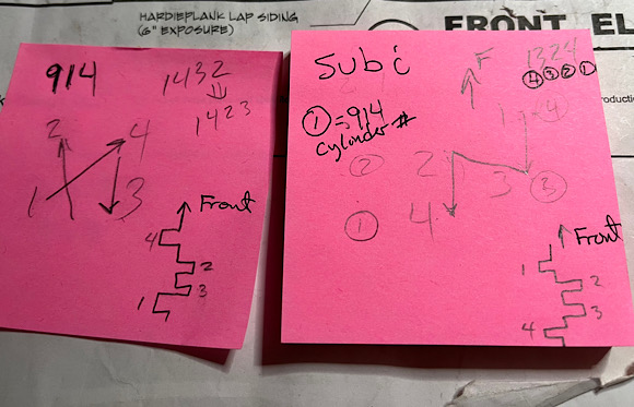

QUOTE(Superhawk996 @ Aug 15 2024, 02:44 PM) *
QUOTE(914werke @ Aug 15 2024, 12:46 PM) *
ever wonder why the fire order on a Suby (4) is 1324
(IMG:style_emoticons/default/laugh.gif) now I'm totally confused (IMG:style_emoticons/default/av-943.gif) since Subaru cylinder number scheme is different.
This was bugging me. Looked up Subi cylinder numbering and renumbered to 914 numbering convention.
Subi 1324 = 914 4321 which = 1432 (IMG:style_emoticons/default/av-943.gif) now I get it. I’m slow and not intimately familiar with Subi’s. (IMG:style_emoticons/default/happy11.gif)
