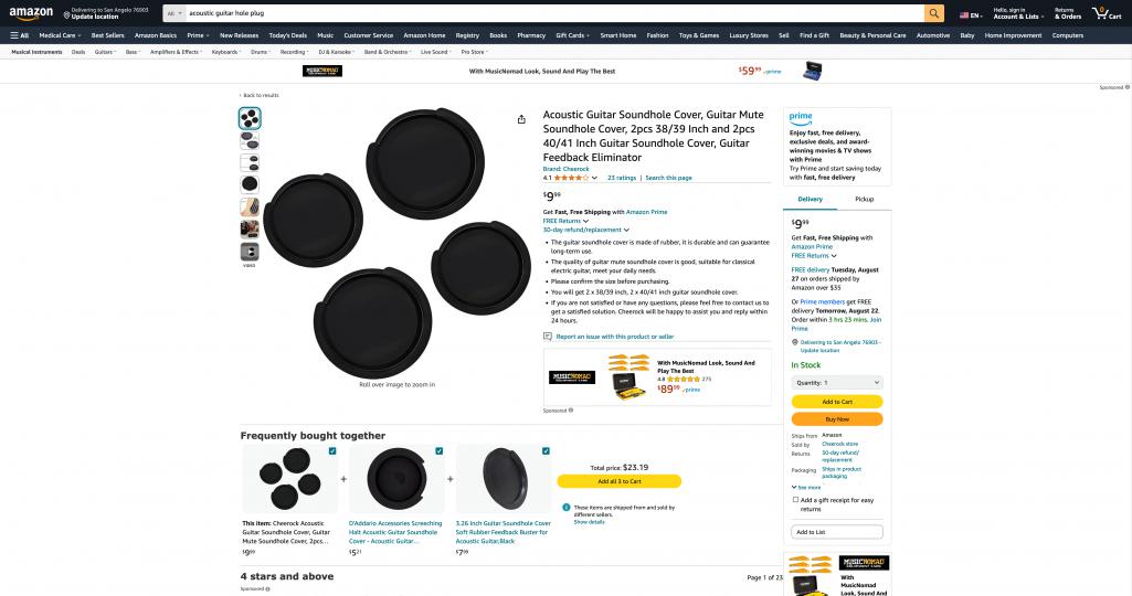

Optional hole plug. Have to measure hole size though. Quick grab.

QUOTE(914Sixer @ Aug 21 2024, 07:53 AM) *
Now that is a clever idea. Just ordered one. Standard 4 in. Thanks for the tip.

What holds the acoustic guitar plug in place ? I assume it’s pushed up from under the car.

I need to get one of those plugs. Good way to keep critters out.

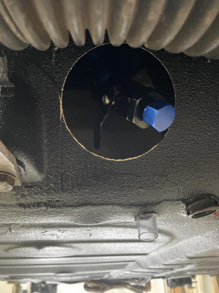

I added a drain valve to my tank and it sticks out a little bit, so I made a little box to cover the hole…..anti-rodent device!
