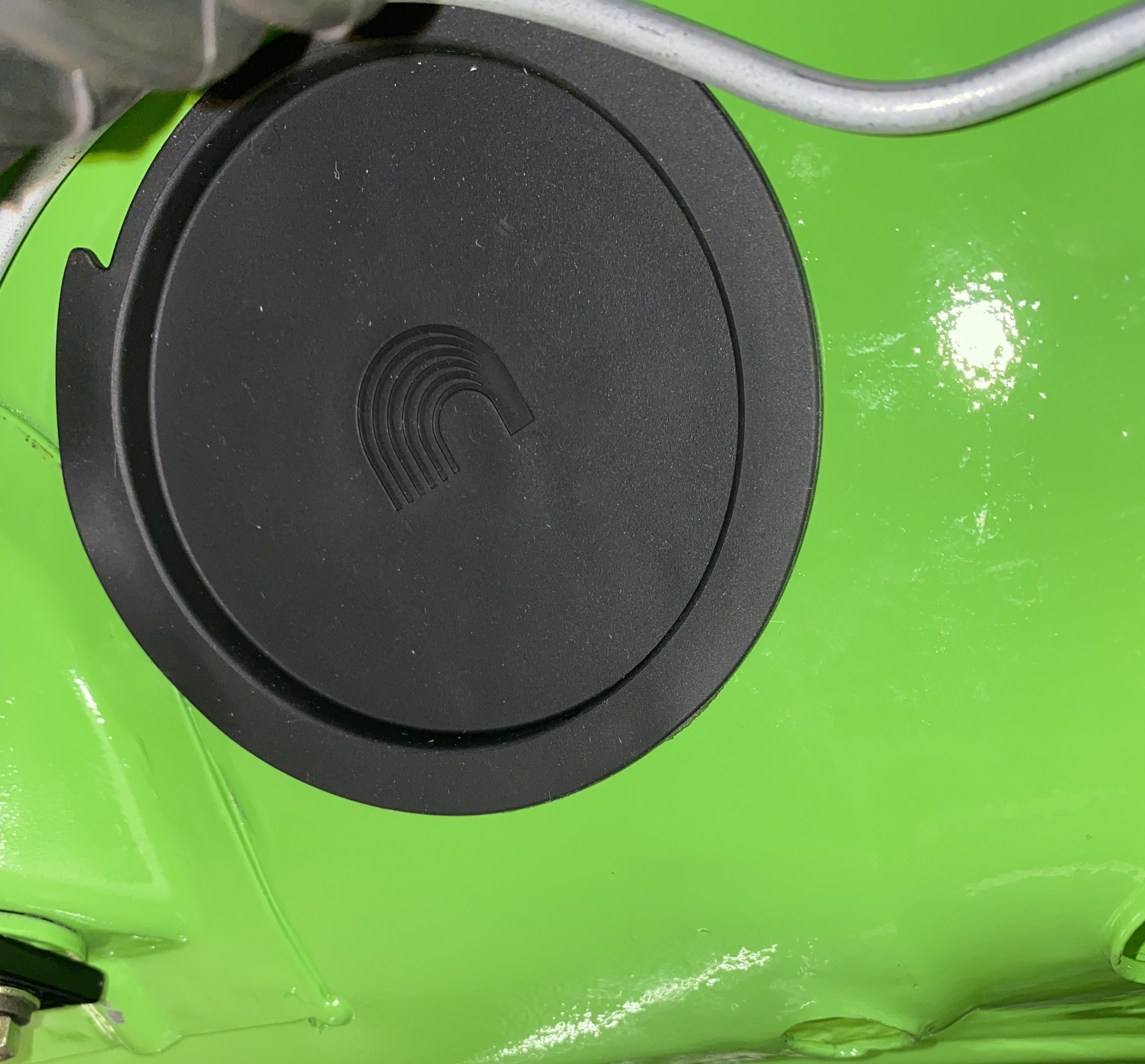

Optional hole plug. Have to measure hole size though. Quick grab.
Tom1394racing
Aug 23 2024, 07:30 AM
QUOTE(914Sixer @ Aug 21 2024, 07:53 AM)
Now that is a clever idea. Just ordered one. Standard 4 in. Thanks for the tip.

What holds the acoustic guitar plug in place ? I assume it’s pushed up from under the car.

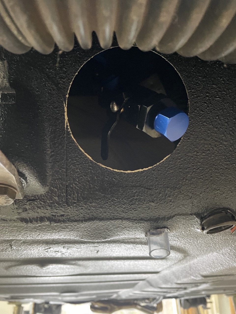

I added a drain valve to my tank and it sticks out a little bit, so I made a little box to cover the hole…..anti-rodent device!
Click to view attachment Click to view attachment

Bought one on Ebay. Perfect fit. Snaps into place.

I just installed the “guitar hole plug’; it’s definitely a good fit.
But I got to thinking the plug will not allow fuel fumes to escape…anyone else this could be a problem ?
Aug 31 2024, 07:20 PM
QUOTE(jim_hoyland @ Aug 31 2024, 05:19 PM)
There's drain hose for the fumes/overflow/spill which should stick out the bottom.
