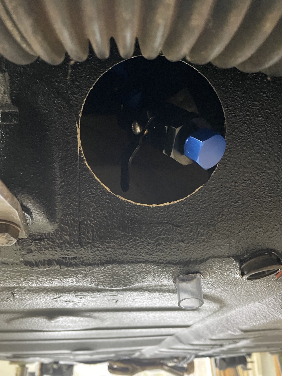

I know the answer should be obvious and that it is probably staring me in the face but....For the life of me, I can't figure out what this big hole in in the bulkhead in front of the fuel tank on my '73 GT conversion project is for. Help please.
BillJ
post Aug 20 2024, 02:42 PM
Posts: 1,355
Joined: 4-March 13
From: charlotte, NC
Member No.: 15,610
Provides access to bottom of fuel tank for filter changes

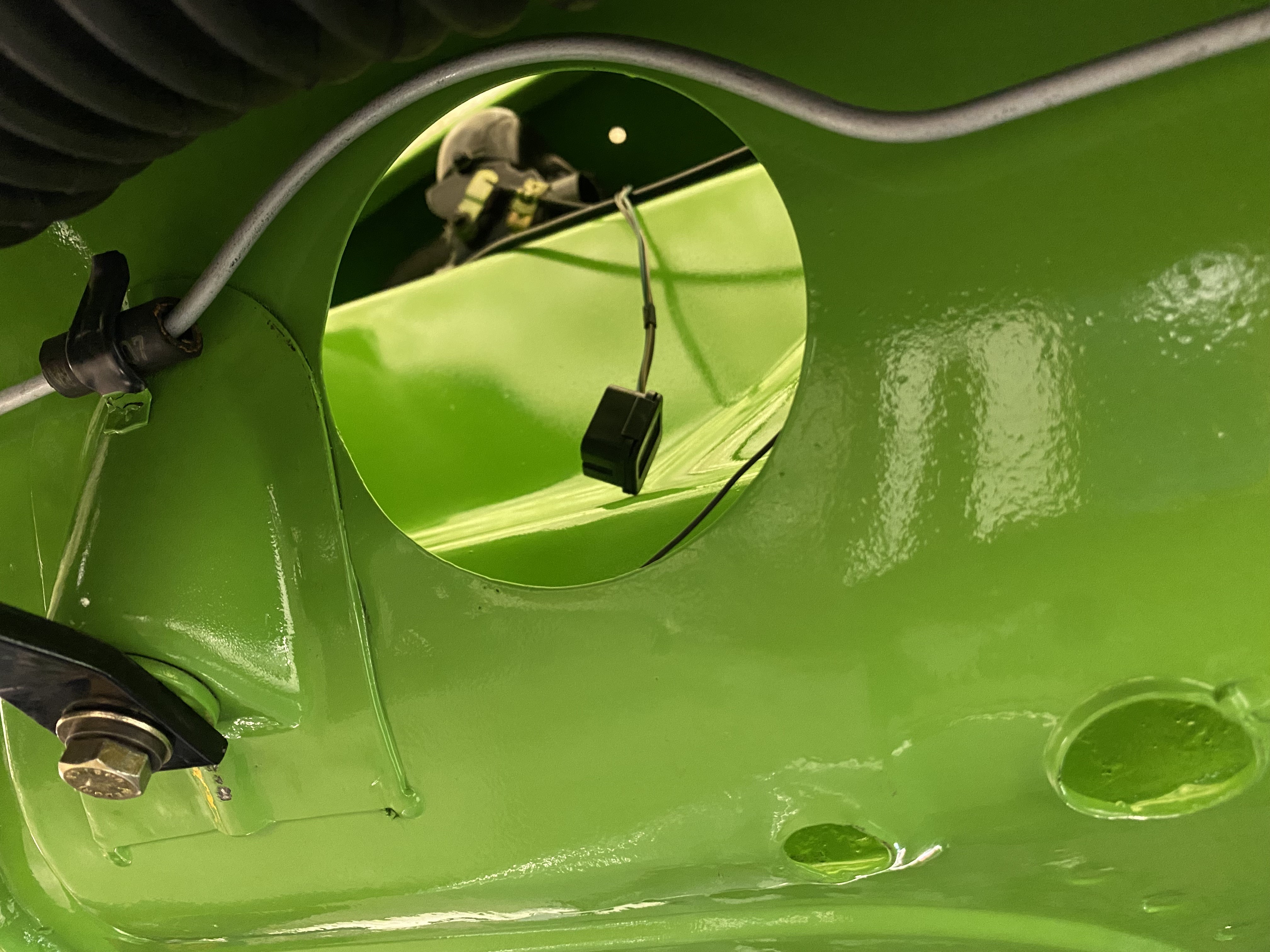

large enough to get your hand in there when you have to.

There should be a plastic piece that fits over ~3/4 of the lower edge so you're not scraping your hand up or nicking a fuel line should you have to pull some of it out.
Once you get the tank back in, use the access opening to feel if you've got a line kinked.

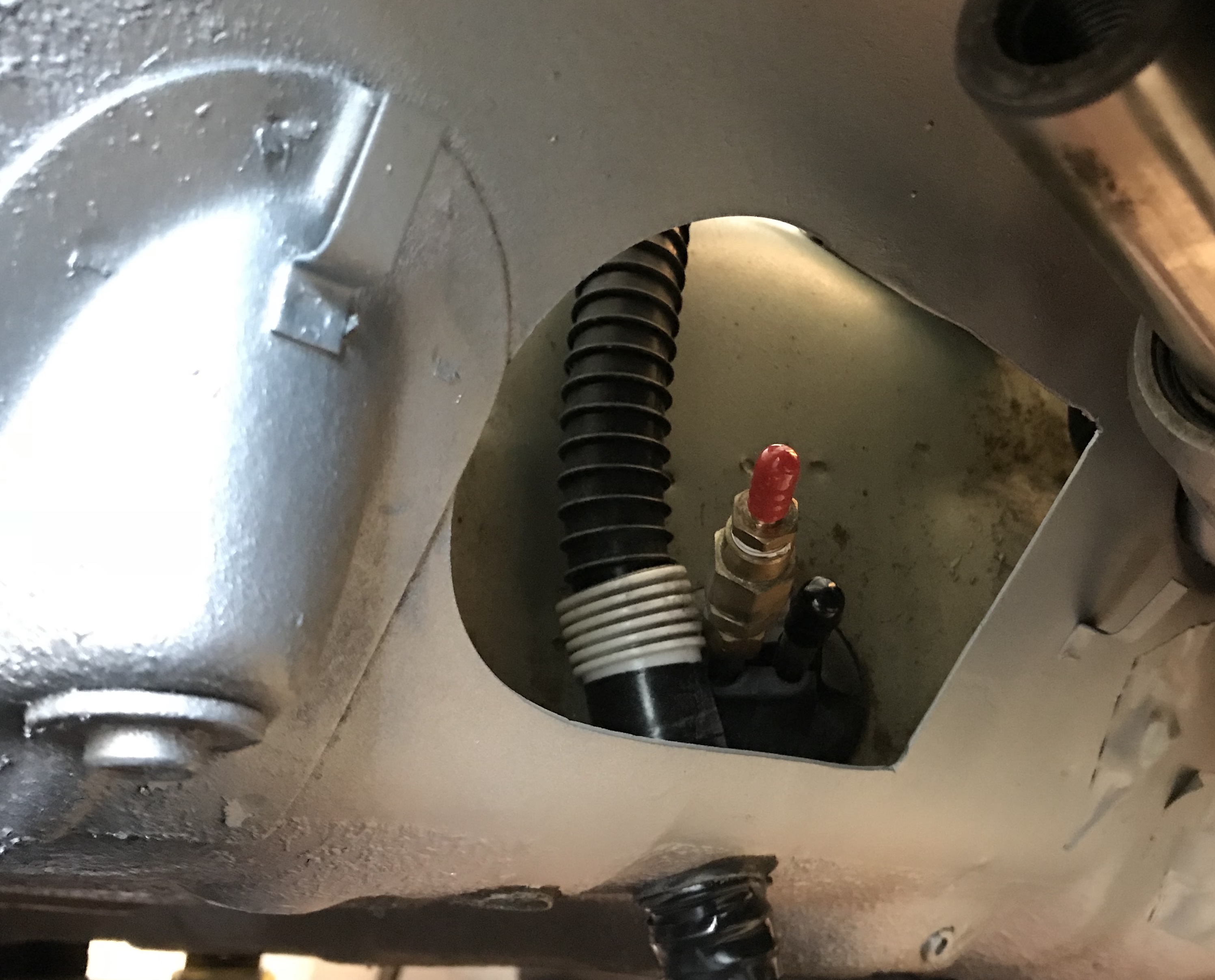

That works best with long-enough enough fuel lines to pull the filter out of the hole.

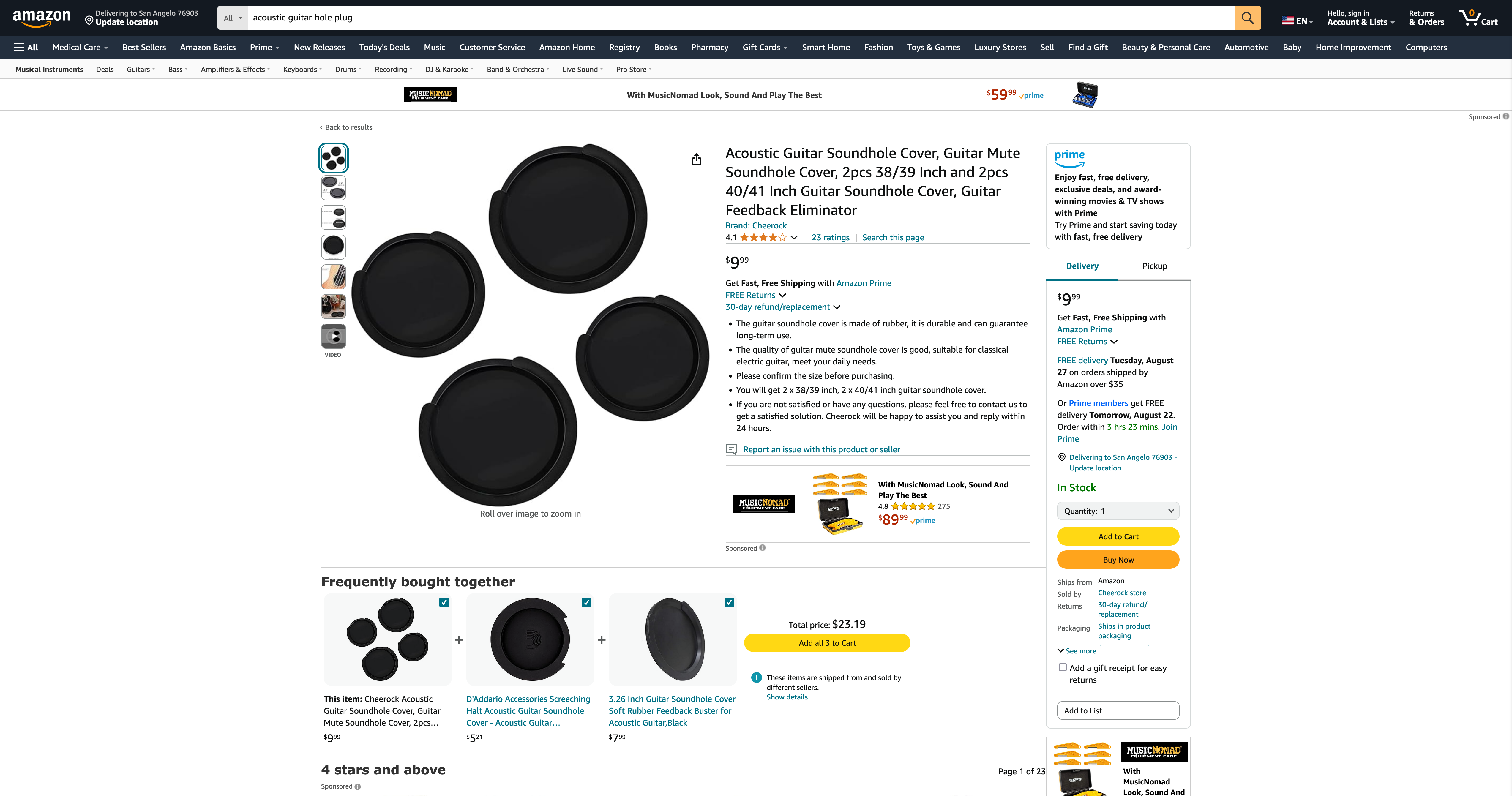

Optional hole plug. Have to measure hole size though. Quick grab.
Tom1394racing
post Aug 23 2024, 07:30 AM
Posts: 509
Joined: 25-August 07
From: CT
Member No.: 8,039
QUOTE(914Sixer @ Aug 21 2024, 07:53 AM) *
Now that is a clever idea. Just ordered one. Standard 4 in. Thanks for the tip.

What holds the acoustic guitar plug in place ? I assume it’s pushed up from under the car.

I need to get one of those plugs. Good way to keep critters out.

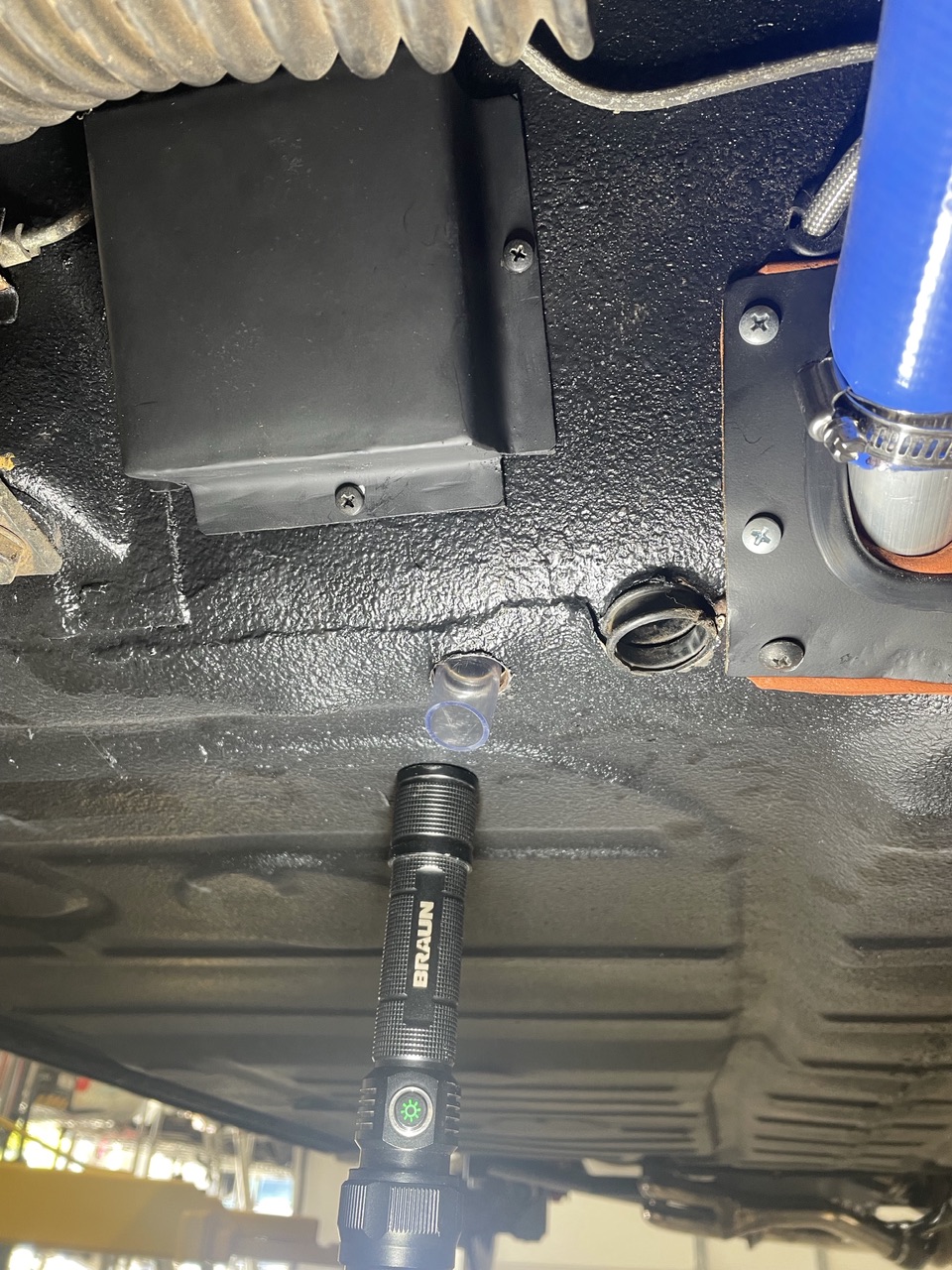

I added a drain valve to my tank and it sticks out a little bit, so I made a little box to cover the hole…..anti-rodent device!

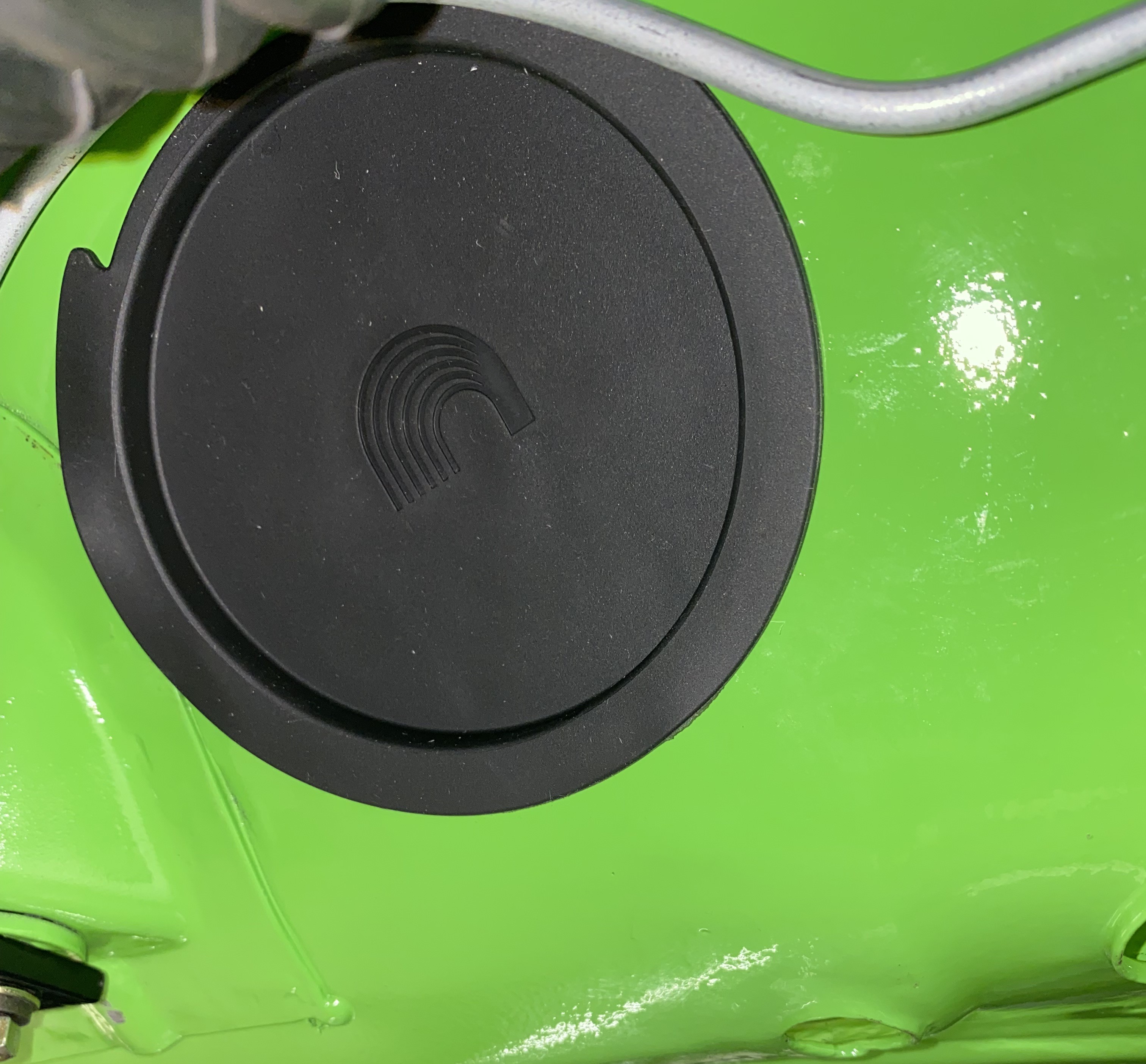

Tom1394racing
post Aug 25 2024, 05:26 AM
Posts: 509
From: CT
Member No.: 8,039
Bought one on Ebay. Perfect fit. Snaps into place.
