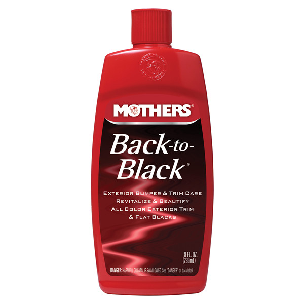

Give this a try.
I have found it works quite well.
(IMG:style_emoticons/default/biggrin.gif) YMMV.

I nailed the name without knowing it. Thanks

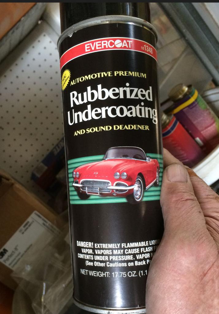

I talked to a guy locally that had a shop and did restorations, he had a nice factory 6 he had restored ( I think his name was Steve, had a shop behind his house just north of Parker). His trick was to use rubberized undercoating sprayed thru a tube (like what comes with braked cleaner) to get the correct texture. The finished result looked very good. Here is the product he used. I have not tried it yet but you might practice on your crappy top.

Another + for Mothers Back to Black. Helps put moister back into rubber, plastics etc.

another for back to black...been using it on bumper tops and sail panels for years.

I will try the Mothers first then. I thought about some undercoat or bedliner but I did not want the texture most of them give. If the straw fixes that, i will try that next.

Back to black will place chemicals on the rubber that soak in and will make painting anything over it a BITCH.
I use it all the time as well.
Works better than anything else for bringing rubber back.
If you're contemplating spraying something that you want to adhere, I wouldn't use the Back to Black first.
post Aug 22 2024, 02:54 PM
914-6 GT in waiting
Posts: 19,958
Joined: 19-September 09
Member No.: 10,825
It works pretty well on the dash pad. Put it on heavy, let it sit, buff off excess.

I guess signals got crossed somewhere. There is no black in back to black. It is a topical dressing for something that is already black. As mentioned in the first post, I need to add black first. Looks like John understood that.
I did half the bumper top before I figured out the can was spraying correctly.
So I am back on the hunt for something to add black to cover up the grey and white colors on the bumper top. Now I have to fight the mothers too. Then Mothers might be a good dressing later.

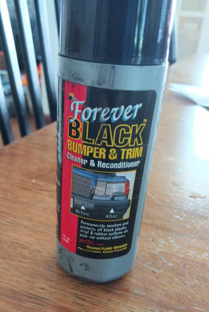

Forever Black bumper and trim cleaner and reconditionerAttached Image

I look it up but most cleaner and re-conditioners don't add black, they just fix what is already there. That says it recolors so it might, plus the black smears on the bottom are a good sign.

Yes, it recolors the bumper top. It has a foam applicator attached.
