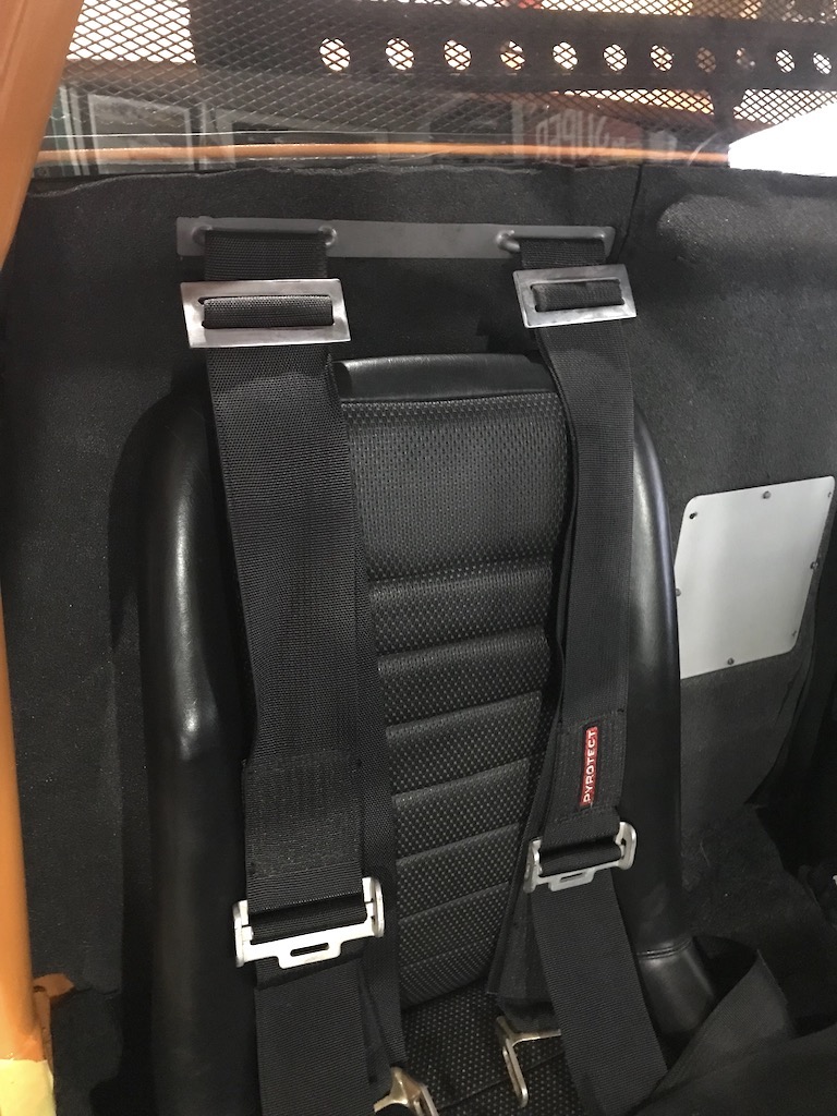

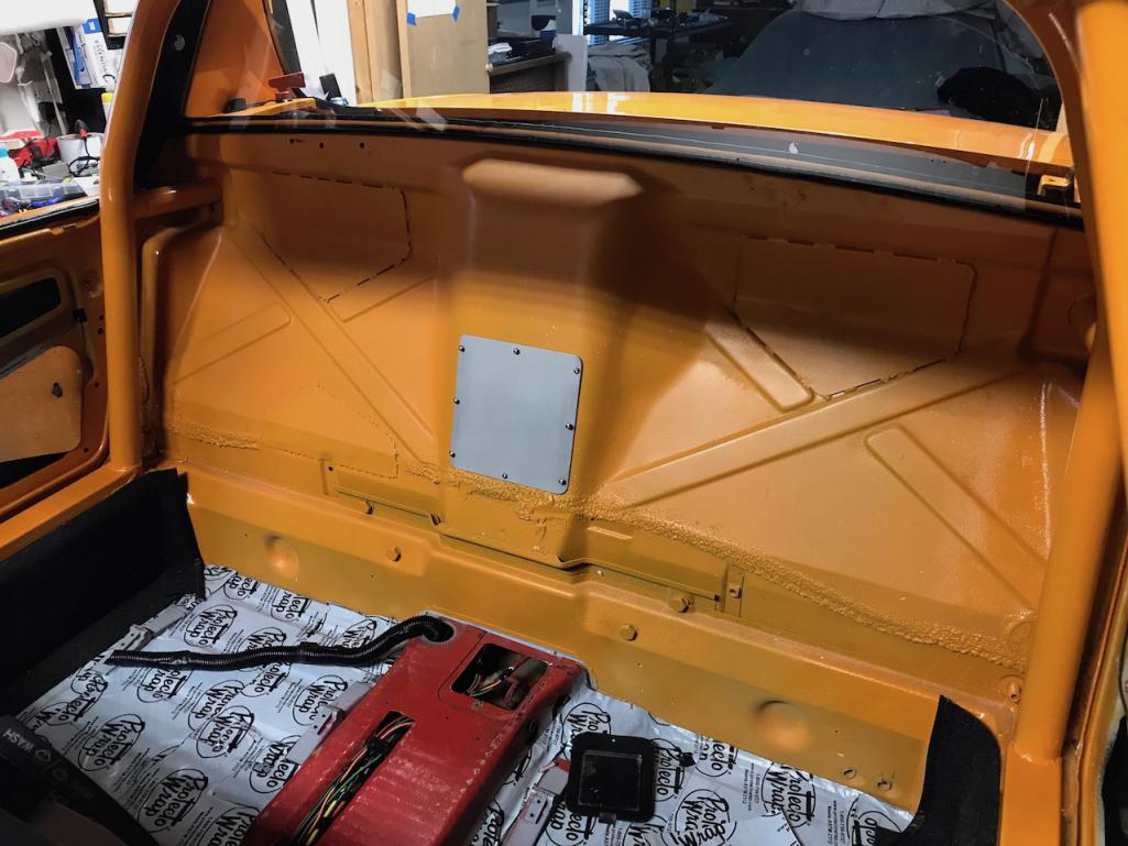

I installed an acèss panel, love it, sealed. Great for timing/valve adjustment. Best, MarkAttached Image Attached Image
