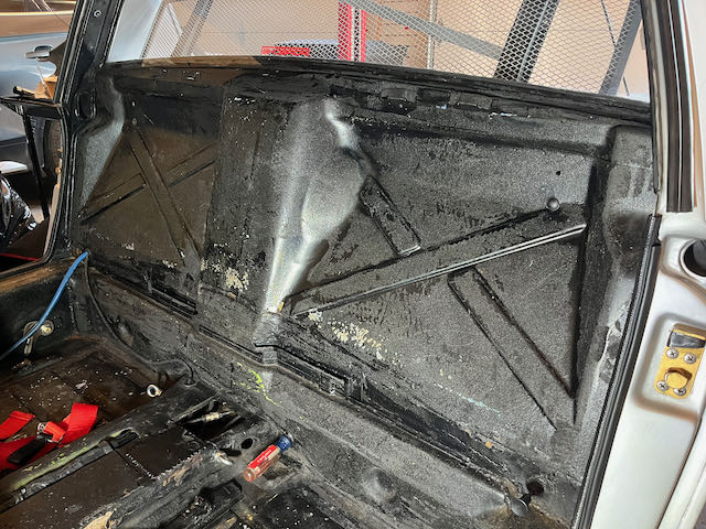

I'm doing a fairly large project on the interior of my 1971 914-6 GT clone this winter. I'm converting to 911 steering and ignition, adding a GT roll bar and harness mounts and a few other bits and bobs.
While it's open, should I cut an access panel? Is there any impact on the structural integrity of the firewall? How difficult is it to lean over the engine and adjust timing without the access panel? While it would be more convenient, I wonder if it's really needed to properly time the car every few years. It's a '71 2.2 liter "E" cam engine.

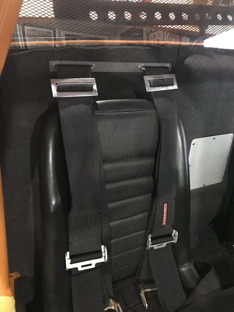

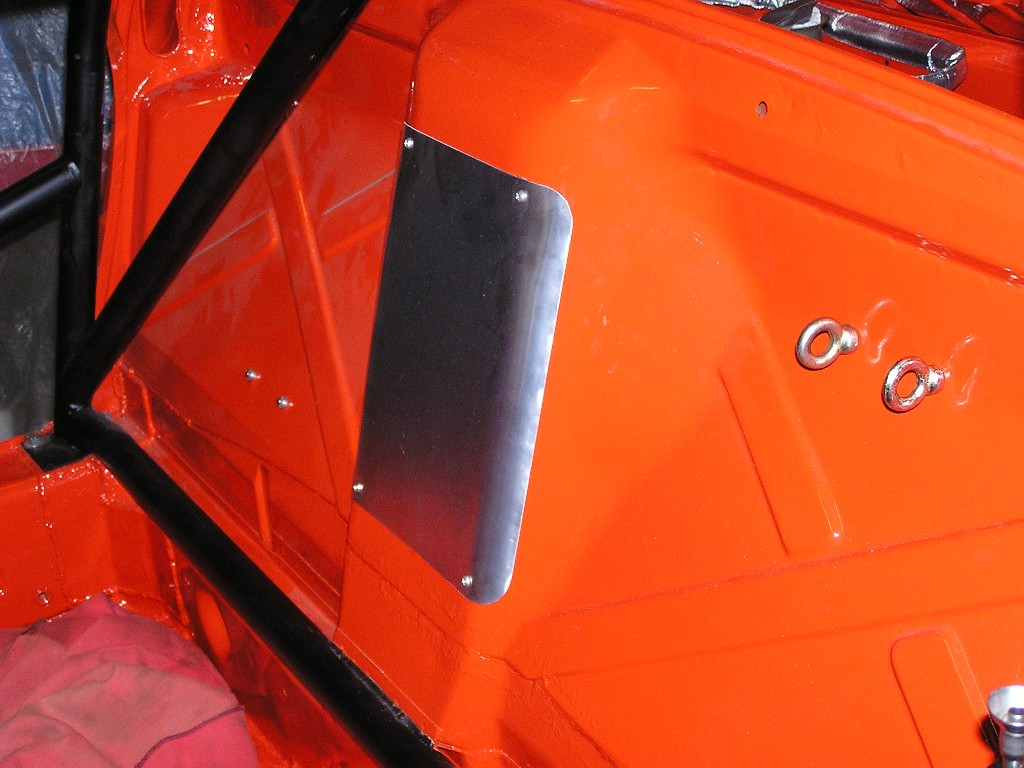

I put one in my GT Tribute, helps a lot with service. I built the car for myself, not to worried about resale. Best, MarkAttached Image Attached Image Attached Image

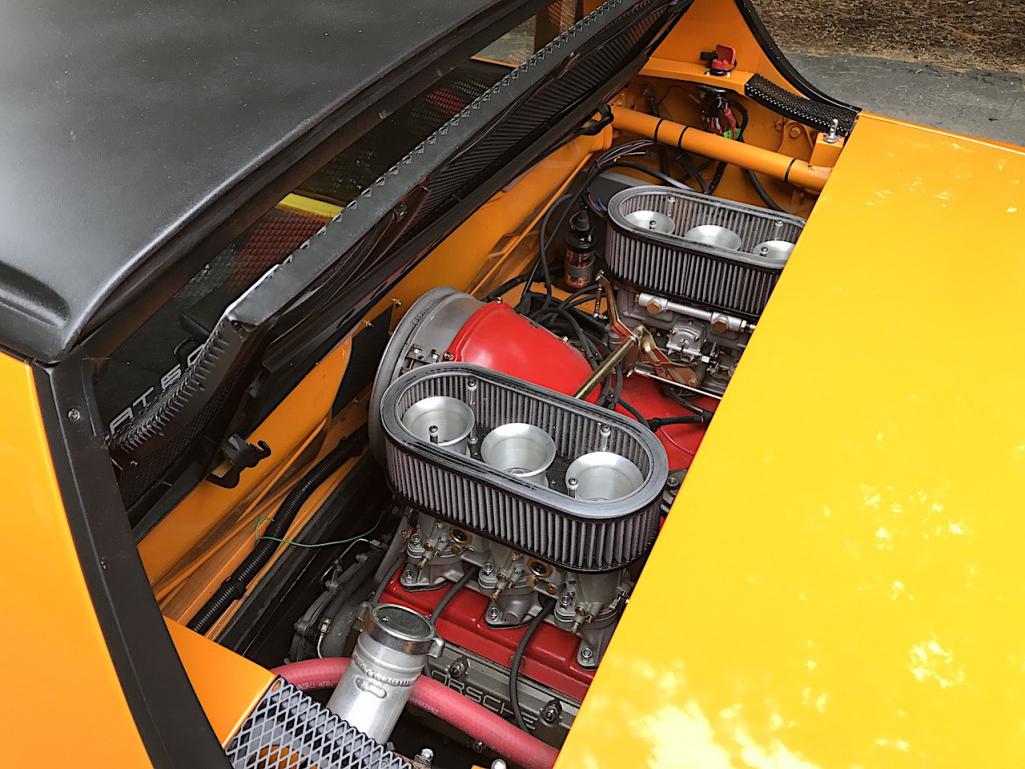

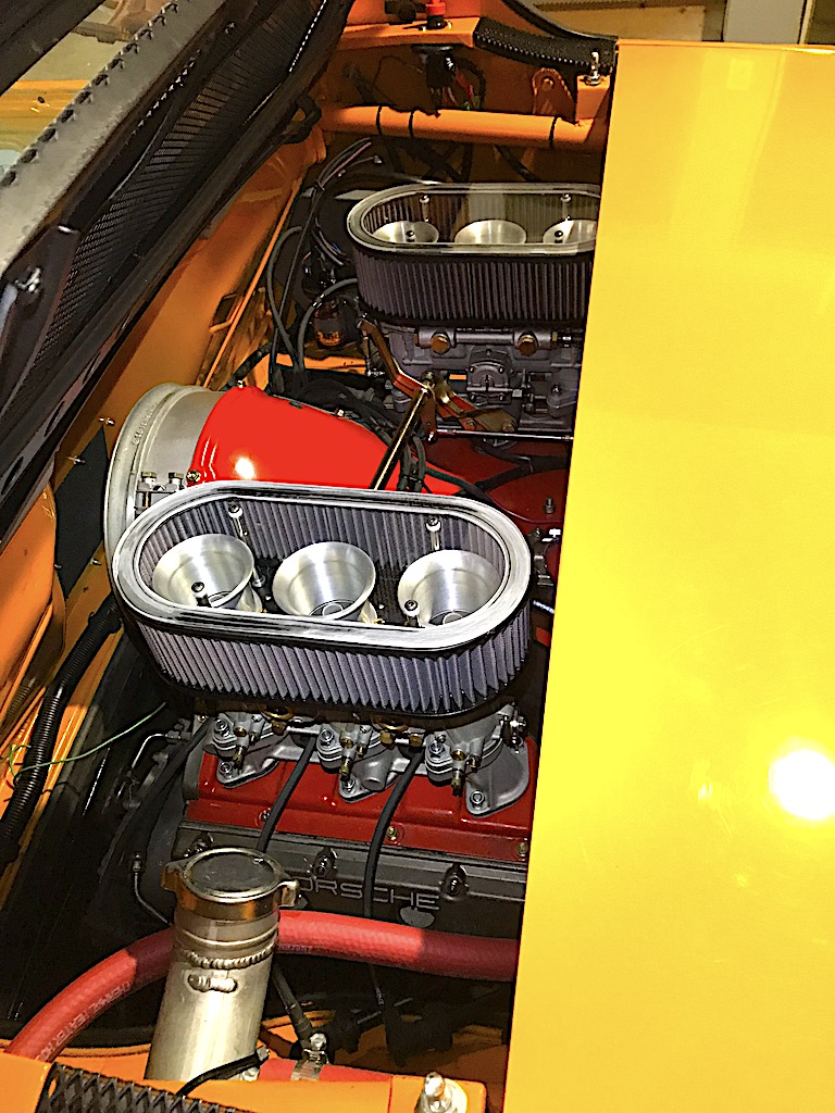

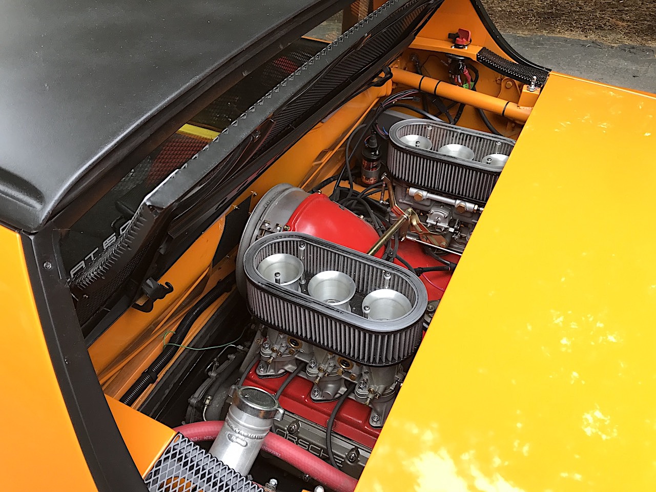

Ours

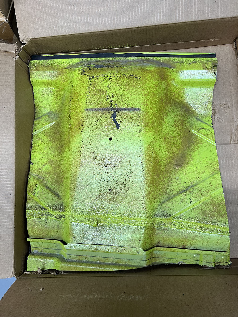

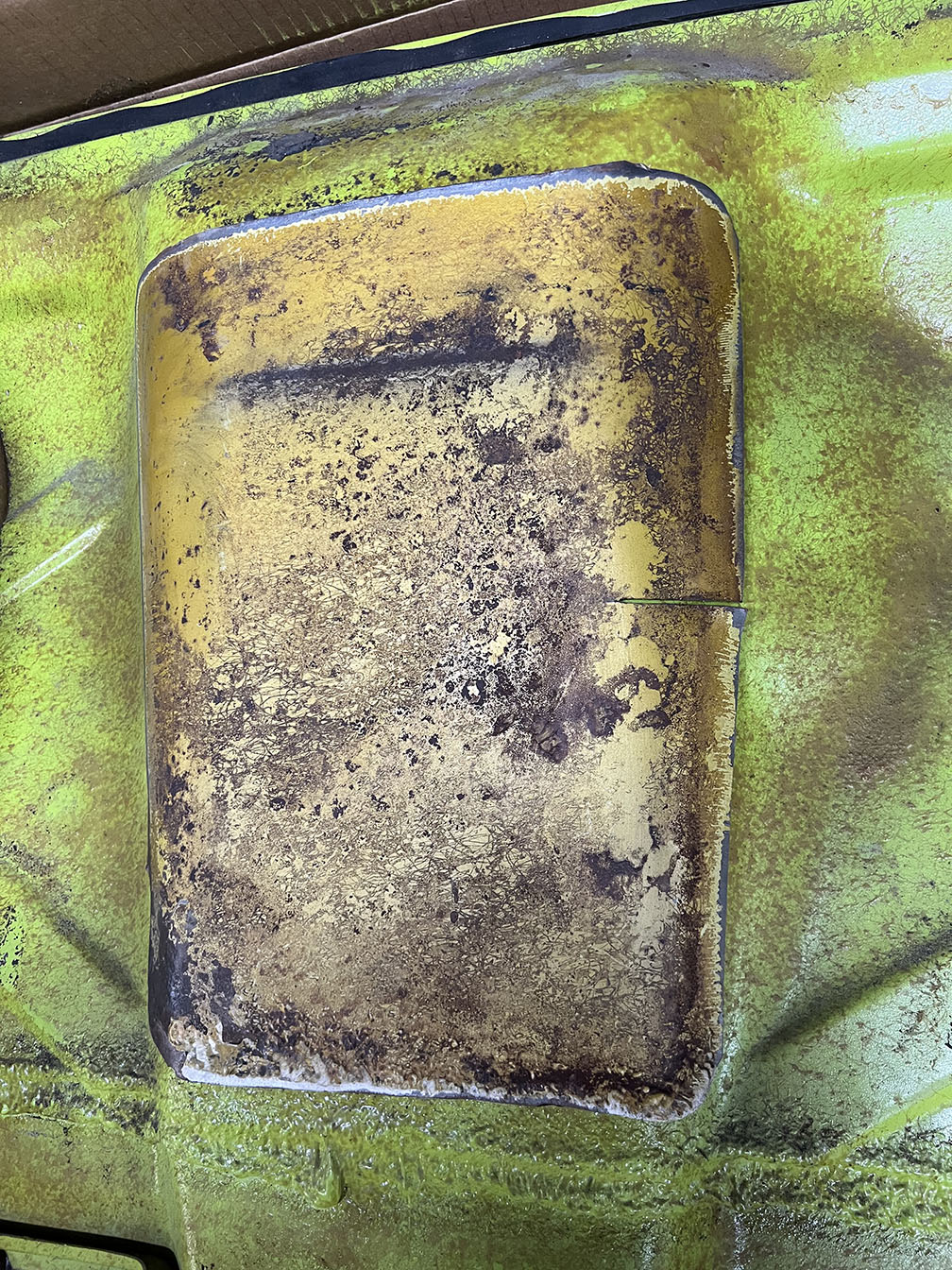

I have what you want. I was going to put in my V8 car body but went a different route.
I have 2, the bigger one may be better. Super clean part. I will list it in parts for sale.
Best Bob B Burton
Boxed in a 24x24x5 box. 10 lb for the big one as it cam from Garold a few years ago

QUOTE(brant @ Feb 29 2024, 01:10 PM) *
Ours
Looks very clean to me, I can't see how this can compromise the firewall?
