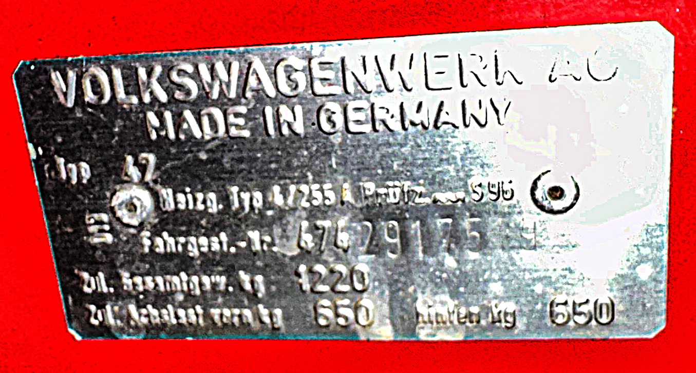

QUOTE(wonkipop @ Sep 15 2024, 09:12 PM) *
can even see its a car with the production number plate rivetted in front trunk rather than engraved in rear trunk.
Indeed, this car is the earliest with the tag that I know of. Importantly it moves the date to week 17, and in week 16 I know of one car with the holes punched, but no tag yet. Please get a good photo for me.
Dave

QUOTE(davep @ Sep 16 2024, 01:23 PM) *
Dave
again sorry for the quality. flash photography and reflective material is tough.

QUOTE(davep @ Sep 16 2024, 02:23 PM) *
Dave
at least my interests in 74 L jets is coming up with some info useful to somebody. (IMG:style_emoticons/default/biggrin.gif) (IMG:style_emoticons/default/biggrin.gif) (IMG:style_emoticons/default/biggrin.gif)

QUOTE(_stickykitty79_ @ Sep 16 2024, 04:38 PM) *
Dave
hey - thanks for all the photos @_stickykitty79_
the plate @davep is talking about is the dark coloured one down on rhs of trunk (ie same side as the headlight bucket manufacturer plate. its down there in the spare wheel well area. don't really need a photo of it, can see it in the photos you already posted at start of topic. it will have the same number as the karmann plate in the lhs door you photographed. dave's now got those numbers and can date the car to when the plate first started appearing.
good stuff.

this is the plate @davep is talking about @_stickykitty79_
i see dave would like a good photo of it if possible.
congratulations - you got a car that popped some valuable data. (IMG:style_emoticons/default/beerchug.gif)
