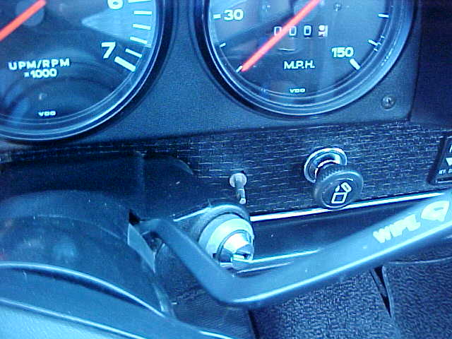

Can anyone please tell me or show me (with pics) Where the trip odometer reset was originally installed? It eems that the previous owner thought this might be a bright idea to have it come out of the dash. By doing this, he left a metal prong protruding out of the dash. When you pull the prong cable comes snaking out of the dash. I have searched high and low to find a knob that will work. No luck. If anyone could please help me, I would greatly appreciate it.
Where was it originally? What should I do now?

Better perspective of where it is located...

Look right under where the cable comes out of the dash now. The cable and knob pointed straight down. Should be a hole in the dash frame. Knobs are really hard to come by on there own and you will need a nut to hold the cable in the hole. Good Luck.

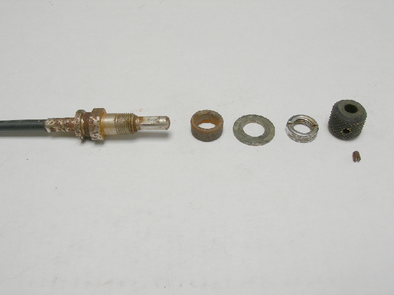

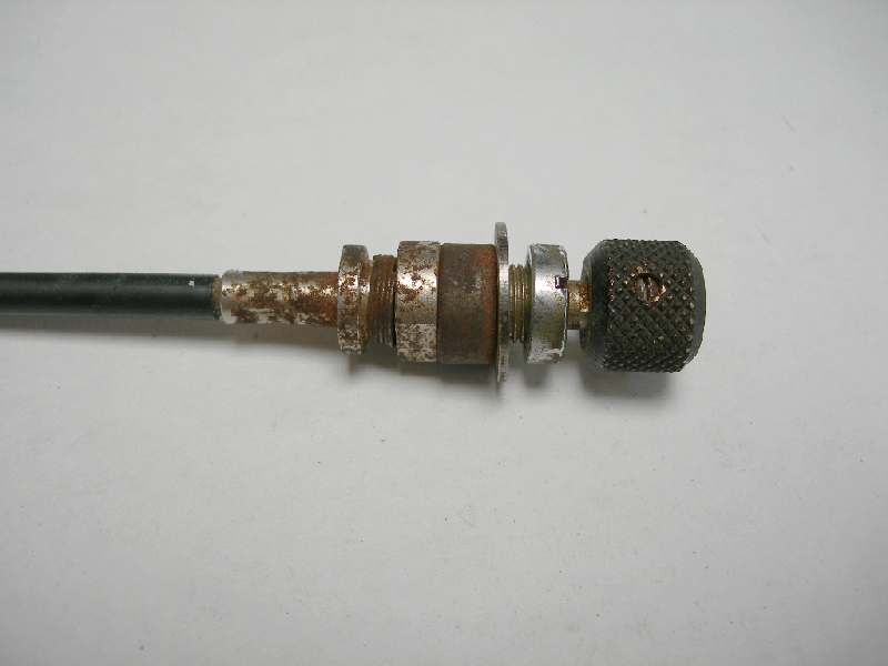

Here is what a dirty spare looks like.
VegasRacer
post Aug 27 2005, 03:15 PM
ELVIRA
Posts: 8,933
Joined: 27-March 03
Member No.: 481
Apart.

So Danna, look at John's picture apart and compare the end of your cable to the picture.....different. That must be why the hole in the face of the dash. Looks like you need the whole cable. It's easy to install in the speedo. It just has a nylon plug that pops into the speedo case. But you need the right cable.

Isn't the cable (the one shown assembled and dissassembled) an early style cable.
IIRC, my 1974 has a cable similar to the one shown in the original post. On my car, there is simply a black plastic push-on knob that turns the trip reset cable. There is no way to "fasten" the cable to the hole in the lower dash hole other than the friction of the knob to the shaft.
I may be able to post a pic tomarrow.
I just wish my trip gage would reset correctly. I have some defect in mine where it starts out resetting correctly, but ends up with one of the digits wrong. I think it ends up on 1 mile or something. I can never get it to 0000. At least it does count miles....

Thank you for the info. I just need the knob. The reset works, when I picked up the car it was at 6666 and the visor mirror is broken (I hope it is not a bad sign.)
I think you are correct in assessing the need for a knob and possible a back clip or something to keep the cable from turning, increasing the turning friction. If anyone knows where to get a knob or what might work, please let me know. Thanks once again for helping a girl out.
