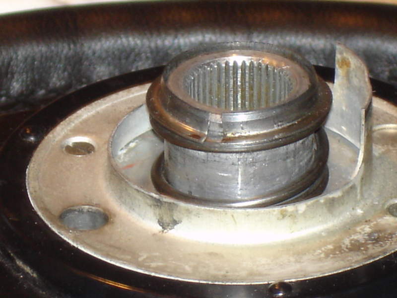

I'm fitting what I think is a '73 911 steering column to the 914 Ferrari build. I've trimmed off the 911 mounts and have the necessary custom mounts worked out to fit the column to the car. What I want to nail down is:
1. What year(s) does this column come from?
Most importantly: What parts do I need to complete this?
2. I understand these run a particular metal sleeve and spring (vs a bearing) beneath the hub but apparently there may be an updated nylon bushing... I'm having trouble finding details about what the best solution is.
3. Once I'm sure of the year, I suppose I can work out this one but: I want to run a Momo wheel so which Momo hub do I need? This requires something with a "nose" that extends down onto the splines...
Again, I appreciate your helpful guidance.

Bunch of pics in this thread:
http://www.914world.com/bbs2/index.php?showtopic=82045
My 911 column is also from a '73 ...

this 73 911 , 914-6 ..
Maybe that later drive in sleeve will work ????

is there balls and a upper race ??
