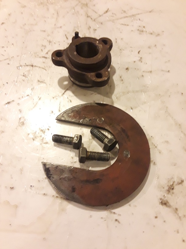

Not near the garage/workshop today, so can't take a photo of the homemade tool.
But it's a pretty simple tool to make. A piece of thick sheet metal with a slot the width of the crankshaft snout cut into it. Then harden it.

Here's the super-specialized tool that works a trick:
A "church key" bottle opener, or another thick, flat piece of metal.
The three fan mounting bolts.
Hold the church key up behind the fan hub. Thread in a fan bolt until it touches the key. Give it 1 complete turn. Loosen it a bit, move the key to behind the next hole in the hub. Thread in another bolt until it touches, then give it 1 turn.
Continue this process, going around to each of those three holes, until the hub pops off. Shouldn't take long.
For the extra-fancy version, you can use three church keys or fender washers. That way you don't have to back off the bolts to move the key.
--DD

I’m going to piss off the guys that use the flat metal or church key approach; yeah it works and 99.9% of the time isn’t going to harm anything but it is poor form.
You want all the forces kept between the hub and the crank. Steering wheel puller or pulley puller is the correct tool.
Using the flat metal and three hub bolts approach transfers the axial forces into the case.
If you’ve already removed the flywheel, there is nothing to react against the main bearing with the thrust surface. You’re now pulling the crank journal radius into the sides of the main bearings. The main bearings aren’t designed for this sort of axial force.
If you’re replacing the main bearings - oh well, who cares. None the less, not the right way to disassemble the hub from the crank.
If you have the steering wheel puller, use the right tool.

A steering wheel puller does work if it's a three prong/hole version. But, it also needs to be the right size. A two hole version won't really cut it.
Or an harmonic balancer puller of the right size.
Either way this job can justify getting another new tool. But, if you don't have the right tool, a piece of sheet metal works, even if it pisses off those with all the right tools.

That is little different from the "church key" method. It's still spreading the load out to the case.
