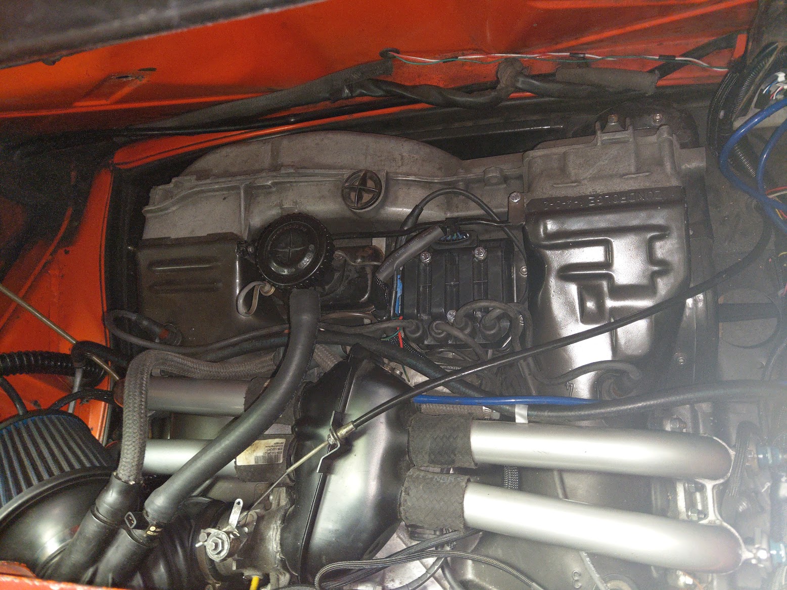

QUOTE(emerygt350 @ Mar 17 2025, 01:52 PM) *
Or just don't be an idiot. You guys all have an idea of precision on your ability to set your timing dead on while juggling a light and holding the throttle and turning a dizzy that probably isn't justified. There is so much variation in these engines that just getting in the ballpark and returning to a previous setting is all your looking for. 30 for me is probably not actually 30 etc... even with Bluetooth, you set it to what the engine wants, not some absolute number. No tech is going to put a motor on the Dyno and set the timing to some preconceived number and keep it there.
My timing holds like someone is shining a laser pointer on my fan. No dizzy twisting required, or even possible. (IMG:style_emoticons/default/biggrin.gif)
emerygt350
post Mar 18 2025, 05:20 AM
Posts: 3,051
Joined: 20-July 21
From: Upstate, NY
Member No.: 25,740
That is a very pretty engine you got there.
