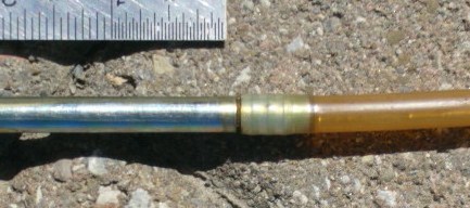

Here's a pic of the line
swl
post Sep 6 2005, 08:40 PM
Posts: 1,409
Joined: 7-August 05
From: Kingston,On,Canada
Member No.: 4,550
and a close up of the joint.
