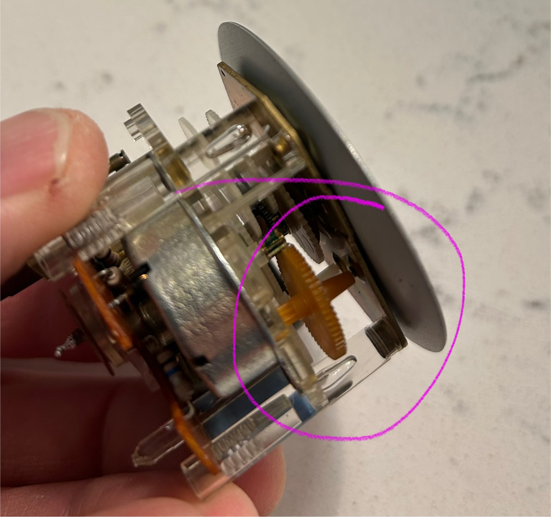

QUOTE(Shivers @ Nov 22 2025, 06:26 PM) *
Thanks. Good info in that thread.
I took my OG VDO clock apart. Unfortunately for me, it’s not an electrical problem (eg. blown caps or resistors). Mine has multiple bad gears (worm and/broken). I do t think this is DIY. I do t have other clocks to poach parts from.
