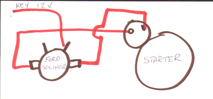

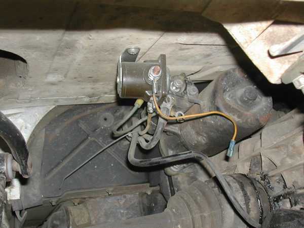

trekkor is using a ford solinoid...I'v put many into customers and my cars, they have never failed to work unless it was something else.
Just go to a FLAPs and ask for a Ford solinoid that mounts on the inner fender.
I also don't care if people call it a band-aid...beats cutting and hacking the OEM wiring. The way I do it I cut absolutly nothing.

The reason I opened the discussion was in order to prevent myself from doing something that was not really required. I had removed an old relay similar in placement as shown on Trekkor's reply. This solenoid had been disconnected by the PO or someone before that and I therefore removed it about a month ago. It seems that someone had a similar problem on the car sometime in the past history of the car.
I may try the ford solenoid as recommended by Mark Henry. I did some work on the car this morning and it started without hesitation. The volt meter reads about 13.5 to 13.8 in the car so I assume the battery is up to snuff. When the car gets hot, I encounter the problems.
As of now, I think the ford solenoid may be the answer. The bosch relay is only about $20.00 from Tweeks, but some of you seem to think it is not adequate but actually a "band-aid".
Mark, If I try the ford solenoid solution, what would be the recommended wire gauge? I assume it needs to be at least the size of the yellow ignition switch wire that would connect to the new solenoid.

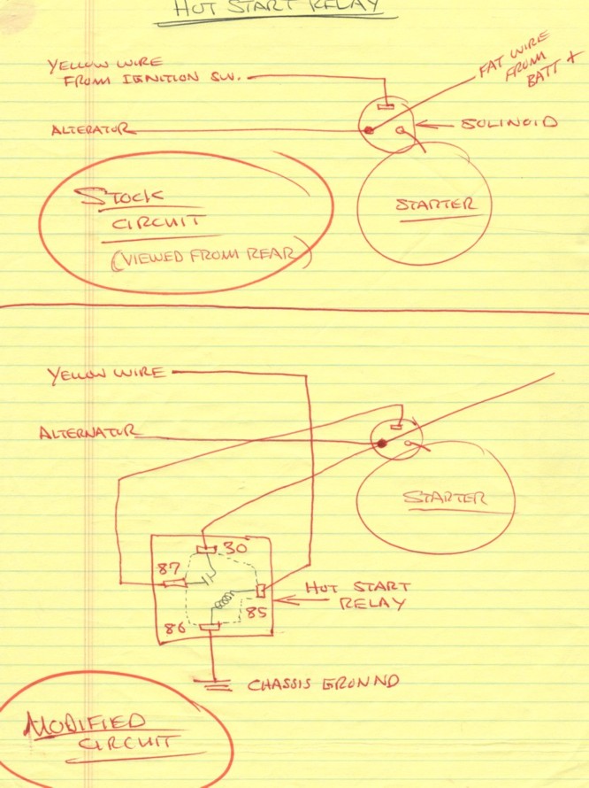

I have installed a hot start relay on all of my 914 cars and have never had
a hot start problem with any of the cars since.
You only relay need a little relay with 10 amp contacts to do the trick. The
Ford relay is heavy duty over kill.
A diagram:

Thanks, 94teener...
Is this the same relay that comes with the hot start booster that Bosch makes? Or is this similar to the one Mid America Motorworks has for sale?
black914
