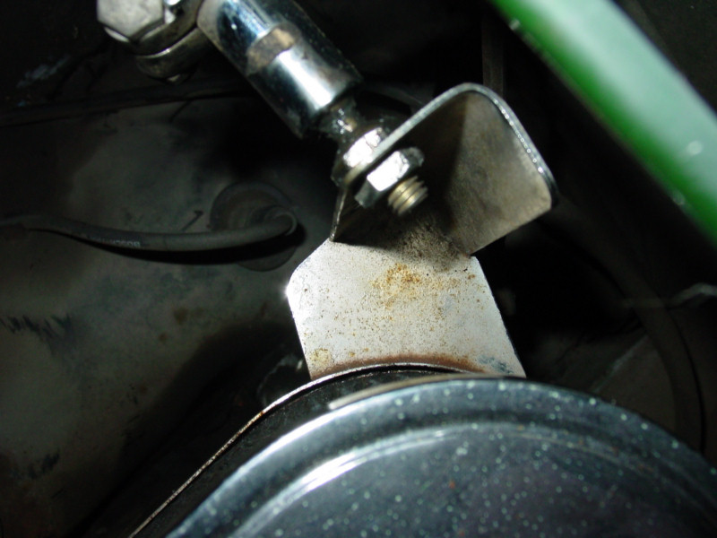

QUOTE (Joseph Mills @ Oct 2 2005, 10:33 PM)
Sounds like your linkage may need to be upgraded. Do you have a pic of it?
Linkage pics!

Another:

that linkage is laughable....look at the angle that throttle cable makes with the linkage

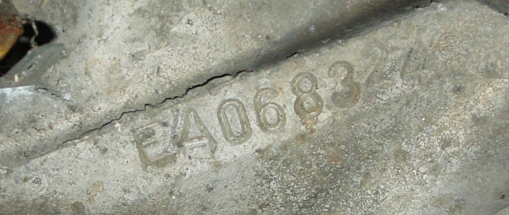

Here's the engine number.. any ideas what I've got? The PO thought it was a 1.8, but then it's been rebuilt, so who knows.

QUOTE (bd1308 @ Oct 3 2005, 07:36 PM)
(IMG:http://www.914world.com/bbs2/html/emoticons/lol2.gif)
Yeah, and the gas pedal is super stiff, even with a new throttle cable and rebuilt pedal cluster.

oh shit!
what's that crack....Z could give that crack a run for it's money, but isnt that like on the block?

QUOTE (bd1308 @ Oct 3 2005, 07:42 PM)
oh shit!
It's not a crack, it's just some overhanging casting flashing that's making a shadow because of the flash (took the pics like 30 mins ago.. it was dark)
