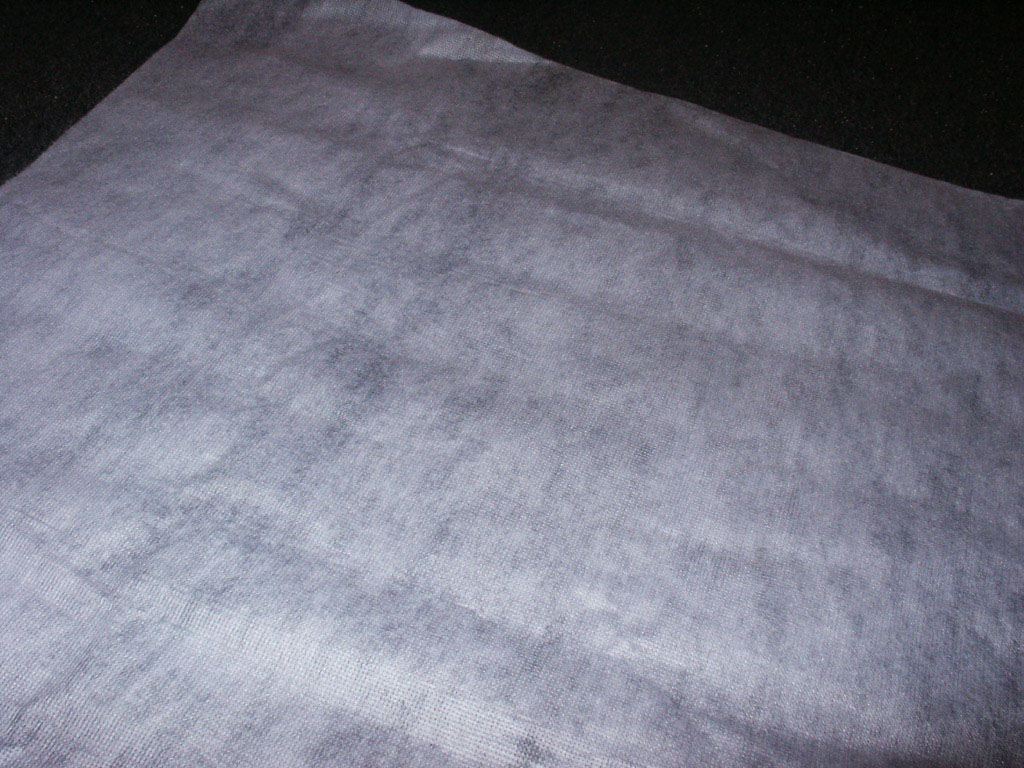

- Fabric of your choice. I chose adhesive-backed 3M cloth.
(IMG:http://www.worldwidebilliardsupplies.com/images/cloth_6822_black.jpg)
