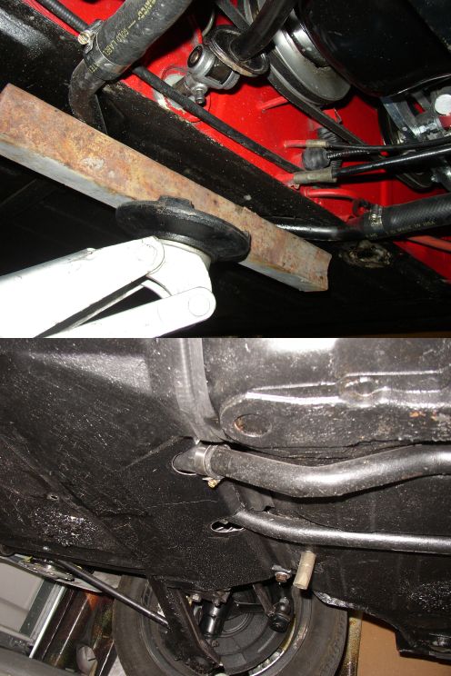

3/4" steel pipe (common black pipe) fits nicely underneath if you want to take the time to bend it so it conforms to the indentations running under the center of the car. It will not crush and I routinely use my floor jack to raise the car under the pipes. I put a short length of 2" square steel tubing to distribute the weight across both pipes. The pipe is bent to aim up into the bottom of the front trunk and can be cut off right under the steering rack. From there you can transition to 1" ID rubber heater hose (Gates or equiv.) to the radiator. The bottom cover under the rack is notched in two places to clearance the pipe.

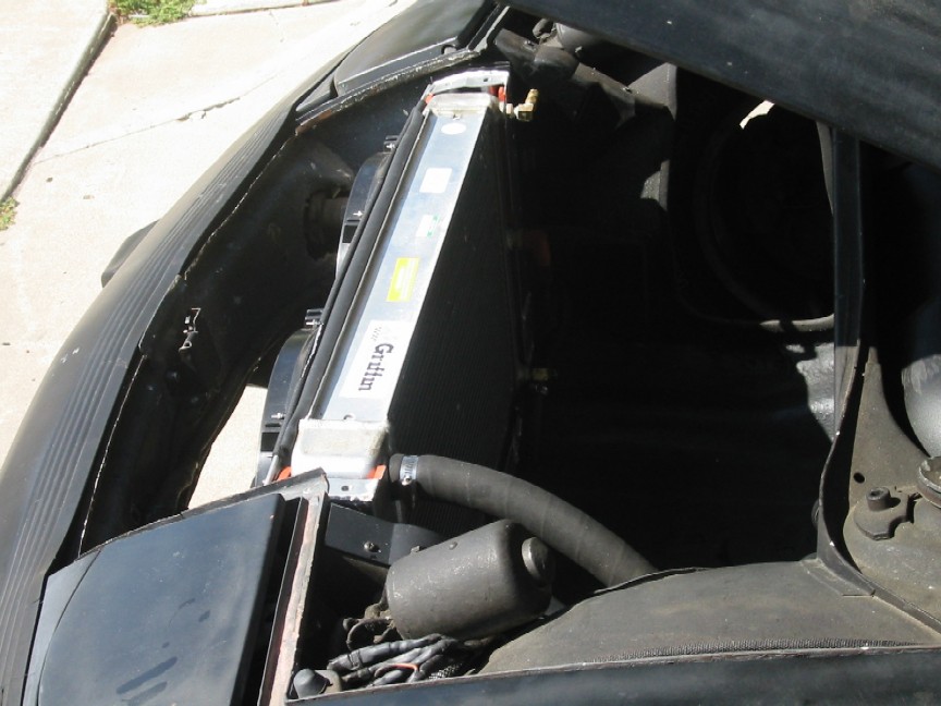

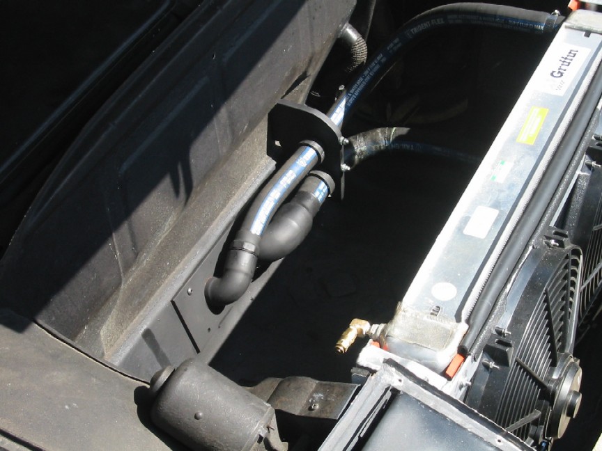

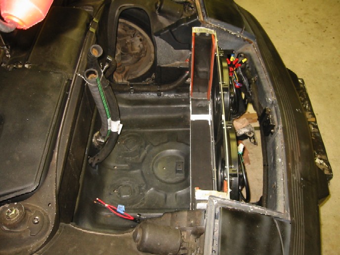

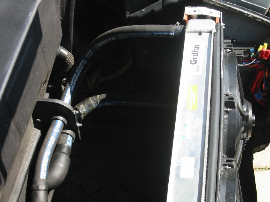

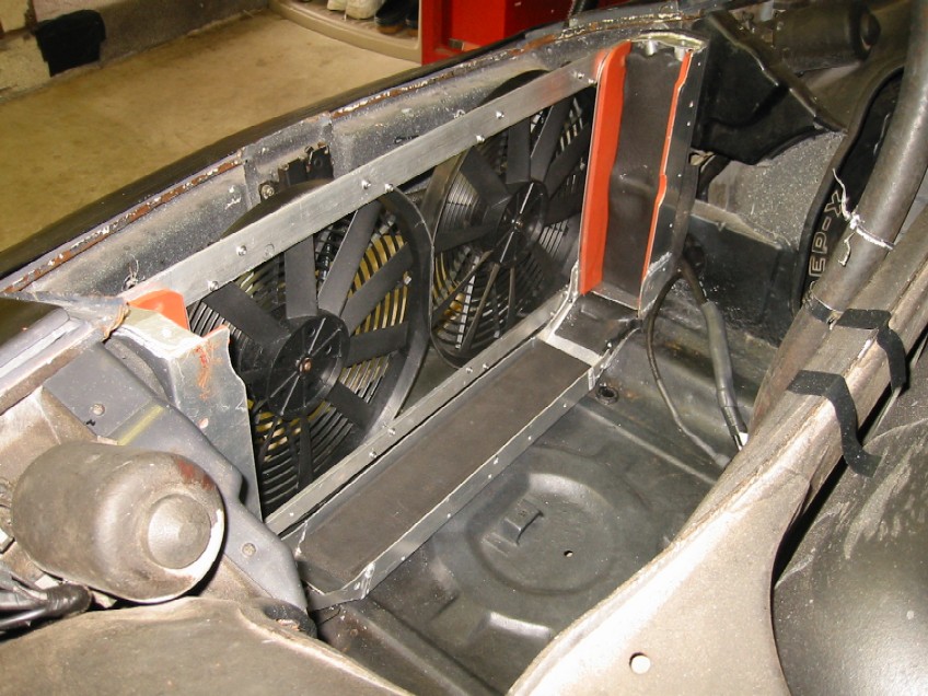

Lot's of opinions on this. For my 2 cents, I'm just finishing up my system. I used marine exhaust hose, with wire, under the car. It's expensive, but, it's got a nice lining, bends without flatening and I don't think anything ever hitting under the car would cut through it. I ran one piece all the way for both of them - no joints anywhere. On entering the front compartment I have the hoses passing through copper sweat fittings to hold them at 90 degrees against the gas tank bulkhead. Using a Griffin radiator it even cools fine (190) with only one of the 2 pusher fans running. I'll post some pictures tomorrow.

Found some pics of the hoses. This is prior to installing the inlet shrouding & cover plate..........

My mistake - old pic - try this one............

and this.................

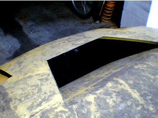

and this...........

Tyler, is that a hole in the front of the car to allow airflow? I was wondering if that could/should be done.
What do other people think about cutting there? It looks like an important support place for the car, but I could be wrong if people are cutting it away.
tyler
post Oct 7 2005, 07:56 AM
Posts: 335
Joined: 24-September 03
From: southern california
Member No.: 1,192
Yes, that's the air inlet which now has ducting to the fans, an air scoop and a protective screen. I really wanted to have an inlet in the middle of the bumper, where the license plate goes so the air would go straight in but that's not an easy cut. As it turns out, cooling works fine the way it is.
