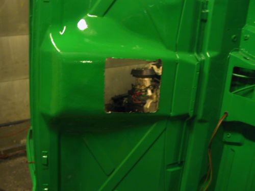

Then I drilled a 7/8 th inch hole in each corner, using a bi-metal hole saw.
michel richard
post Nov 5 2005, 07:09 PM
Posts: 1,291
Joined: 22-July 03
From: Longueuil, Québec
Member No.: 936
I then cut out the hole, using a 4 inch cutoff blade on a small 4 inch (D'oh!) grinder, to make this rough hole:

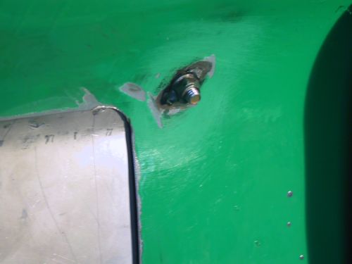

On the engine side, I spot-welded some 6 mm fender nuts:
michel richard
post Nov 5 2005, 07:12 PM
Posts: 1,291
Joined: 22-July 03
Member No.: 936
And I made the closing piece of thick gauge stainless steel. It may be that there is an advantage to using stainless, because it does not conduct heat as much as other steels, but I just used that because it's what I had.
Total time, probably about an hour. It helps massively that the engine was out, and the tub on a rotisserie.
