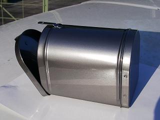

pic from powder company: (I haven't tried it yet)

Bondo what site was that pic from??
Cant seem to find anything.
bondo
post Nov 10 2005, 03:51 PM
Posts: 4,277
Joined: 19-April 03
From: Los Osos, CA
Member No.: 587
QUOTE (Andyrew @ Nov 10 2005, 02:26 PM)
Columbia Coatings
