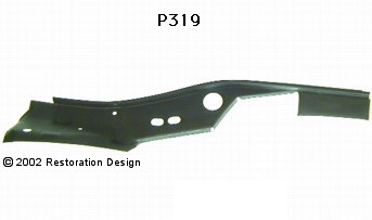

Bleyseng
post Nov 11 2005, 11:50 AM
Aircooled Baby!
Posts: 13,037
Joined: 27-December 02
Member No.: 24
the drain hole is on the left in this pic

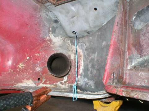

watsonrx13
post Nov 11 2005, 12:13 PM
Posts: 2,735
Joined: 18-February 03
From: Plant City, FL
Member No.: 312
Here's a shot of the drain hole from underneath the engine shelf. This is how I held the bottom section of the engine shelf down while I welded it into place. If you have the engine out, I would recommend drilling from the bottom up.

Eric_Shea
post Nov 11 2005, 05:23 PM
PMB Performance
Posts: 19,304
Joined: 3-September 03
From: Salt Lake City, UT
Member No.: 1,110
Make sure you drill it from underneath or right where Rob is showing... you don't want to drill straight down from the top as it will simply drain into the long.
