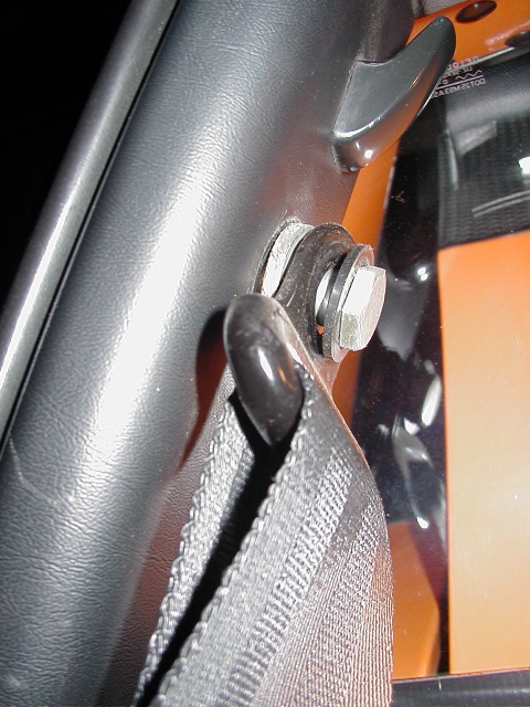

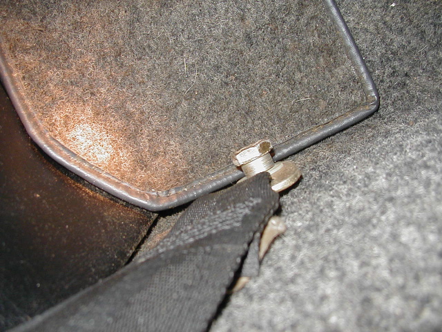

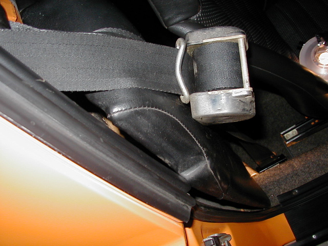

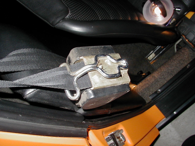

Okay, here we go: I ordered two 3-Point Retractable, Black seatbelts $159.90 (Part #WSCH324-1000-Black) and two Hardware kits #1 $0.00 (Part # FHD-1046-1) from www.gotbelts.com. Total with ground shipping ws $169.72.
My goal was to use the new belts and reels using the original hardware. Doing so required cutting the belt to proper length, looping the old hardware onto the new belt, then sewing back up using hardcore thick thread. The retraction units are the same size as the originals and fit nicely behind the backpad. I took the following pictures to keep track of how all the parts fit together. (IMG:http://www.914world.com/bbs2/html/emoticons/biggrin.gif)

Old Reel

Backside of old reel.

Upper anchor, old belt.

Lower Anchor...

New Reels with old hardware...
