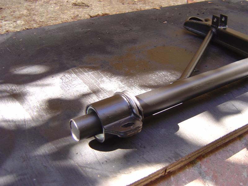

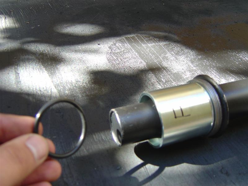

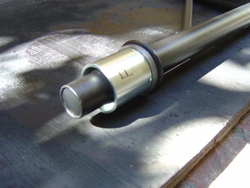

So here is the test fit in pictures.
Leo Imperial
post Nov 17 2005, 01:52 PM
Do you have to use so many cuss words?
Posts: 906
Joined: 29-November 04
From: 914 Roadshow - Glen Cove NY
Member No.: 3,192
Perfect fit!

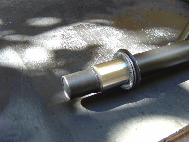

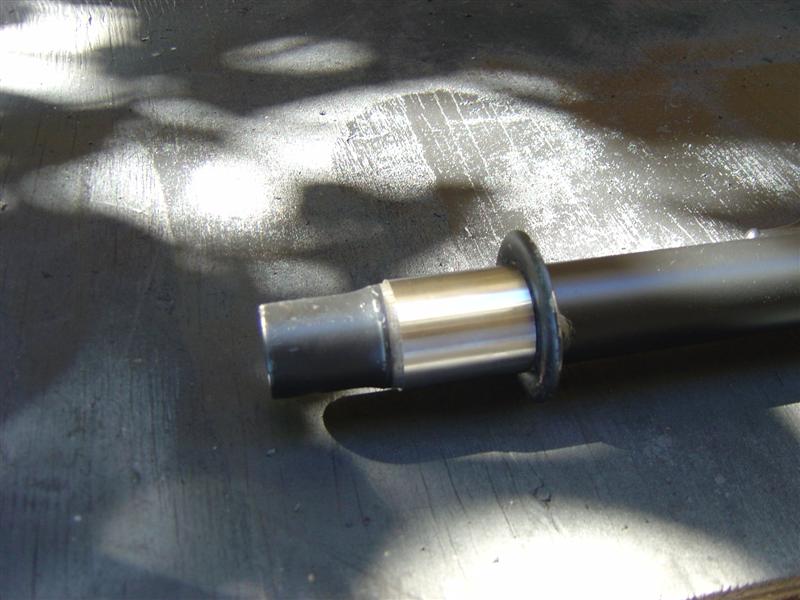

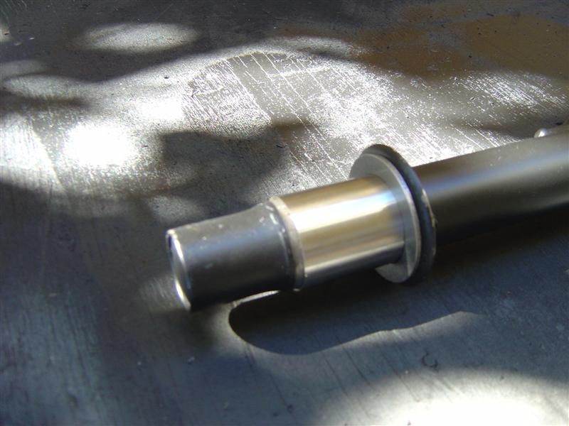

I mean this is a perfect fit.

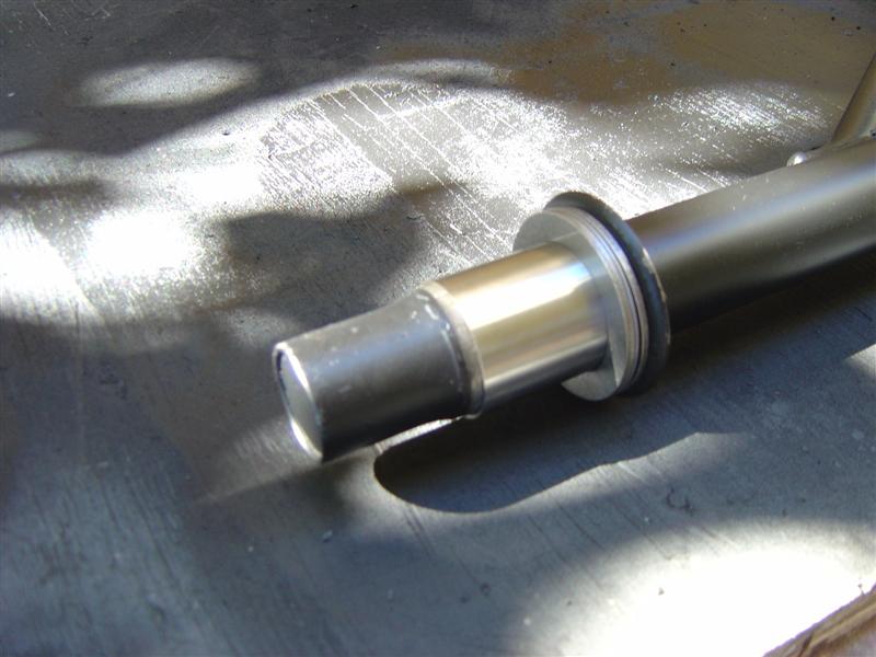

Washer

Roller

Washer

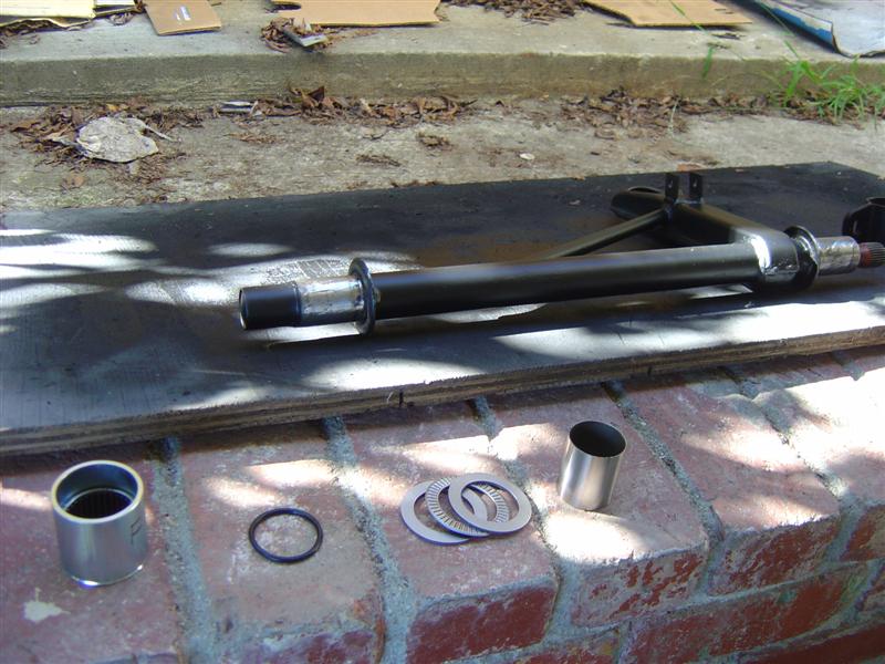

The bearing

O-ring

And the front mount.

Now to grease it all and do the actuall install.
Any advise from the peanut gallery. Mike is this looking like the correct approach?
BTW - everything fits perfect. No forcing and no play.

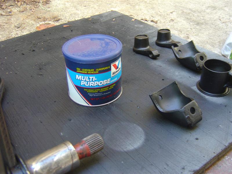

Is this the type of grease you would use or should I get something else?

I'm just a casual observer of the various bearing threads from the past, but I thought Mike or another bearing user had recommended marine grade grease (boat trailer wheel bearings) for water resistance. (IMG:http://www.914world.com/bbs2/html/emoticons/idea.gif)

That was what I had read also.
This stuff makes the same claims as the others on the shelf (water proof).
The other option is synthetic, but is that really neccessary?

QUOTE (maf914 @ Nov 17 2005, 01:19 PM)
that looks like standard wheel bearing grease which should be fine, I've never run into a wheel bearing grease that is water soluable (IMG:http://www.914world.com/bbs2/html/emoticons/smile.gif)
the main difference with marine grade grease is the protection from thermal shock when backing your trailer into the water after a long drive...(read it someplace, how true, no real idea)

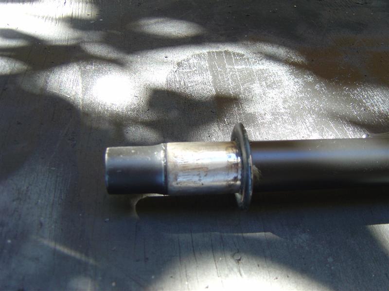

Does the sleeve that the large bearing runs on have to be epoxyed to the arm to keep it from walking or spinning?
-Ben M.

(IMG:http://www.914world.com/bbs2/html/emoticons/agree.gif) Part of the marine grade grease recommendation was that it's much "stickier" than other greases and seems like it would stay in place longer.

QUOTE (airsix @ Nov 17 2005, 01:39 PM)
-Ben M.
good question.... (IMG:http://www.914world.com/bbs2/html/emoticons/idea.gif)
