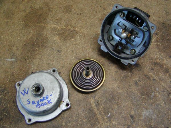

Be careful of what MPSs you might find...they are not all good to harvest parts from. One of our own sent me this one which does not have a diaphragm or even a place for a diaphragm!

The rear coil section seems to be similar enough to our MPSs, but thats where the similarities end. The aneroid cell has a fixed threaded allen key adjustment whcih only gives 0.004 Inductance adjustment, not sufficient for our needs. (IMG:http://www.914world.com/bbs2/html/emoticons/dry.gif)

The '68 Type 3 was, as far as I know, the first production car to get D-Jet. They were really learning with this setup, and changed it fairly substantially each year until '71, when they seemed to get it about right. I have a '69 Squareback, and the system is similar to, but still quite different from, the 914 D-Jet. The '71 Type 3 system is very like the 914 setup.

early Type 3 mps doesnt use a diaphram but had a WOT switch for adjustment. I had a 69 fastback years ago.

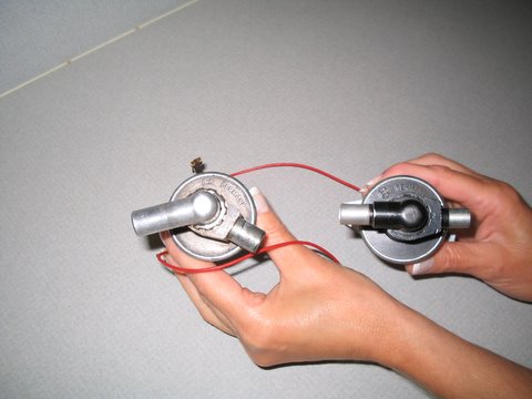

Do any of you guys know which early VW this NOS AAR is for? I bought it off of ebay a few years ago thinking it could be used for a D-Jet 914 but the hose connections are quite a bit smaller than the ones for a 914. Angled slightly different too.
Part Number 0 280 140 005 or VW Part Number 311 906 045
smg914
post Dec 5 2005, 01:25 PM
Sahara Beige Steve
Posts: 1,979
Joined: 22-February 04
From: Tampa, FL
Member No.: 1,695
Comparing the VW AAR to the 914 AAR.

QUOTE (smg914 @ Dec 5 2005, 11:25 AM)
The T3 part number should give you a clue ....................... The Cap'n

Thanks Cap'n. I think I'll just resell this part on ebay but I'll advertise it for a Type-3 VW and not for the 914 like the previous seller did.

Late Type 3 ('70-'73). The '68-'69 AAR was very different, as it used oil temp to close and wasn't electrically heated. That may, in fact, be the unit for the Type 3 automatic, which used a different AAR than the manual cars.
smg914

Thanks James. This type of detail will help me describe it when I list it on ebay.

Jeff
When I bought my car, it came with that exact same MPS. It was tweaked to run with a 2056. I never took it apart and never knew that it didn't have a diaphragm. I always had wondered why there was only the one adjustment screw in the end. Anyway, my engine ran great with it for many years until I started fiddling with other MPS's and custom tuned one for my engine. I have the inductance curve for it somewhere in my files.
Anyway, interesting that you took it apart and found that it is quite different inside from the type used on our motors.

It's a Type 3 part, so sell it to a Type 3 owner. The Samba has thousands of them, and they have the same MPS problems we do as far as availability and reliability.
