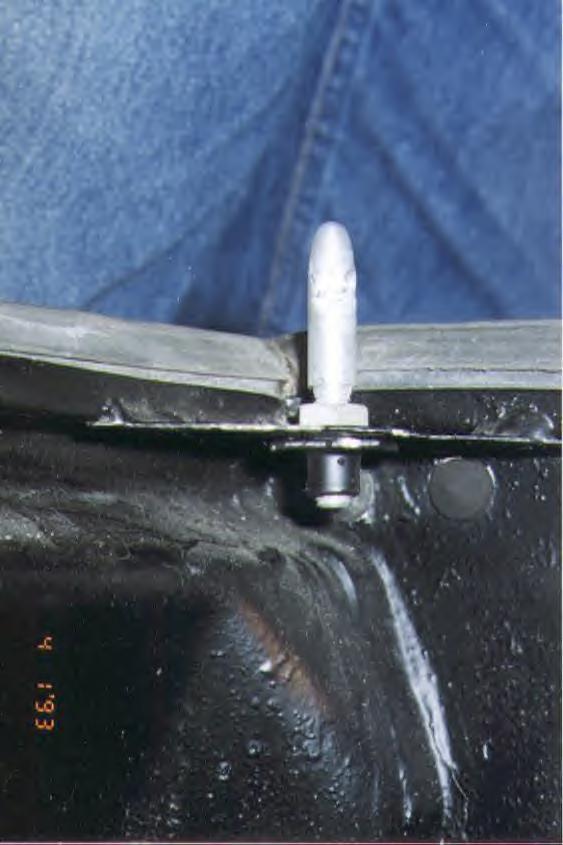

Now for the real answer.
I got pins at Pegasus. You'll probably have to fabricate the plates out of sheet aluminum. Let me know if you need some templates.
E.

Eric_Shea
post Dec 5 2005, 09:10 PM
PMB Performance
Posts: 19,304
Joined: 3-September 03
From: Salt Lake City, UT
Member No.: 1,110
You mentioned in another post that you were looking at the hood pin locations shots...
