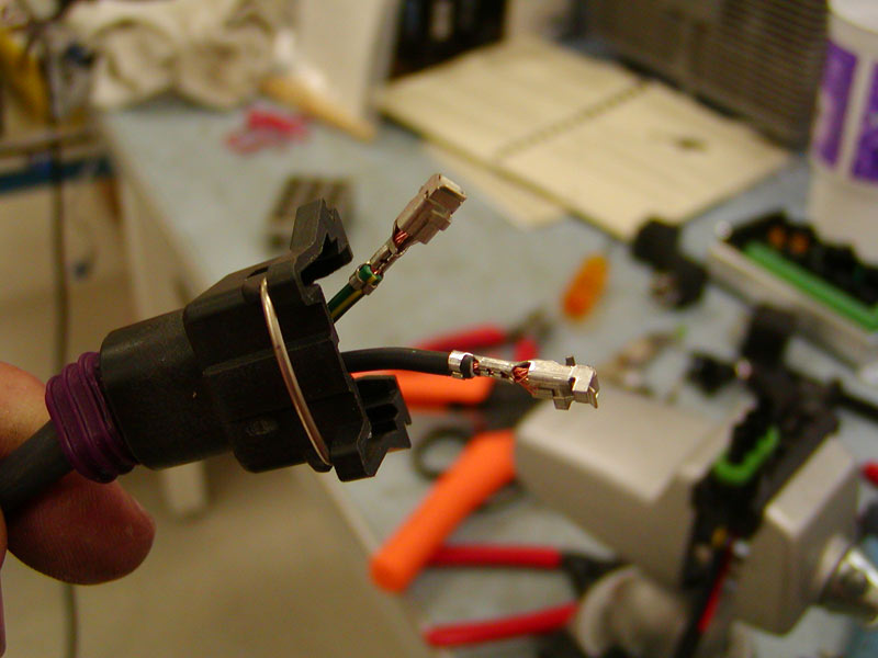

My father used to work for Hollingsworth so I have a bunch of different ratchet type crimpers (IMG:http://www.914world.com/bbs2/html/emoticons/smash.gif)
(IMG:http://www.914world.com/bbs2/uploads/post-2-1115184394.jpg)
I'd try eBay as well......

I don't use closed barrel terminals, and neither did the factory. The open barrel terminals are what most auto OEMs use, so you need to use open-barrel crimpers. Not easy to find, particularly for larger wire gauges, since most open barrel tools are made for electronics use, so 22-18g are the usual sizes seen. 14-10g are almost never seen outside the auto world.
The terminals for the excellent Weatherpak connectors are also open-barrel. Frankly, I have no idea who uses the closed barrel connectors in such quantity, nor do I understand why it's so hard to find open barrel terminals. I'm sure the suppliers exist, they sell to all of the automakers, but no doubt in million unit quantities.
Note the photo in Mueller's post. Those are exactly the type of twin open barrel crimps I like to see, complete with the extra fingers to grip the wire insulation.
