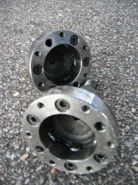

Aaron, check Slugmika's blog, bus cv adapters - I love the front swaybar!

QUOTE (Travis Neff @ Dec 30 2005, 08:54 PM)
shoulda known! very cool
(IMG:http://www.914world.com/bbs2/uploads/blog-1128671890.jpg) bus cv's he says

Yes those are bus cv's and bus axles with adapters, works really well.
