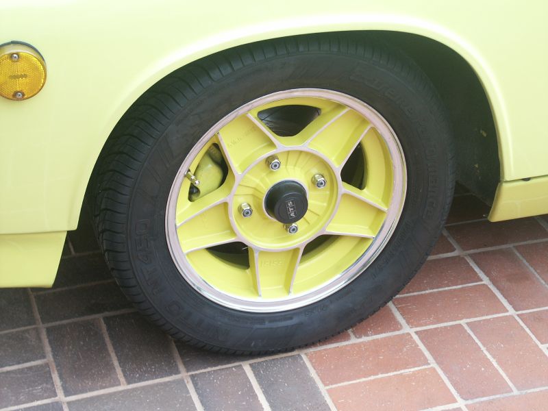

ATS made in gernany still in production look on internet under ATS wheels

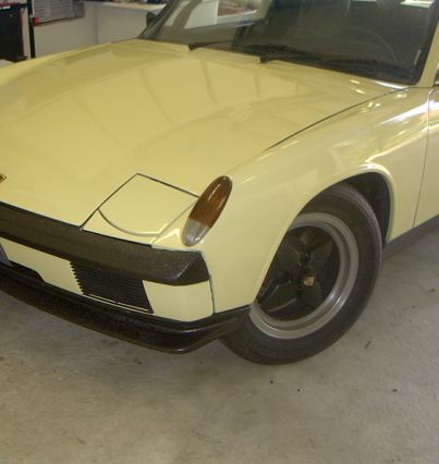

American mags. Best looking wheel to ever be fitted to a 914, IMO. The Cap'n

QUOTE (Cap'n Krusty @ Jan 19 2006, 06:18 PM)
5 lug or 4 lug?

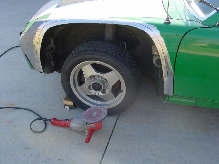

the american racing "lemans/libres" are cool looking....
the 5 lug daisy's are cool, along with the 5 lug torque thrust

I like 'em, too, if these are the ones you mean. PO gave me a set when I bought car. Use them for my street tires. But these are VW offset, so 195/65 max.
