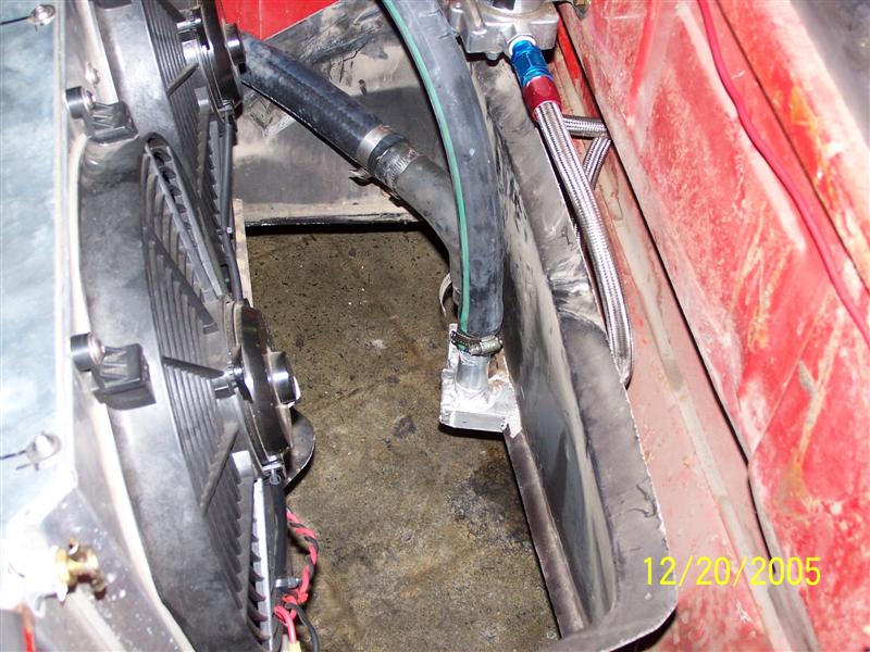

It just so happens that I have the fiberglass mount for that setup. I have not taken it out yet as I was thinking of enclosing the radiator exhaust with an aluminum duct that tied it all together. I may go with all aluminum and remove it, if so I'll offer it in the classifieds.

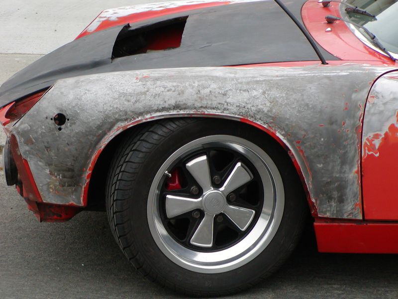

I tried using only the floor cutout for a while, the car ran a little warm. I then cut out the fenderwells, car ran cooler. I put a piece of abs over the hole in the trunk floor and the car never ran hot again. I do not have any scientific data, but that's what my experience is.
The air pressure under the car will be higher than in the wheelwells, UNLESS you have an airdam in front and around the sides of the hole in the trunk floor. Idealy the airdam should be just rearward of the radiator air inlet. I will make a diagram.

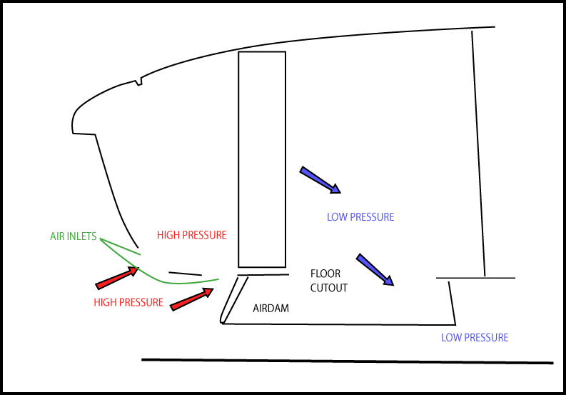

post Jan 25 2006, 11:09 AM
Posts: 845
Joined: 9-October 04
From: the motor city
Member No.: 2,912

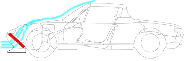

Here is a diagram, I had a setup like this too before I cut out my wheelwells, helped a little but not as well as cutting the wheelwells.
Yes, I have spent some time in a full size automotive wind tunnel so I do have some knowledge, just no hard figures.
Mark

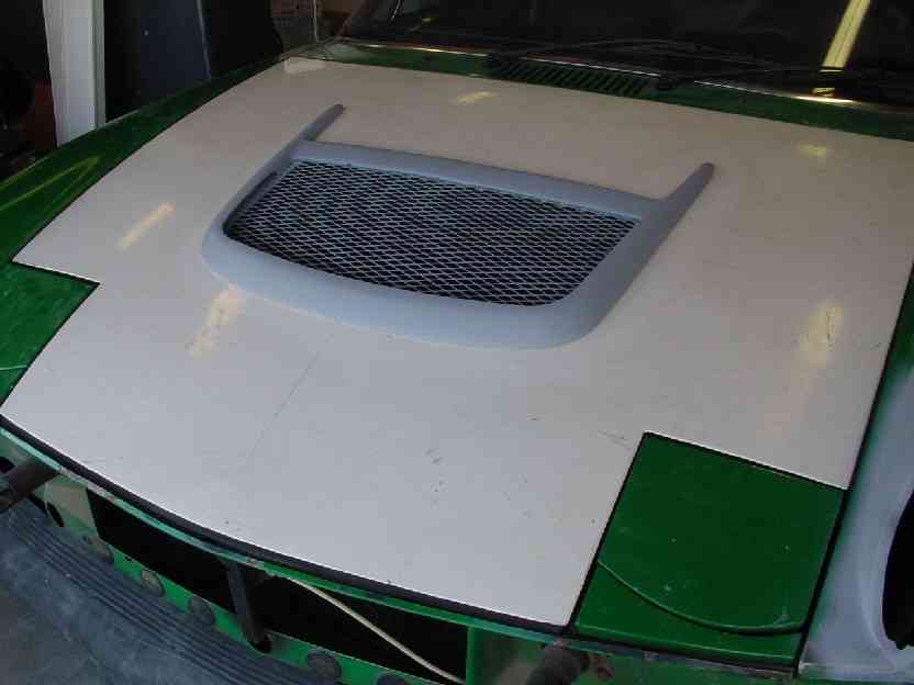

Tis what I have on mysetup..
My main problem is that
A; I dont have a 1in leading edge (its very small)
B: my hood is flat black and attracts a LOT of heat (read I burn my hand in the sun, vs another 914 had a cool hood)
c: I dont have it ducted properly.
That being said, I ran it at the wcc... Track it maxed out at 210, and I never saw it over 215. Even durring the 3 hour drive..

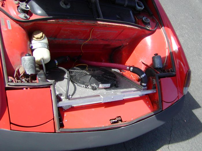

post Jan 25 2006, 12:31 PM
Spooling.... Please wait
Posts: 13,380
Joined: 20-January 03
From: Riverbank, Ca
Member No.: 172
and hood.
pics are from a long time ago...

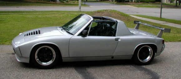

I like the idea of venting through the hood for no other reasons other than asthetics. A couple deep vents up there I think would look really agressive. Of course if it cools that would be a bonus. (IMG:http://www.914world.com/bbs2/html/emoticons/dry.gif)
inspriration......
mrdezyne
post Jan 25 2006, 02:40 PM
Now on larger rolling jack stands!
Posts: 468
Joined: 31-July 05
From: Tulsa, OK
Member No.: 4,510
and one really nice little teener...... Who's is this BTW?
