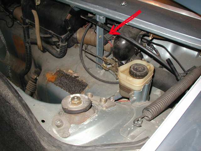

Check in the front trunk. On the driver's side cowl support (one of the posts running up and down just aft of the rear edge of the trunk opening, up near the dash) you may find a silver box with some wires running to it. That would be the intermittent wiper relay. If it's there, then you have the intermittent system.

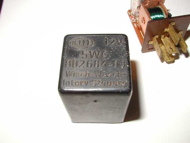

Here's the location of the stock relay. I believe the relay is $70 or more new.
Marlow

The relay.

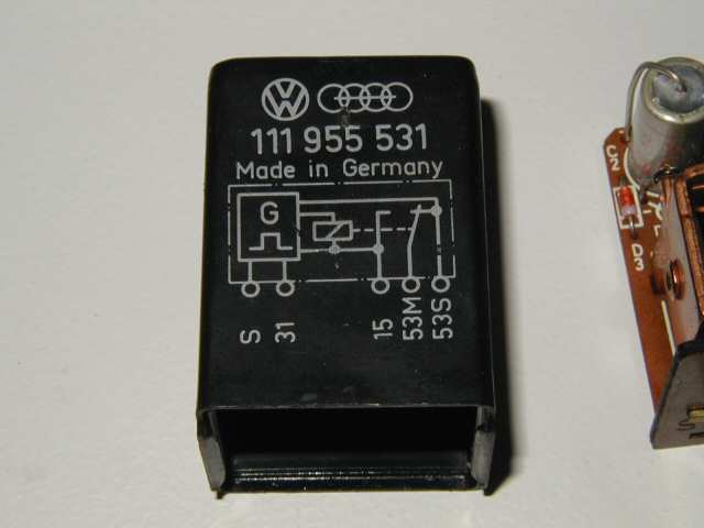

Top and guts.
