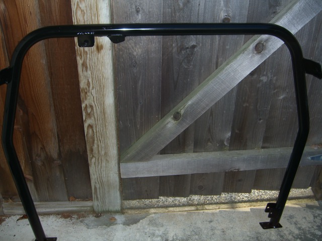

Autopower bolt-in with diagonal brace.

utter side (IMG:http://www.914world.com/bbs2/html/emoticons/ohmy.gif)

aaron there is 2 models the one I had bolted to the floor ,Trekkor 's bolts/welds to the top of the long
Trekkor outside daytime full shots of your new paint (IMG:http://www.914world.com/bbs2/html/emoticons/boldblue.gif)

Trekkor,
Is that rollbar legal by any sanctioning body or is a full roll cage needed?
I like the looks of the bar but don't want a full roll cage for occasional street use.
Where can I get an Autopower roll bar?
Thanks,
Eddie
Trekkor
post Jan 30 2006, 03:12 PM
I do things...
Posts: 7,809
Joined: 2-December 03
From: Napa, Ca
Member No.: 1,413
Honestly, I don't know (IMG:http://www.914world.com/bbs2/html/emoticons/biggrin.gif)
I have it in there for added safety for the limited number of DE's I participate in.
I think SCCA, NASA , etc require the full cage.
I'm toying with the idea of welding additional tubing to convert it to a true cage.
Like the fire extinguisher?
KT

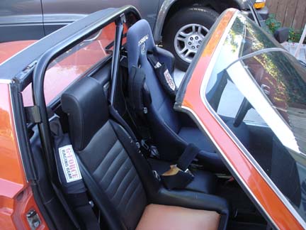

Aaron;
Here's a boly in Autopower bar with the removable cross brace installed in my car. Read the rule book carefully. If you will be running PCA in SoCal there are some changes for 2006 and they have added the phrase "roll bars must be braced" (p21, section XIV paragraph D) I asked our safety tech (and one of the guys who writes the rules for zone 8 among others) what that means and he says that for it to be a legal bar it must be tied to the floor in 4 places. A petty bar won't even do the trick. Basically, the bar needs to be triangulated to a point forward of the seat on both sides of the car. Of course, I installed my bar before learning of the rule change. Looks like I will need to do some welding!
