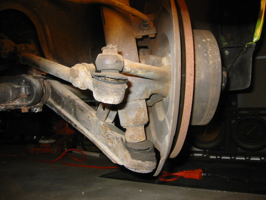

Hey all,
After finally getting back to the states I had a chance to start going through my To Do list for the teener. Well that list just got allot longer (IMG:http://www.914world.com/bbs2/html/emoticons/headbang.gif)
THe whole front end is shot and will need a bunch of work.
Anyone willing to discuss options? Replace what's there or swap out the front end? Also any tips on dropping the front end? I figure that it's easier to work on the suspension when it's out from under the car.
So 2 ball joints 2 tierod ends and struts at a minimum.
Yikes

Last pic. SOrry for the size the rest of the pics are in my Blog.
Passenger side

I see a problem in your future (IMG:http://www.914world.com/bbs2/html/emoticons/sad.gif) One of your struts is late model and one is early. This will make ordering ball joints more interesting as you will need one of each. I think I have a good old one that was installed, but not used. If I were you I would change the other strut over to a late model one with the swedge pin. They are much nicer in the long run. I'll bet you could pick up the strut for nothing from one of the members. I have seen this problem often.
Oh ya, soak your nuts and bolts now, and often. It will make life much easier in the future. I like to use penetrating oil, but anything should work that is designed to loosen rusty fasteners.

I see a problem in your future  One of your struts is late model and one is early.
Looks like two early's to me. Maybe you're looking at a front vs. a back shot. (IMG:http://www.914world.com/bbs2/html/emoticons/confused24.gif)

Picture one shows the head of a bolt and more metal where the strut attaches to the ball joint (early style), not a nut. Picture two shows no head of a bolt, at the same index, but you can make out the recessed wedge pin from a later style. I don't believe that the rotors and other gear need to be replaced as the bottom ball joint coupling part was all that was differnt on mine when I swapped them. The spindle was the same.
(IMG:http://www.914world.com/bbs2/html/emoticons/blink.gif) To me, pic #2 just shows the end of that bolt you see in pic one, that's what I meant by backside...
Hell I don't know. I'm looking at it on my laptop. Let me check with a better monitor.

If pic two were just showing the otehr side of the bolt you see in pic 1, how would you tighten said bolt? With t a nut? Not present (IMG:http://www.914world.com/bbs2/html/emoticons/wink.gif) Also, if they were of the same side, then you would have one side with two steering arms on it (IMG:http://www.914world.com/bbs2/html/emoticons/ohmy.gif) Freaky.

If pic two were just showing the otehr side of the bolt you see in pic 1, how would you tighten said bolt? With t a nut? Not present  Also, if they were of the same side, then you would have one side with two steering arms on it  Freaky.
Ya gotz me all wrong Sister...
I'm a little dense but what I was 'attempting' to say is; The head of the bolt in pic #2 is on the other side of the strut (hence, ya can't see it... you only see the end of the bolt), not that pic #2 is the backside of pic #1 (IMG:http://www.914world.com/bbs2/html/emoticons/blink.gif) (IMG:http://www.914world.com/bbs2/html/emoticons/huh.gif) (IMG:http://www.914world.com/bbs2/html/emoticons/wacko.gif) (IMG:http://www.914world.com/bbs2/html/emoticons/unsure.gif)
