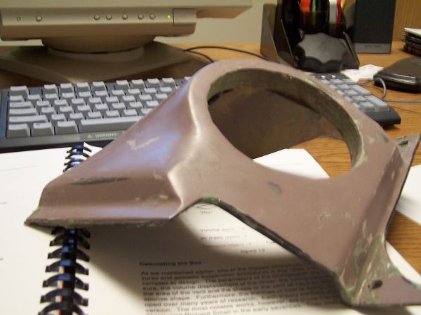

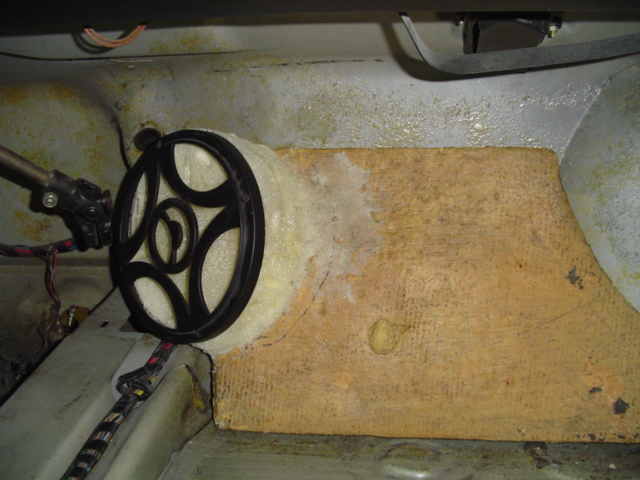

I spent the day starting to glass a stealth box that will fit under the passenger footwell/footrest. I was originally just going to make one, but I figured I would gage interest to see if others would be interested. I figure it would cost 65-75 dollars plus shipping. I am just gageing interest but let me know if this is something you would like. The box will fit an 8in woofer which you would need to acquire. This should sound a lot better than just cutting out the foam, as this will be sealed and will have the proper volume for the sound to bounce. Let me know what you all think. I am just getting started but should have mine completed in a couple of weeks.
The picture is the back side that is molded to fit into the firewall. I don't plan on moving the front (palce where your feet rest) out much if any depending on what woofer and can get and how deep it actually is. Overall, you should not loose much leg room if any and you will never be able to tell where the sound is coming from

update:
I pulled the mold tonight after doing a second coat. I calculated the volume which came out to .26 Cubic feet (volume calculation page) . I figured it would be around there. So it looks like a 8in woofer would work fine in the sealed enclosure. A ten needs at least .5 cubic feet to work properly. It is possible that it would sound worse. It is not all about size but how you move the air and how the sound bounces. Any one of these speakers should work, but the Rockford Fosgates shoud be the best due to volume issues. Woofer -crutchfield.

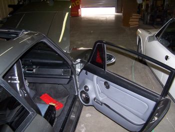

Member No.: 2,771

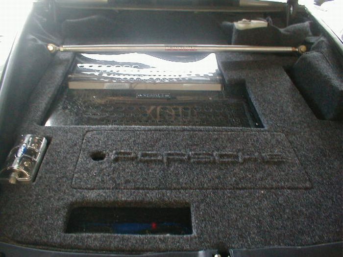

Looks real good... that is exactly how we did it!
check it out...
WRX914

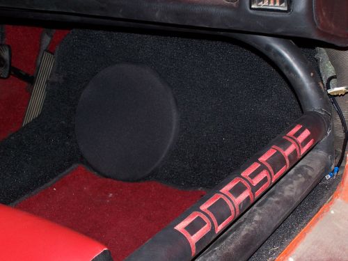

Jeffs9146
post Feb 7 2006, 05:57 PM
Ski Bum
Posts: 4,062
Joined: 10-January 03
From: Discovery Bay, Ca
Member No.: 128
I built this one and it calulates out to .27QF. It sounds great!

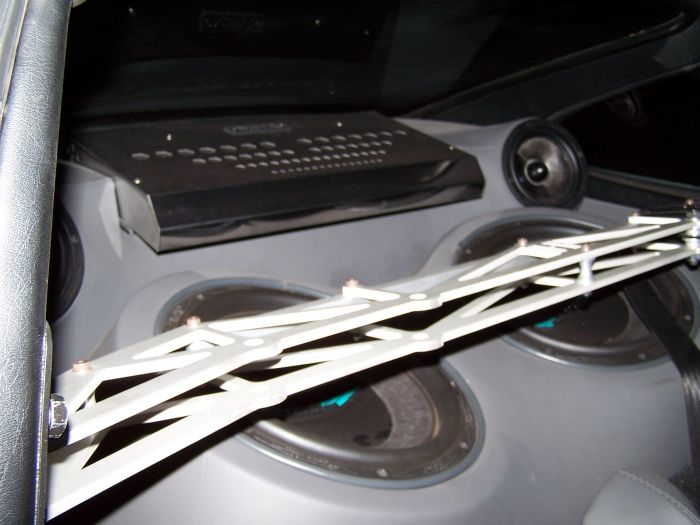

Member No.: 2,771
And now for some serious 911 bass...
WRX914
post Feb 7 2006, 06:00 PM
2.5 WRX STI hybrid powered beast
Posts: 782
Joined: 16-September 04
From: Las Vegas, NV
Member No.: 2,771
Can you say POWER?
