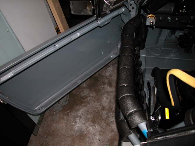

We are at 1900 pounds now with full 8pt cage, steel body and bumpers. I guess the lexan saved us around 40 pounds. Gutting the drivers' door saved alot also, maybe another 25. david Attached image(s)
