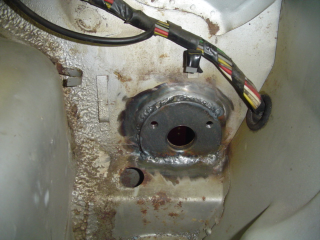

Decided to tackle my sway bars this weekned. The front is a Tarret and the rear is a stocker. I did the front setup today. Started by drilling the tub. 1 1/8" holes for the Tarret bar and the three mounting holes. Then made some backing/nut plates out of some flat stock (1/4" plate) I had laying around.
Here's the backing/nut plate next the Tarret bushing block:

Welded the backing plates into the tub.......

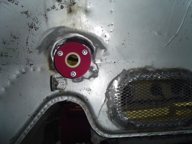

other side

Bushing mounted

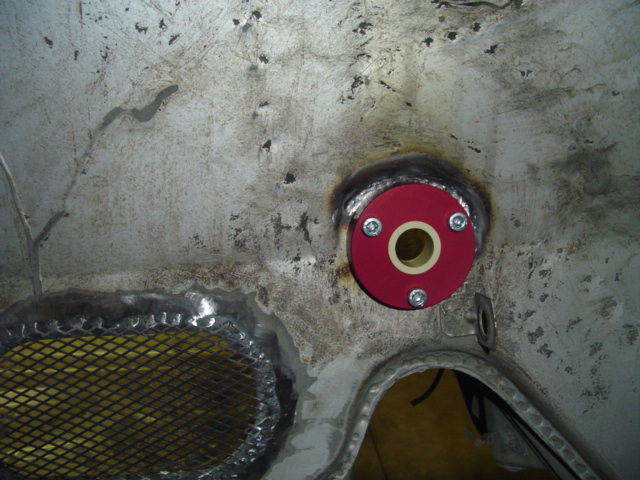

other

Anodized parts are cool !!!

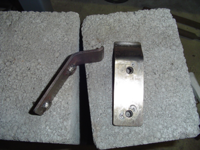

OK..........got around to doing the rear bar mounts today. Started by making the brackets that get welded underneath and some re-enforcing plates for the top side (inside trunk).
Here's the nut plates/brackets I made:

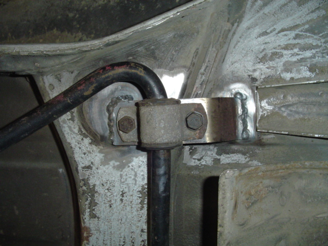

Welded the brackets in.......
