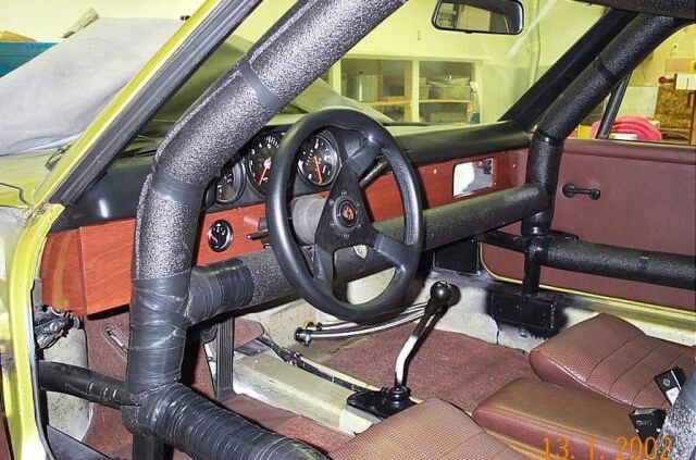

bla,bla
Not a great pic.
There's a plastic oval shaped knockout in the long behind that gear shift knob....or was.

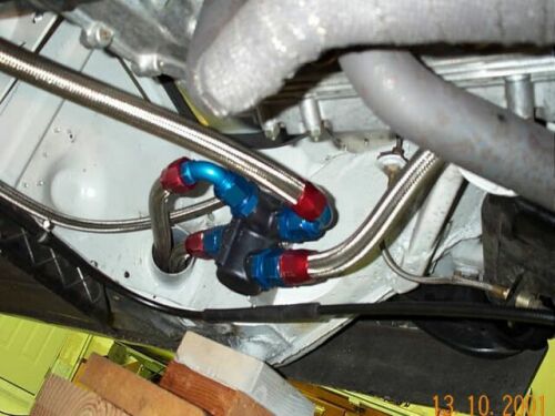

bla,bla
reruns

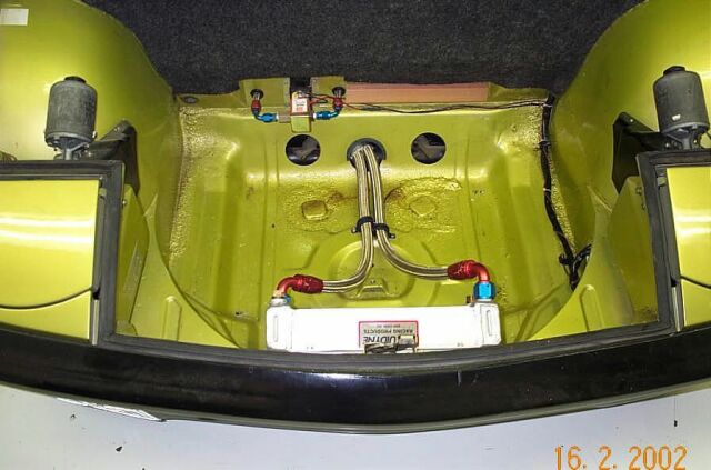

I would put a short piece of radiator hose or some other grommet where the lines come through the hole. That is very cool though, am contemplating oil cooler locations now, how well does that work, can the air get out the back of the trunk adequately through those holes, or is hood louverd or ducted?
That's it.
I've never seen over 100C (212F) on the gauge and it ain't from lack of trying. 150 minutes of DE....the trans got HOT, but not the motor.....2 driver AX in 90 deg weather.....I was prepared to knock some more holes, but.....
Grommets in all holes but those by the thermo.
